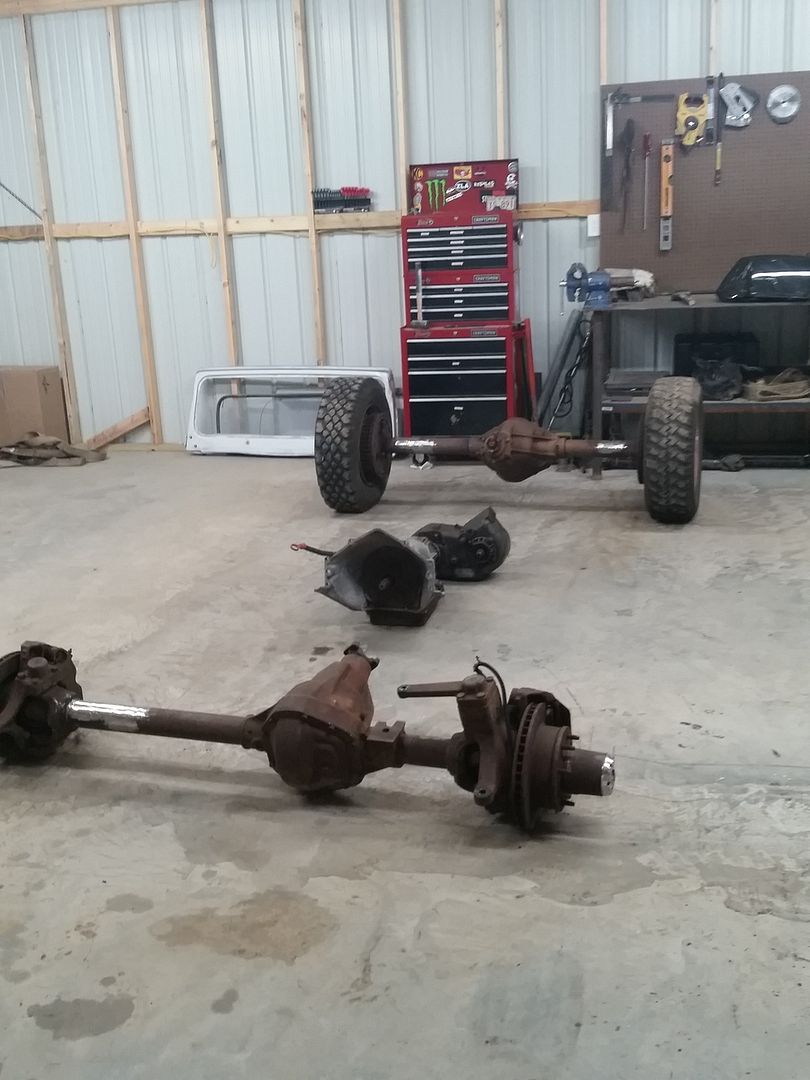

5.3 vortec, free did some dirt work for a guy
Th400
Ford np205
14bolt rear
Hp60 front 5:13s
