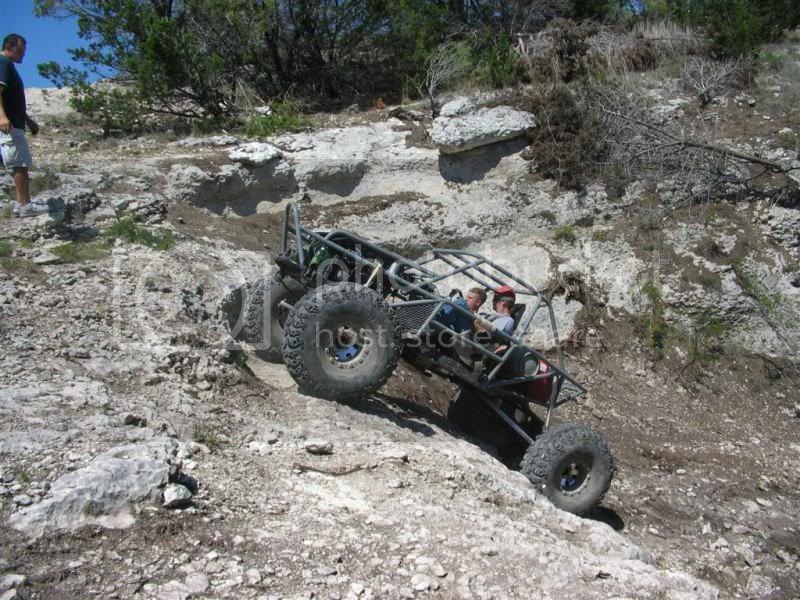

Figured I throw my build on here as well. I rebuilt it about 2 years ago and am now able to go back and redo a lot of things that I should've done a little different. I'm in college, so money is always a big thing for me, and I can't afford to built a two seater buggy with a v-8 right now. I just ran into a little bit of money, so I'm throwing a 60 in the front, 4:1 in the 300, rebuilding bumpers, shackle reversal, and probably repainting it to match my truck. I have been blowing up my front 44 everytime out, so I needed to get a 60 in it. Here are some pictures from a couple years ago. Specs as of now are
2.5L
5 speed
d300
100" wheel base
coilover/4 linked rear
soa front on waggys
37 km2s
hydro assist
