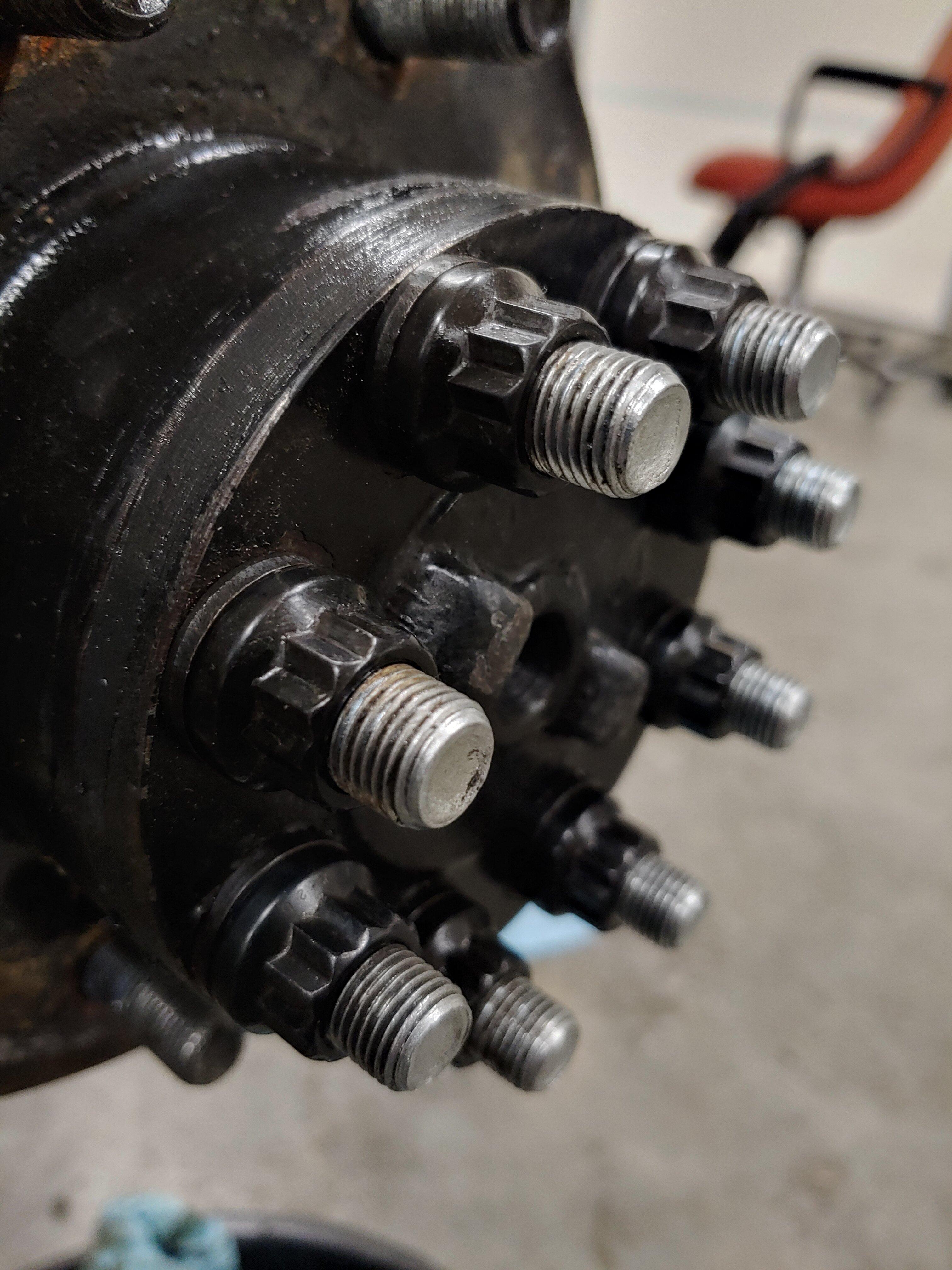

I just did this on a U4 car I built with almn hubs. Studs and norlock washers with nyloc nuts they never come loose. I think the key when using a bolt however is have a long enough shoulder on the bolt that it goes into the hub alittle so the shear load isn't on the threads but the smooth shoulder . Typically that shoulder is .005 bigger then the thread and stronger . Not all hubs will accept a bolt like that though . Making these studs the way to go
Got me some studs, the last ride the bolts kept loose, and it slung oil everywhere.

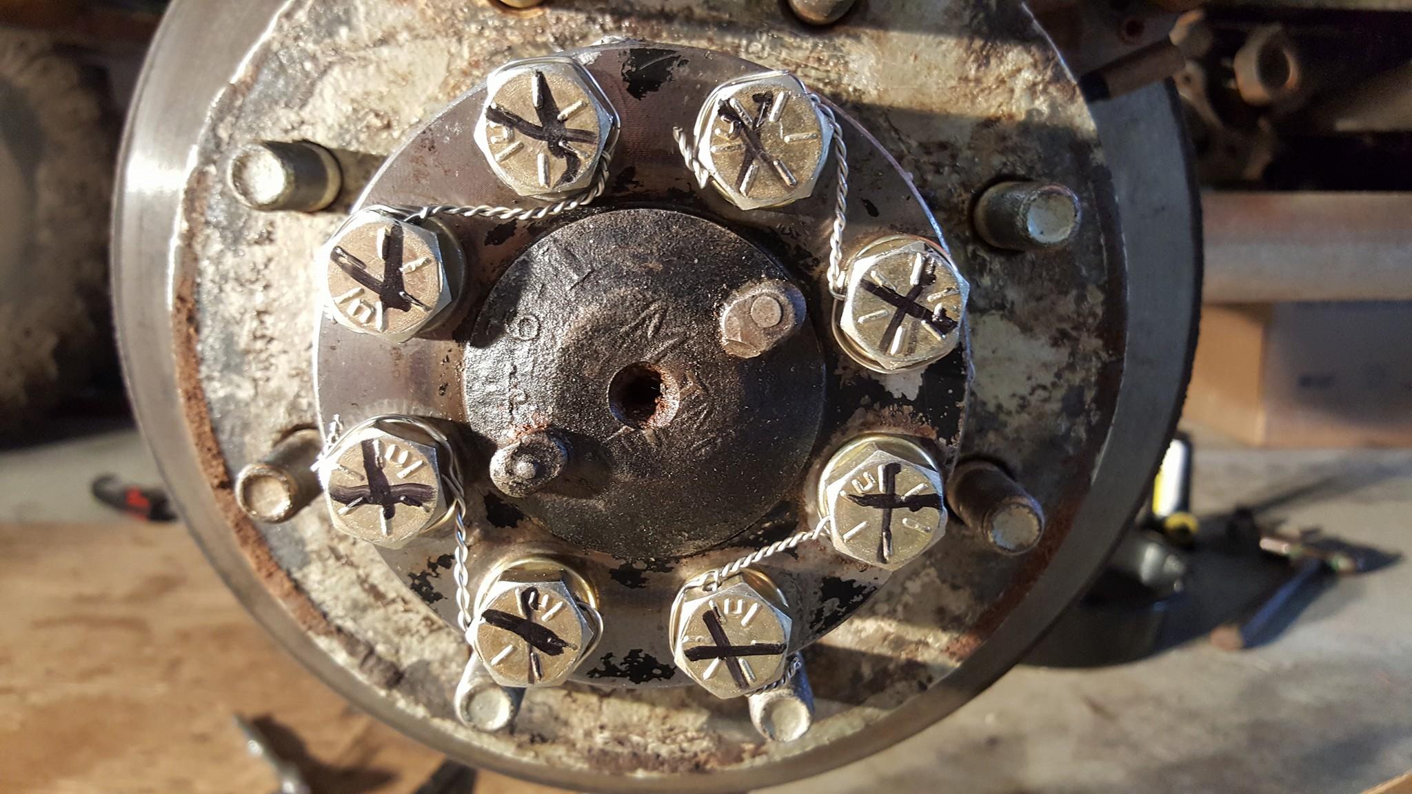

I tried studs but still had problems. Switched back to grade 8 bolts with safety wire and didn't have any issues for 2 years. I sold the jeep, so I don't know if it still holding or not.
Nice work :dblthumb: Are you an A & P Mechanic? Looks like the way prop bolts are done.
