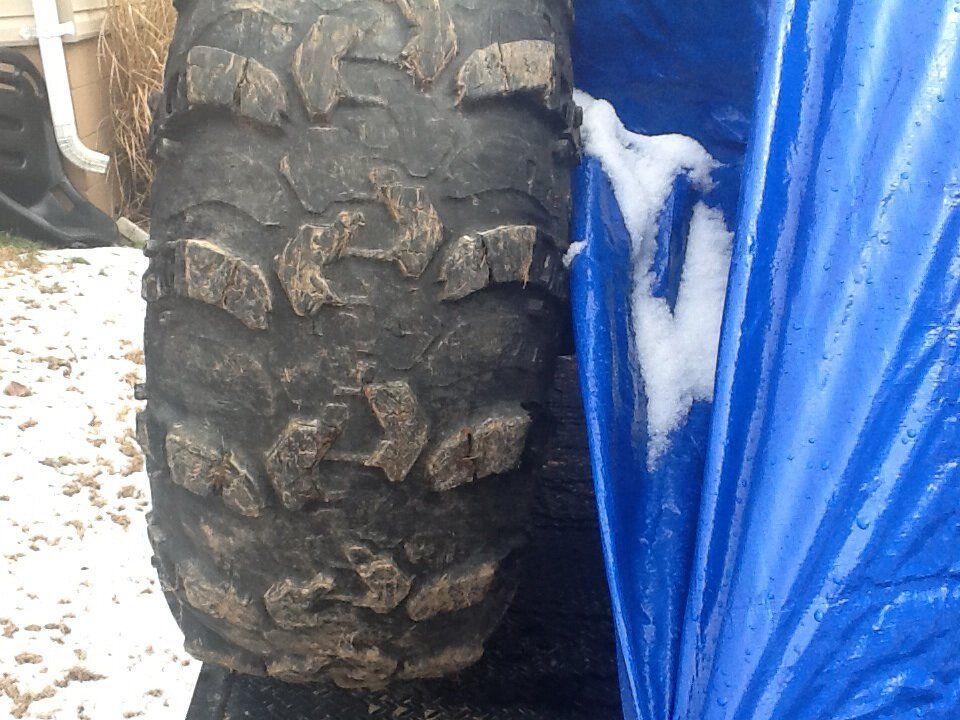

From looking at the photos of cut tires with whole lugs cut out, it appears that they do this with a hot tire groover fro all the little marks. But that could take days to do a set of 4. Cutting sipes I get, but removing whole knobs??
Is that the way they do it or do they use some other means to remove the knobs then finish it off with the groover?
I've looked for how to videos on this but only found simple grooving.

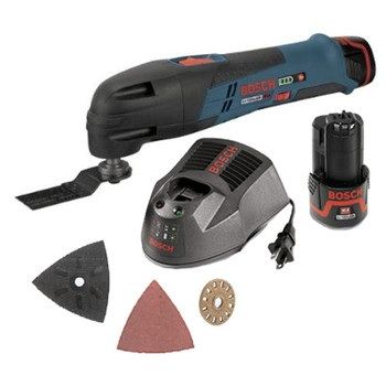

I used one of those multi tools with the vibrating blade. Just sharpen the blade with a file and it will lob the whole lug off in seconds. It took me about 20 to 30 minutes a tire. It was the first time I've ever cut any.

A tool like this buy a little thicker straight blade and you can cut the small lugs off of all 4 boggers in a matter minutes. I'm talking 5/ 10 minutes each tire. :****:just take a hand file and sharpen the blade
