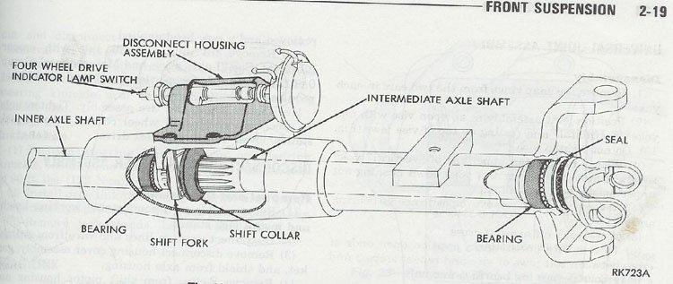

Ok explain to the stupid ones. What is an axle with CAD?
Center Axle Disconnect

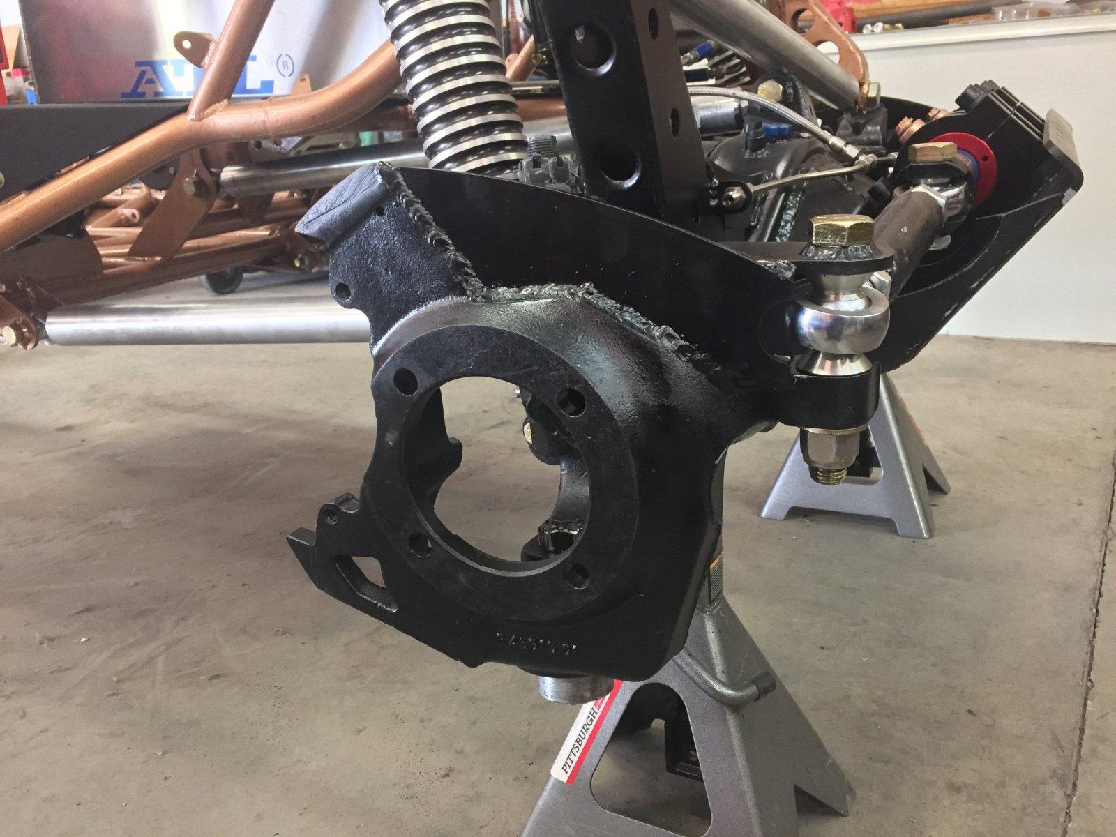

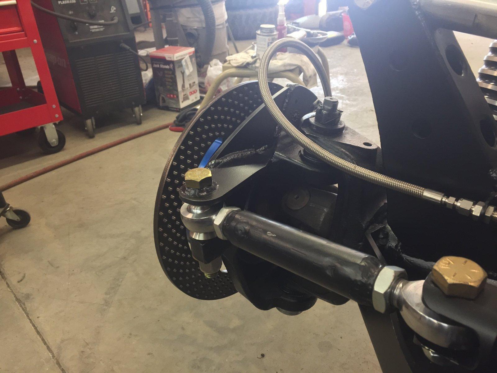

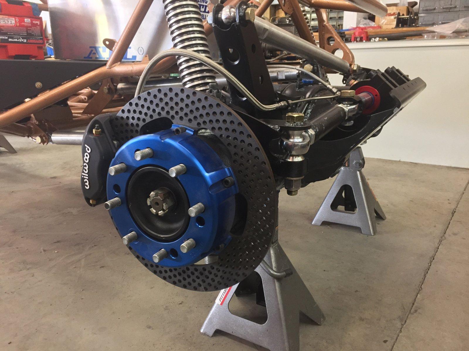

I have the Dodge UB outers on my single seat buggy, with custom 300m shafts from CTM. F66879FF-FFC8-4293-BFA1-62C933B4B682.jpeg5A884933-3B15-4C2D-9675-AEC300EE492B.jpegD46E8C91-CFF2-4819-8F78-B510EAA962D3.jpeg
