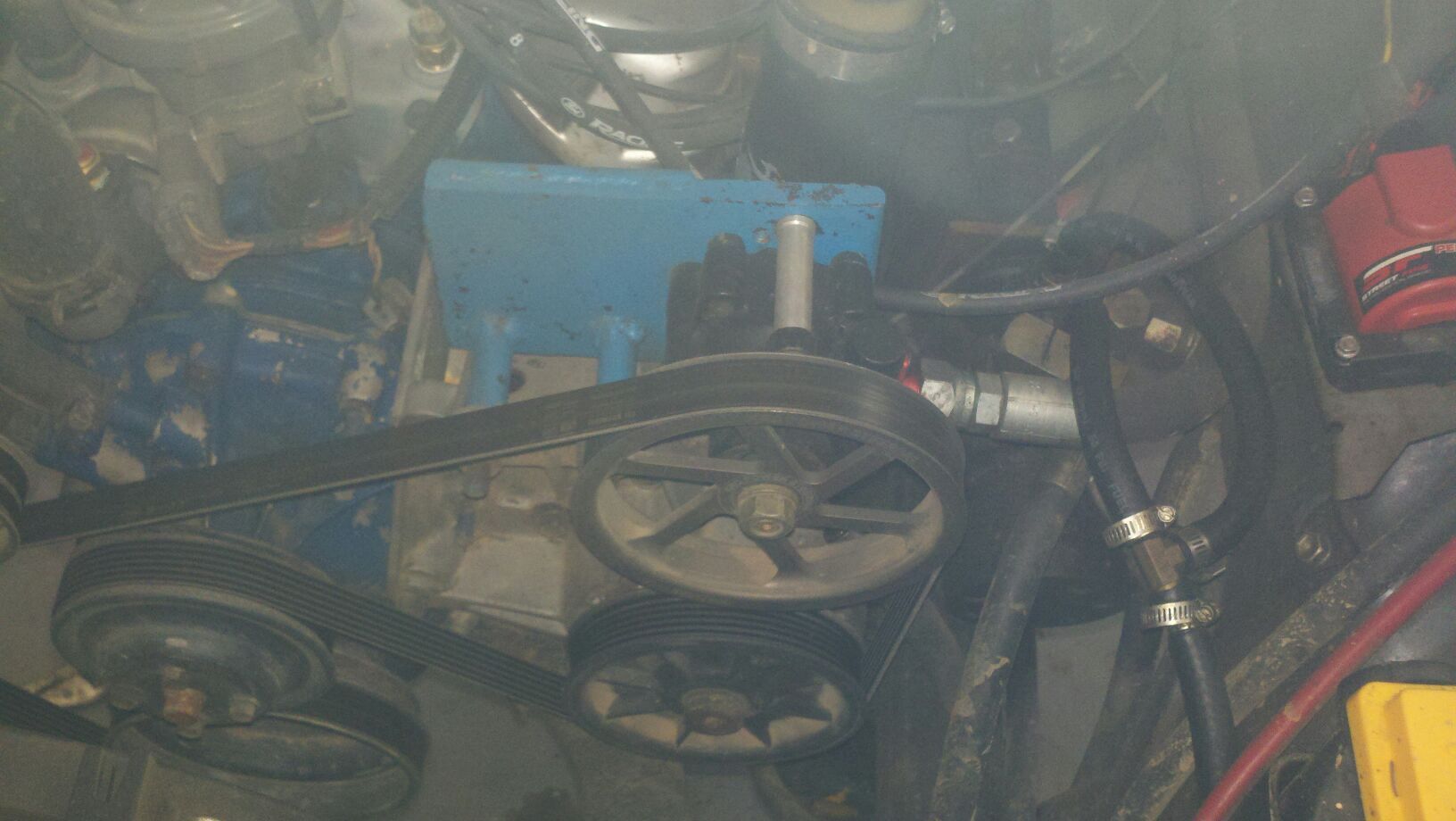

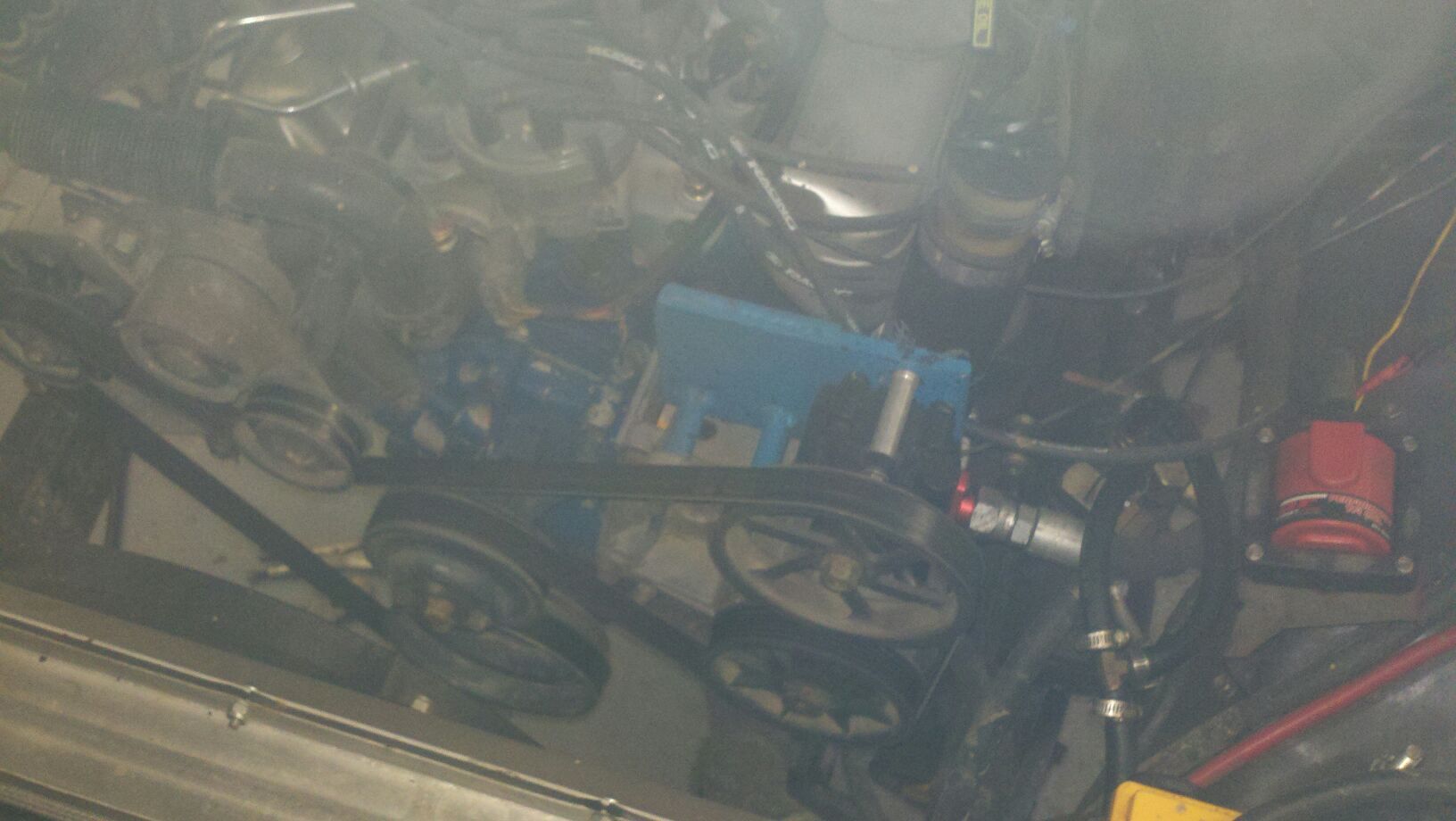

I've got two pumps on my setup 302 with all serpentine pullys got the rear on a factory pump and got a krc pump on the front works perfect. The belt I finally got to fit was a Goodyear gator back at almost a hundred bucks.

Sorry for the delay..those are 5.5 pullys, from the center of the water pump to the outer edge of the upper pump pulley it 13.5"

fordcontraption01 said:
in this pic tbitoy the big goofy neck extension is for the factory pump on the bottom but I have got a remote psc remote can I'm going to put on instead mainly because when it gets rolled over all the fluid runs out the factory cap. The front has a remote can and has never leaked out when rolled over. The pics suck I know I got this new iPhone and can't seem to get the pics uploaded like I did on my droid x.

Re: Re: Re: Dual steering pumps
Thanks
I'm going to use a P pump with remote res in the stock location, then mount a TC pump like yours on top.

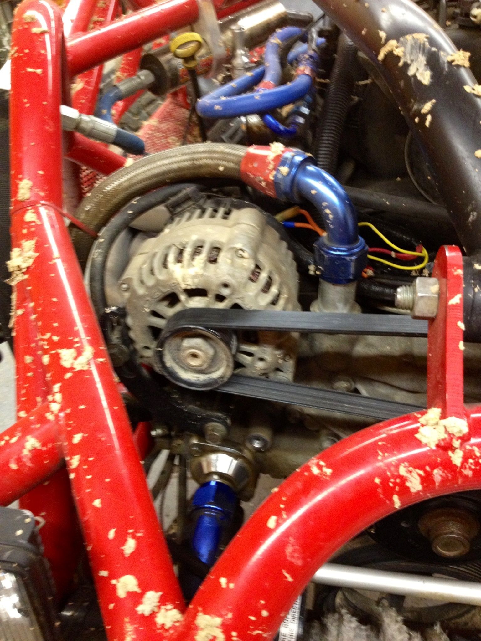

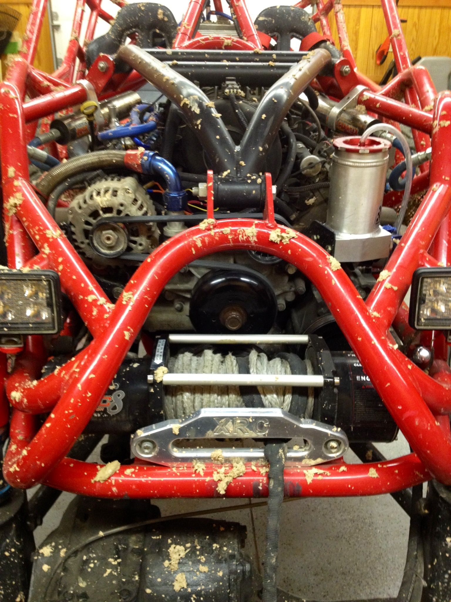

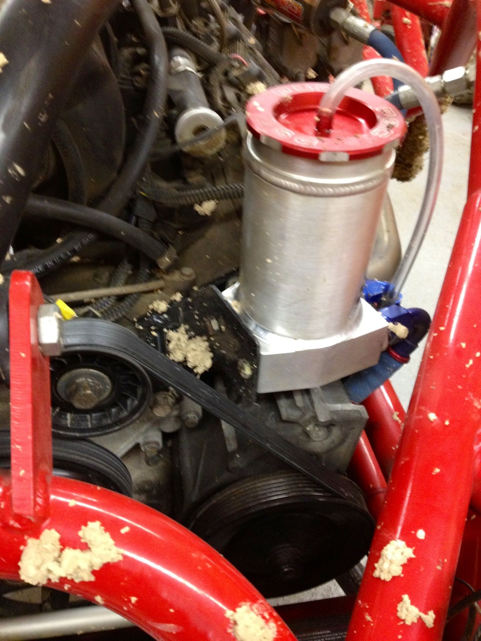

Little update after mearsureing everything out no way in hell was two pumps fitting so I moved my resivor right above pump helped a bunch here's what I came up with
