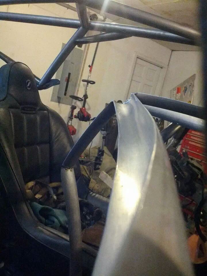

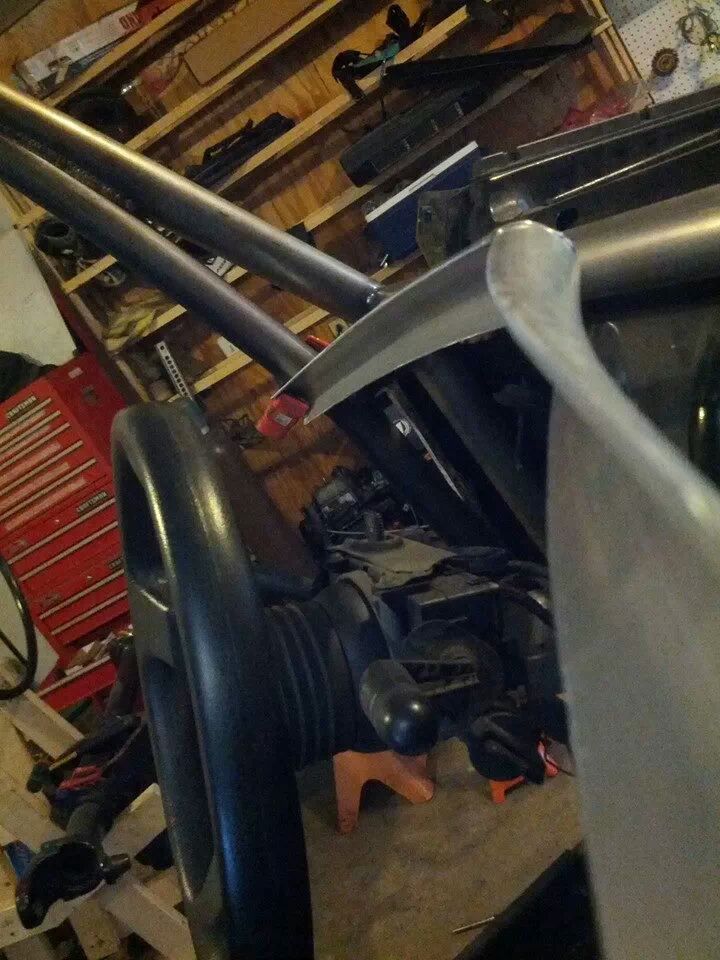

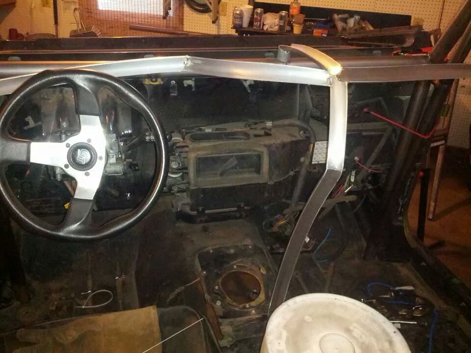

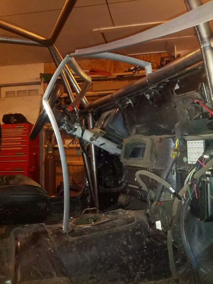

Skeleton for aluminum dash
Yeah I figured that, just odd looking and seems like one bad bounce and the dash will get punched hard.

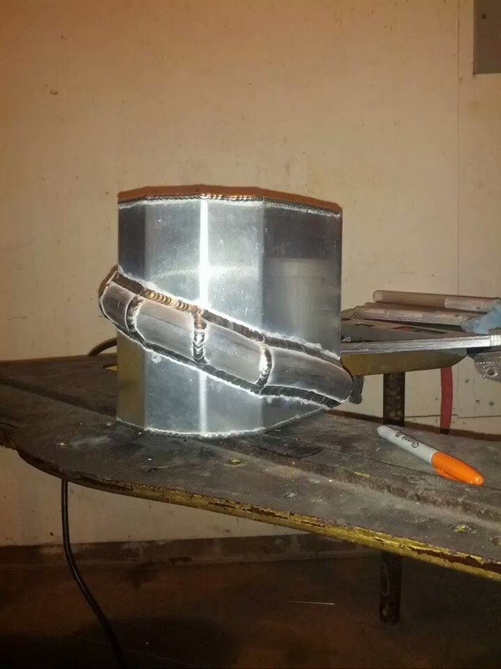

I'll guess its a cooler that will have a 3-D snake painted onto it after he spends hours tig welding it so it looks like real scales. :flipoff1:
