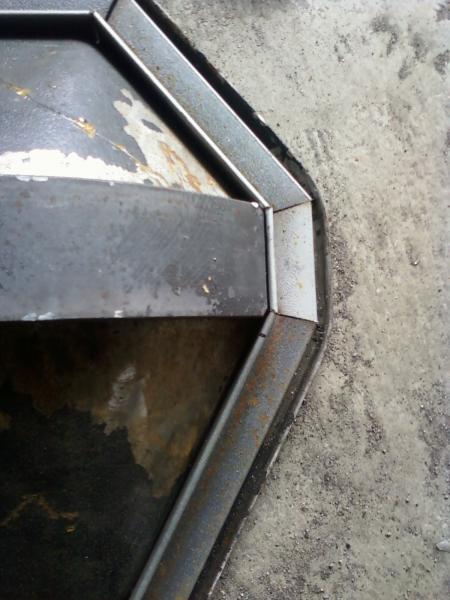

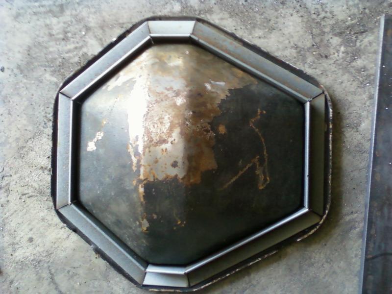

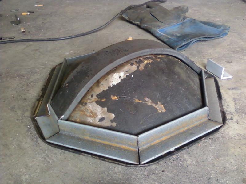

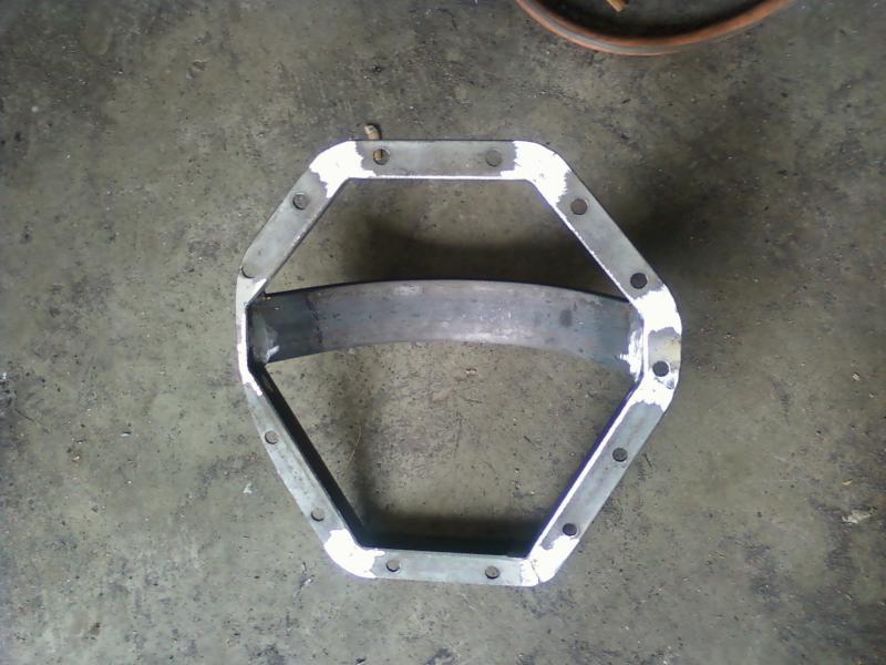

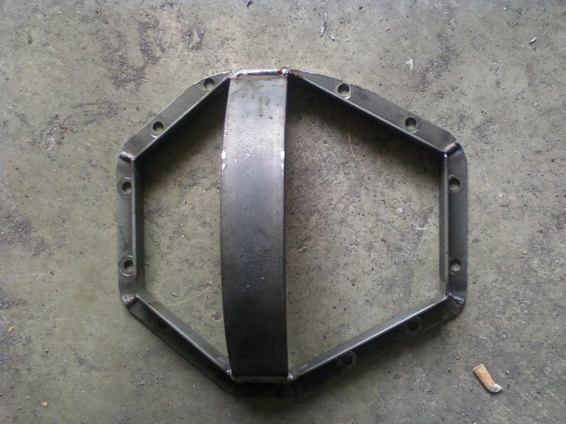

Had 1-14 bolt, and 2 covers, sooooo out comes the cut off wheel and welder, free double thick diff cover.
I shaved a lot off my 14b, it actually has more clearance than my d60...
After thinking about it for a bit, I figured this would be the best way to protect and keep my cover from peeling off... BTW, it's now a 13 bolt...:redneck:
Used a HF pipe bender to bend the flat stock for the ring gear strap... This just bolts directly over the stock cover...

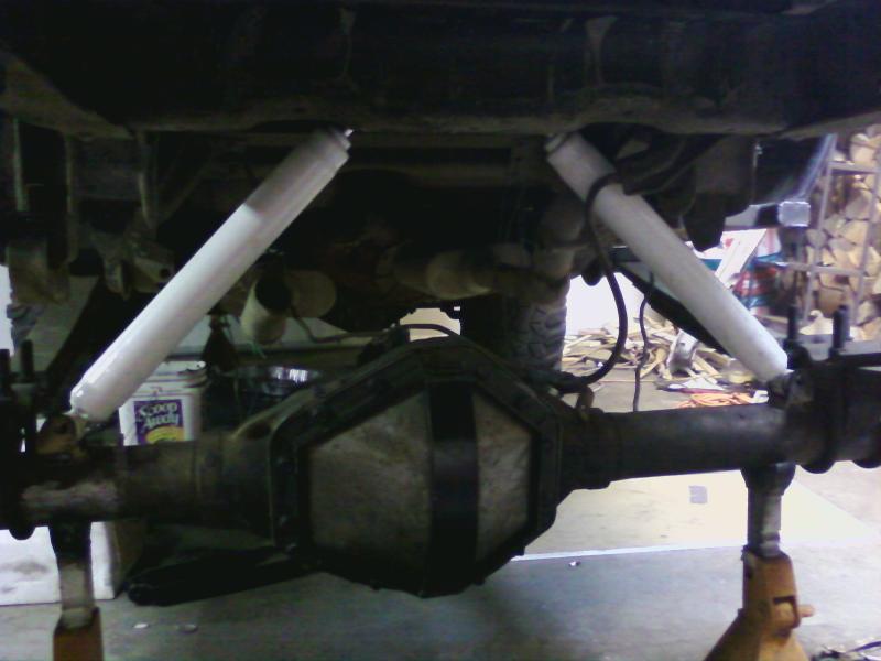

Here's the stock cover after it was cut to match how much I shaved off the pig... And installed under the Blazer...
