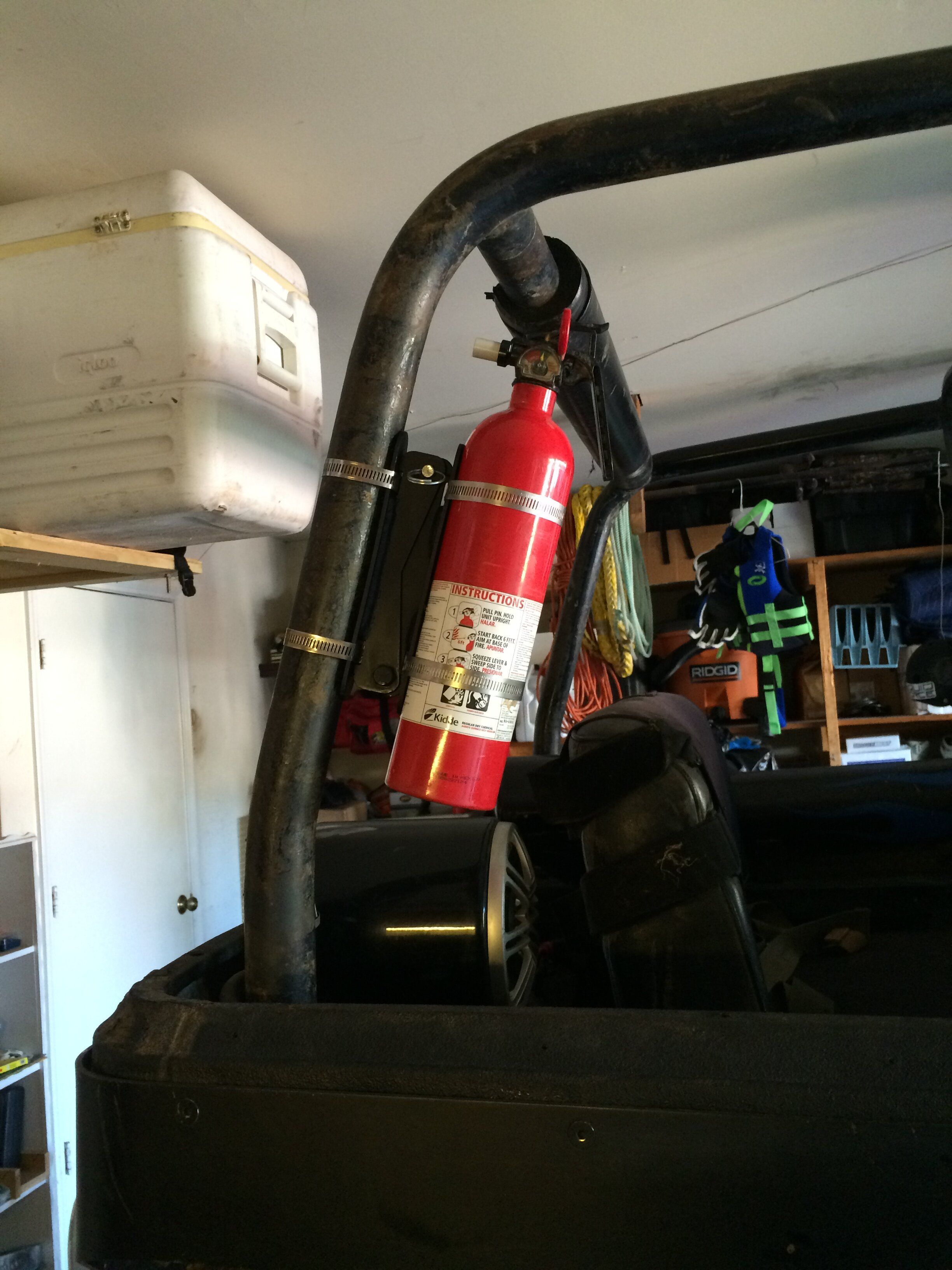

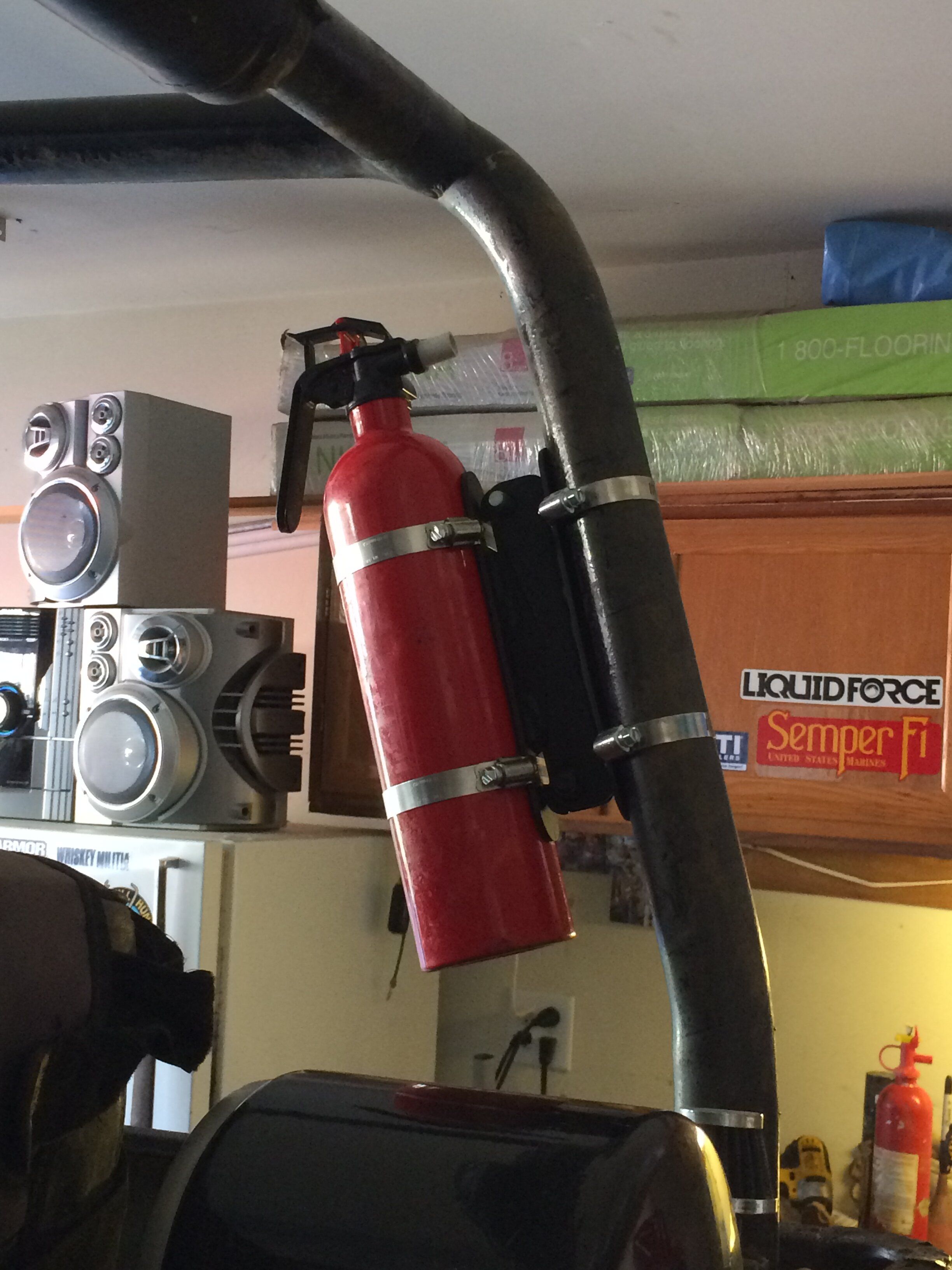

Bumping this thread back up. Got 1 of my 2 mounted. I'll mount the other when I buy another extinguisher. Thanks JDuck! :dblthumb:
    676.7 KB
    625.4 KB

Any chance you would offer a slightly longer bottom piece to allow room for a hole top and bottom for flat surface mounting were tubing and clamps are not an option?
Puppy said:
Safety First!
Any updates?
I'm sure I could do something like that. Shoot me a pm and we'll work out the details.

kmcminn said:
Where did you get them pull out pins? I need another one. I tried to force it through the hole. Not good idea.
Fastenal usually but most places like them will have them.
Exactly which hole were you forcing it in?
One of the holes in the mounts. Where the torch started cutting it had a starting point that protruded into the hole making it to small for the pin to go in. Ended up drilling out the holes and truing up the inside diameter. It did that where I would not ruin the other pin. Thankfully I ordered two mounts and only had one fire extinguisher.
Pm me your address and I'll mail ya a replacement pin. That's odd that it did that, I chase all the holes with a 3/8 drill bit and ship them pinned and bolted together to make sure they all line up.
