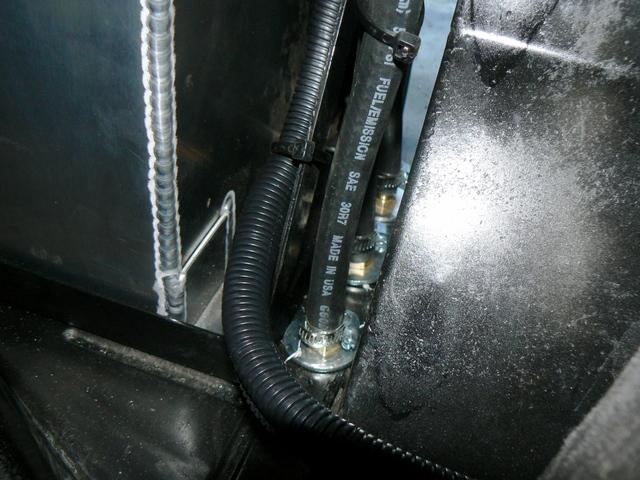

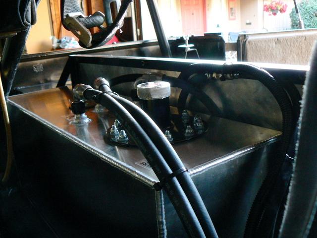

I looped mine behind the cell then ran it out the tub.
