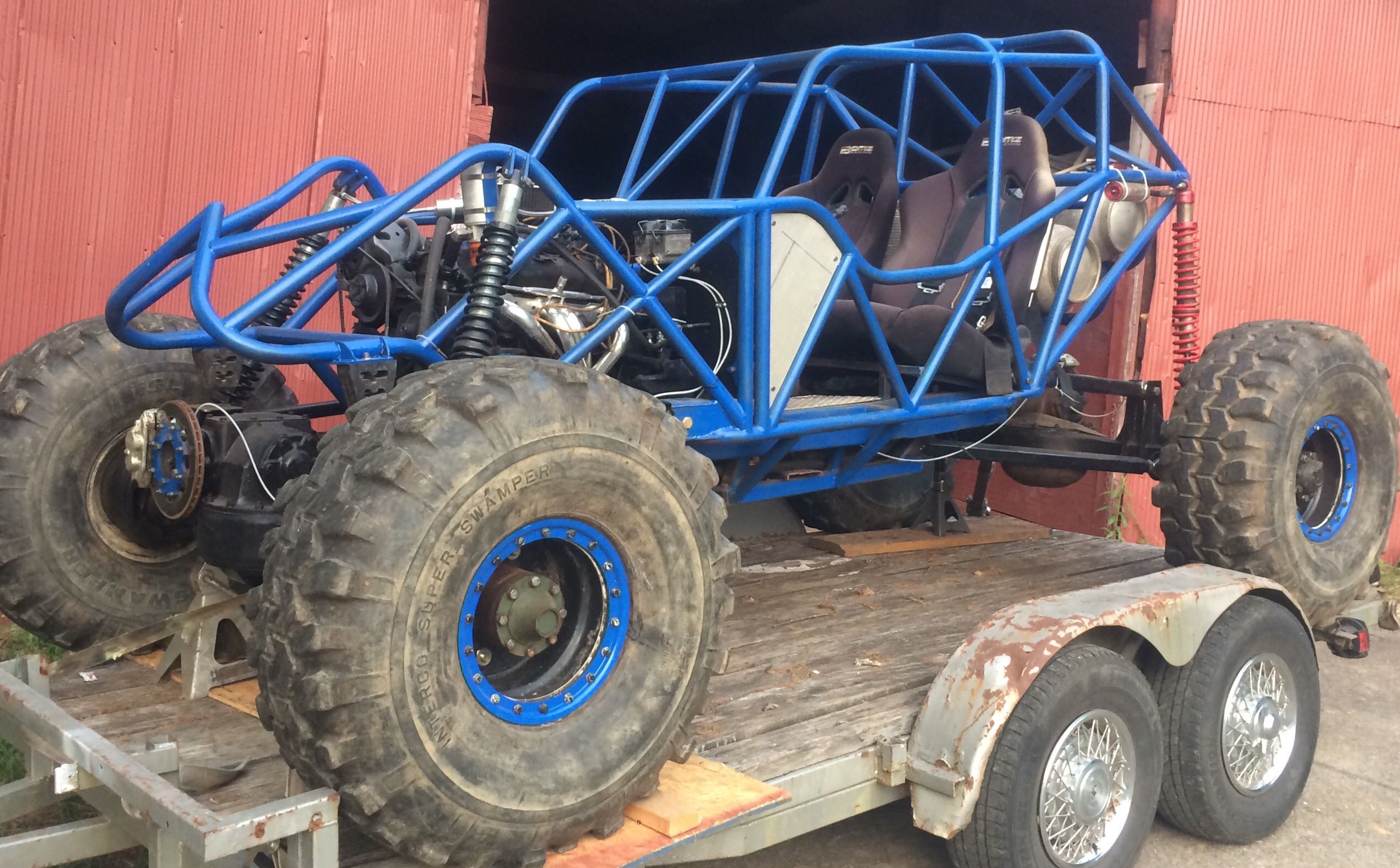

I was really bummed when I heard 747 motorsports was not doing tube work anymore, however my second choice did ok. :flipoff1:
I got some welding to do and a couple of small things to finish up. Luckily I have property so I can do test donuts and a couple of little jumps. Shouldn't be long till a good beating.

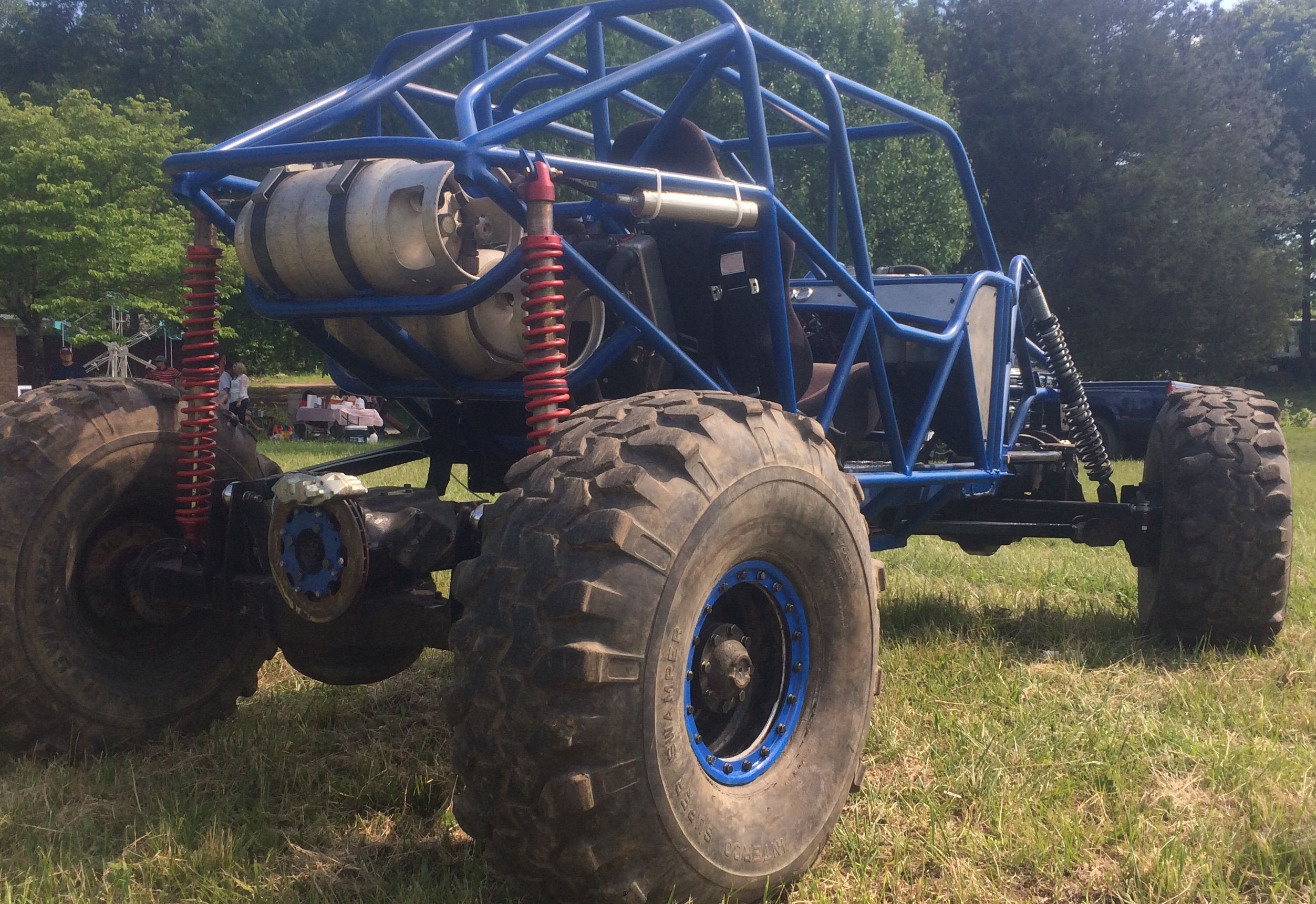

The propane bottles roll in from the rear.
Cool, that's what I figured. Also thought you may have a bolt on tire carrier or cooler rack to replace the tailgate for long rides and such.

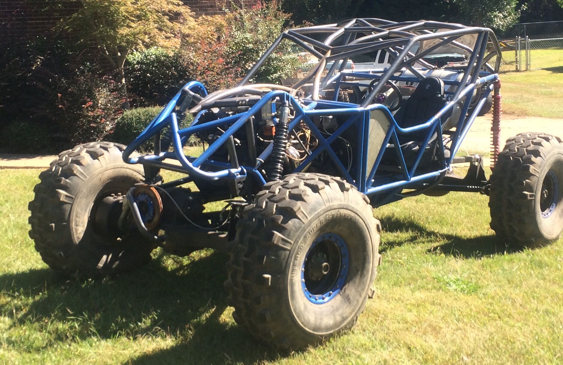

Sooo I didn't make my nov 7th deadline but I'm close. I'll post up some finished pics in the next day or two.

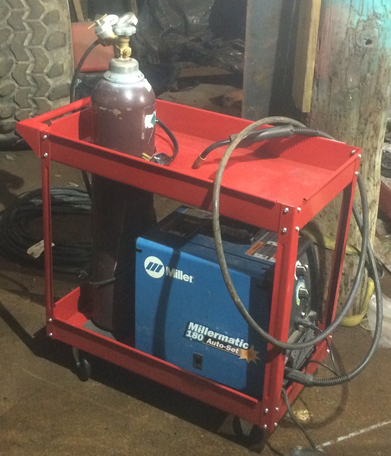

I did however make an awesome $29 welding cart.

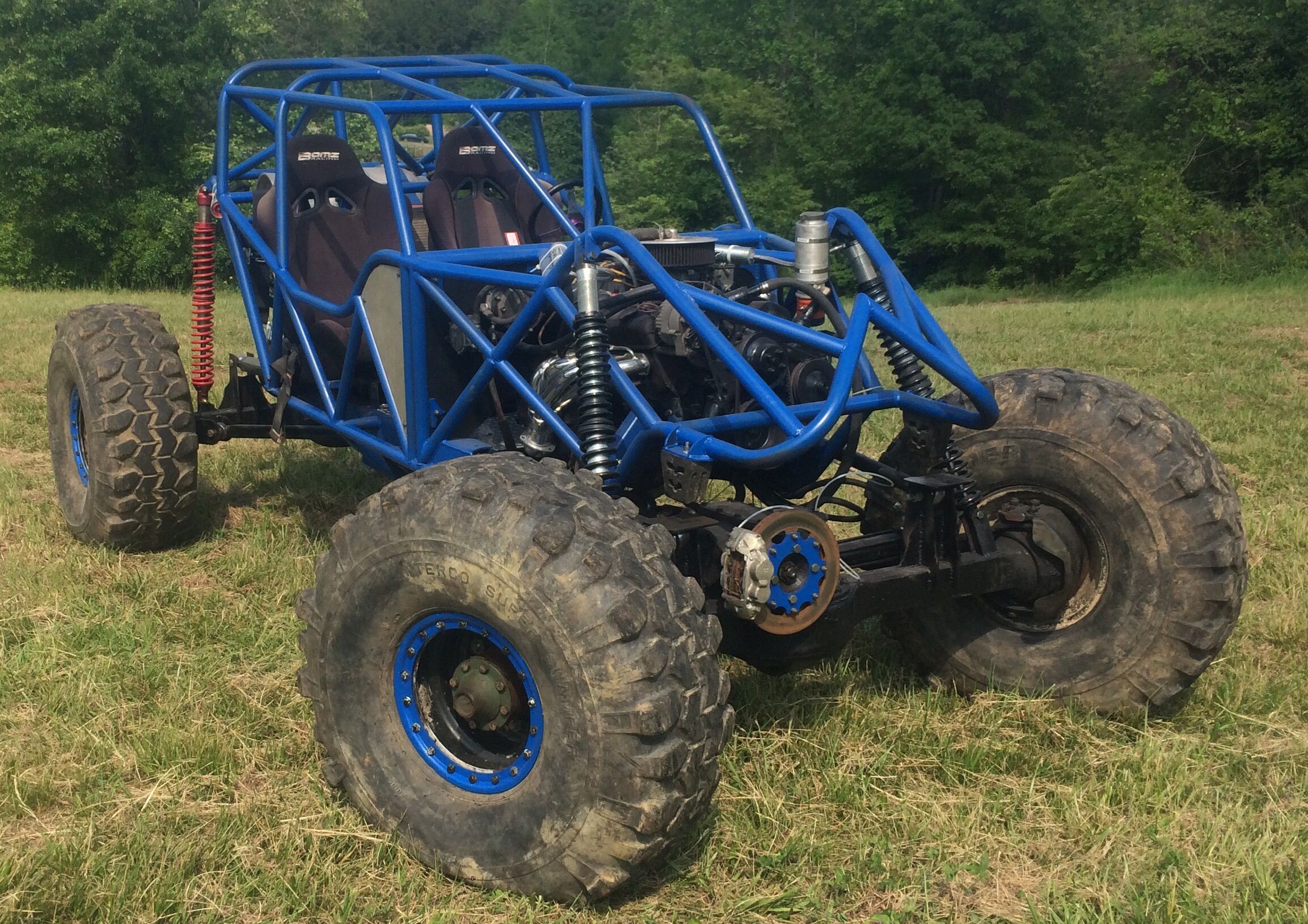

I would like to publicly apologize to rocfun for my welds on this beautiful chassis he bent up for me. :****: He did the fabbering and I did the weldering.

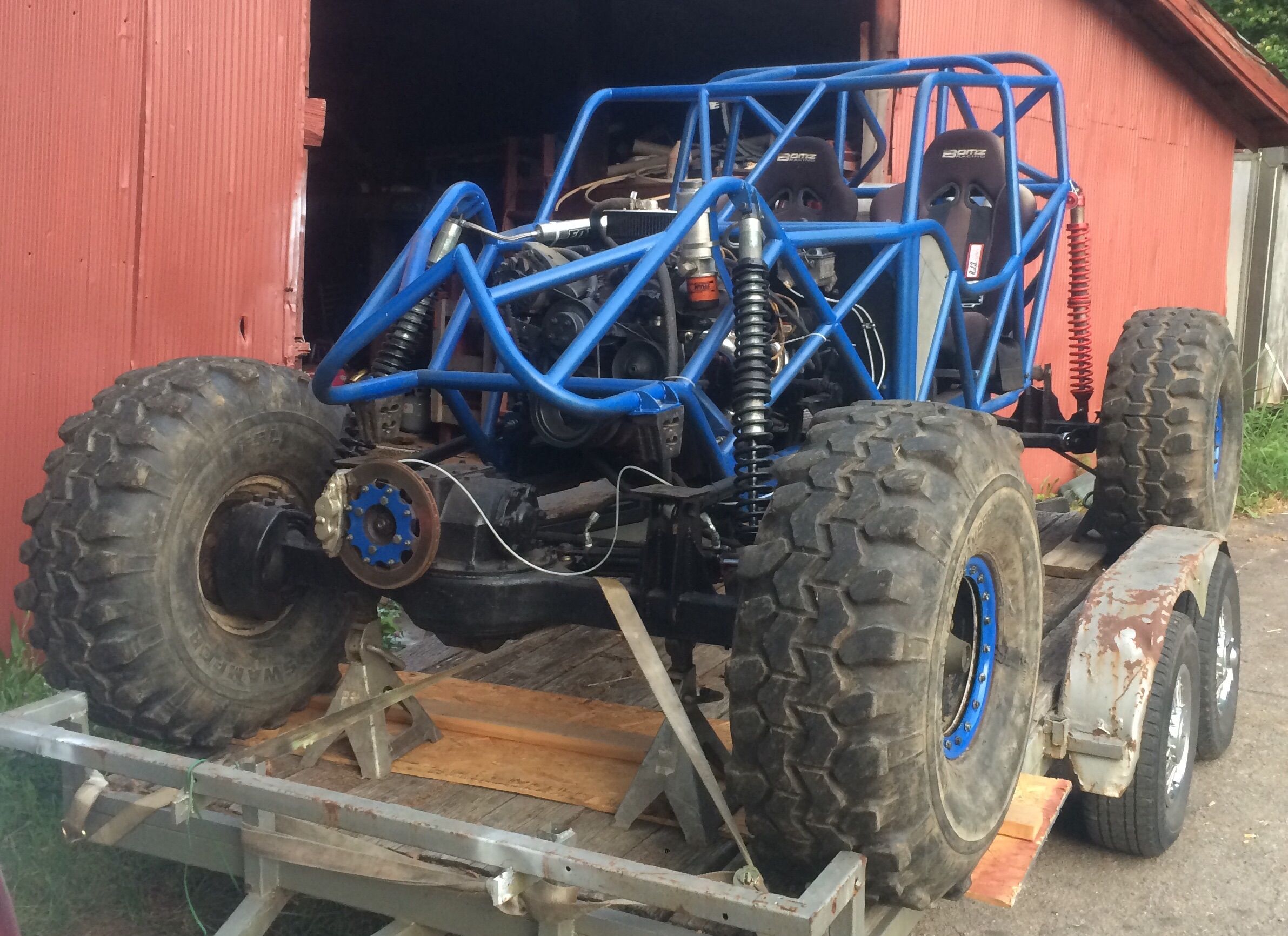

Chassis is welded up. Limit straps are moched up. Trans cross bar was raised for smooth belly.
I've got to tweak the steering ram a little or buy a decent ram, mount seat belts, secure plumbing, make the wiring look like a drunk monkey didn't do it, and get the tires to hold air more than an hour.

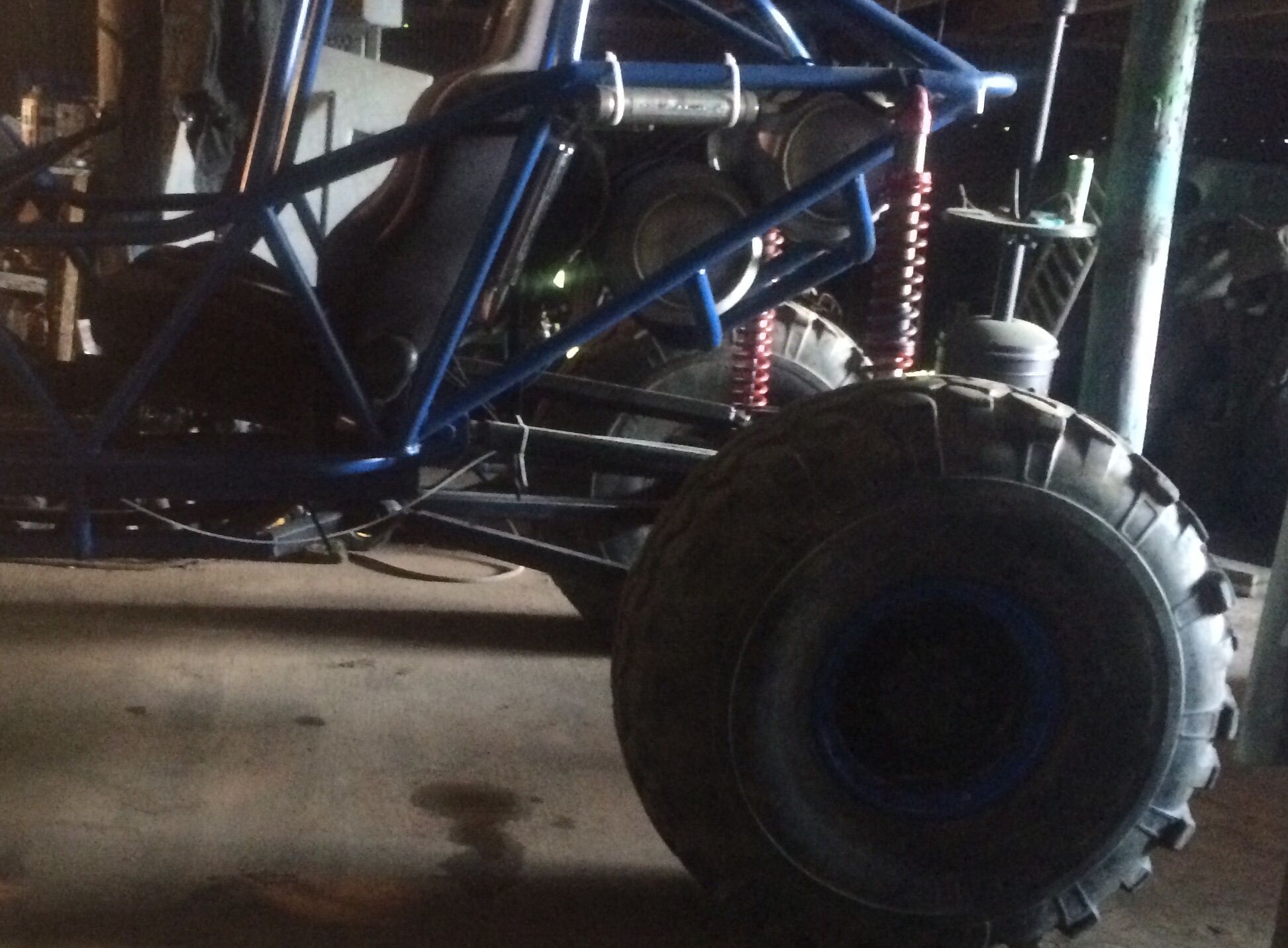

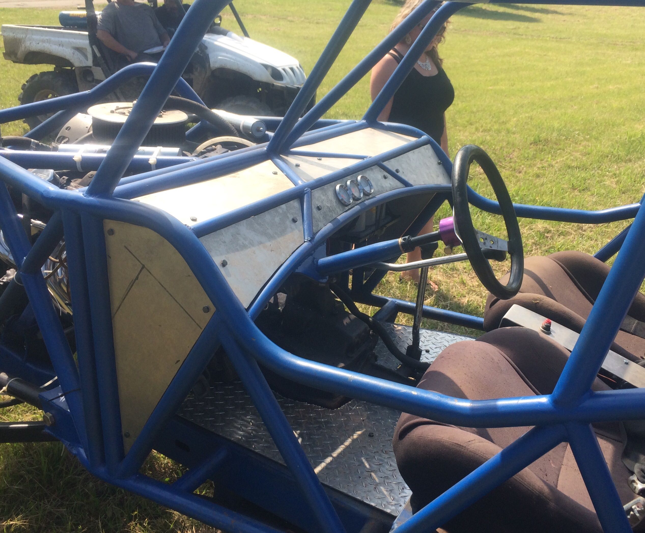

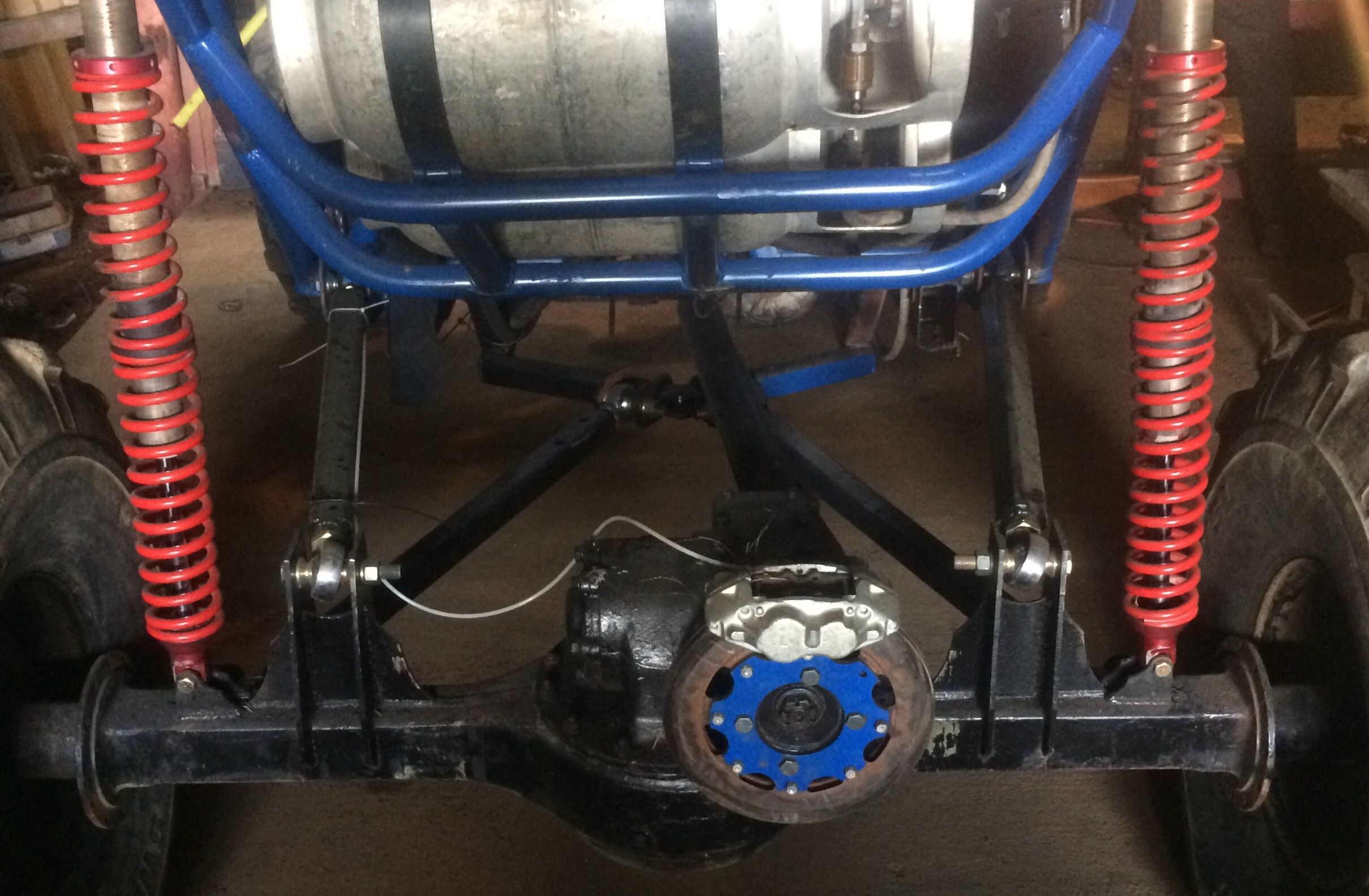

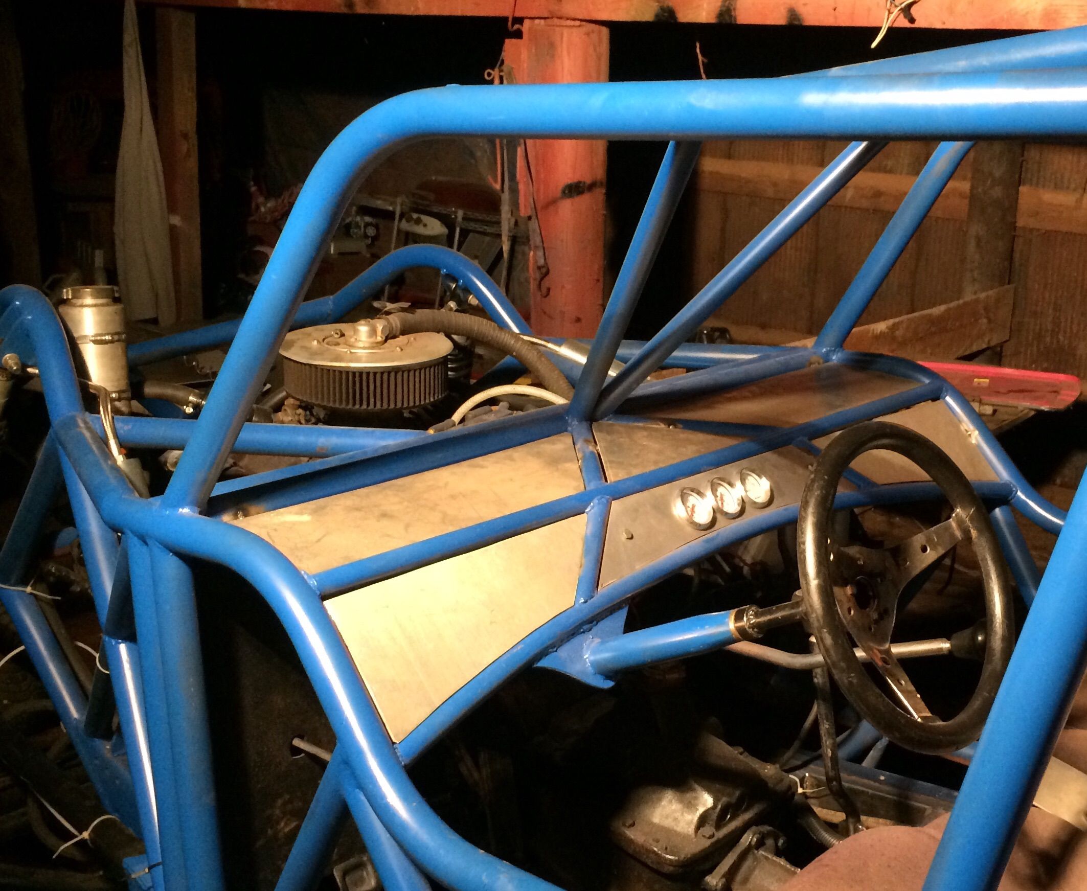

Knock out a couple of things that I've been worried about.
Got the seats mounted and five point harness done.
Shock mounts on front axle are slightly under built, so I added an additional brace and tied limit strap into the mount.

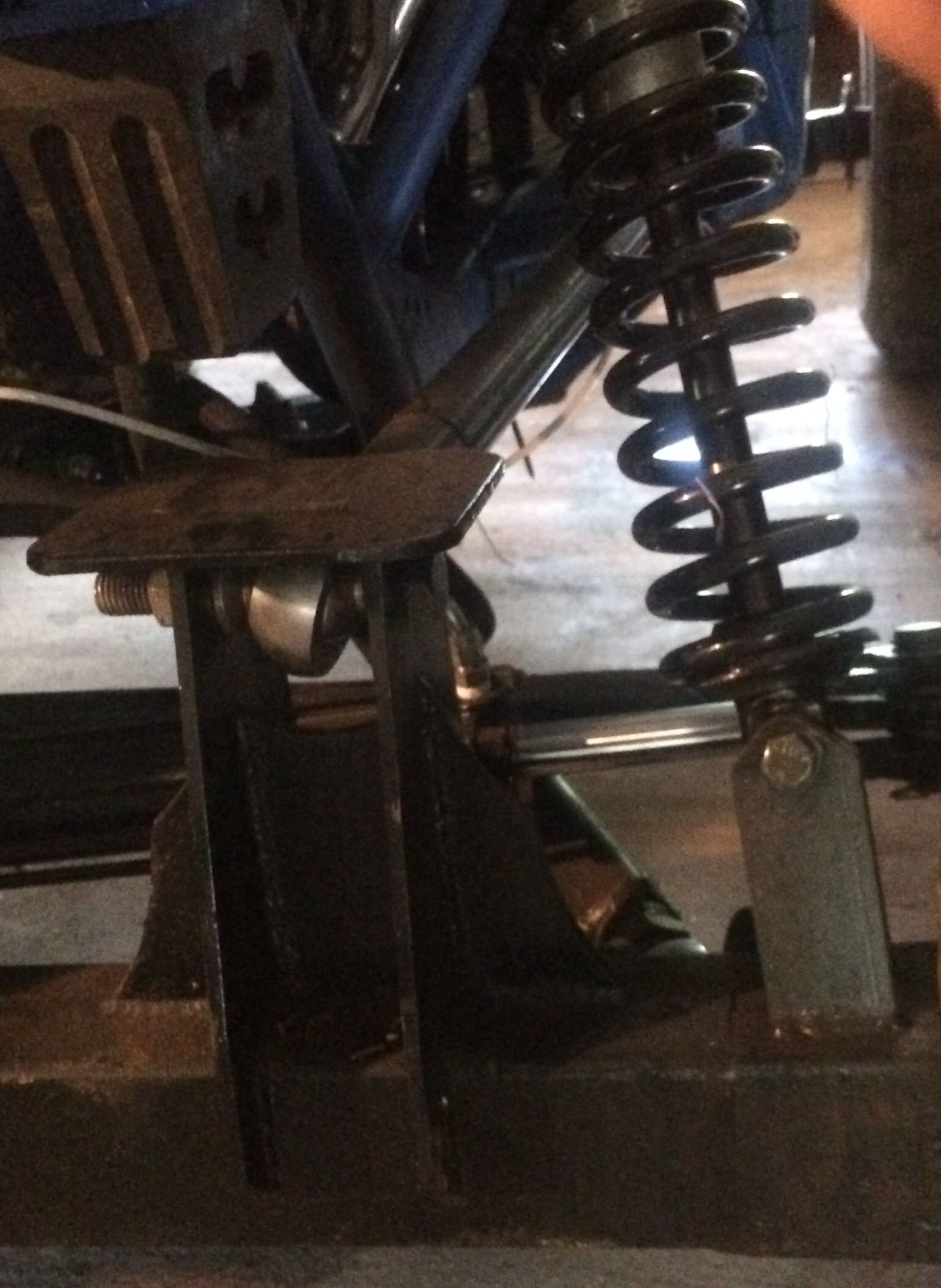

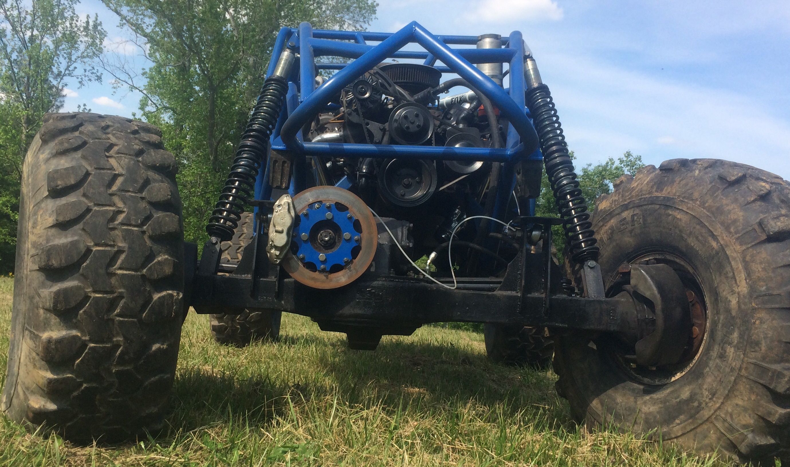

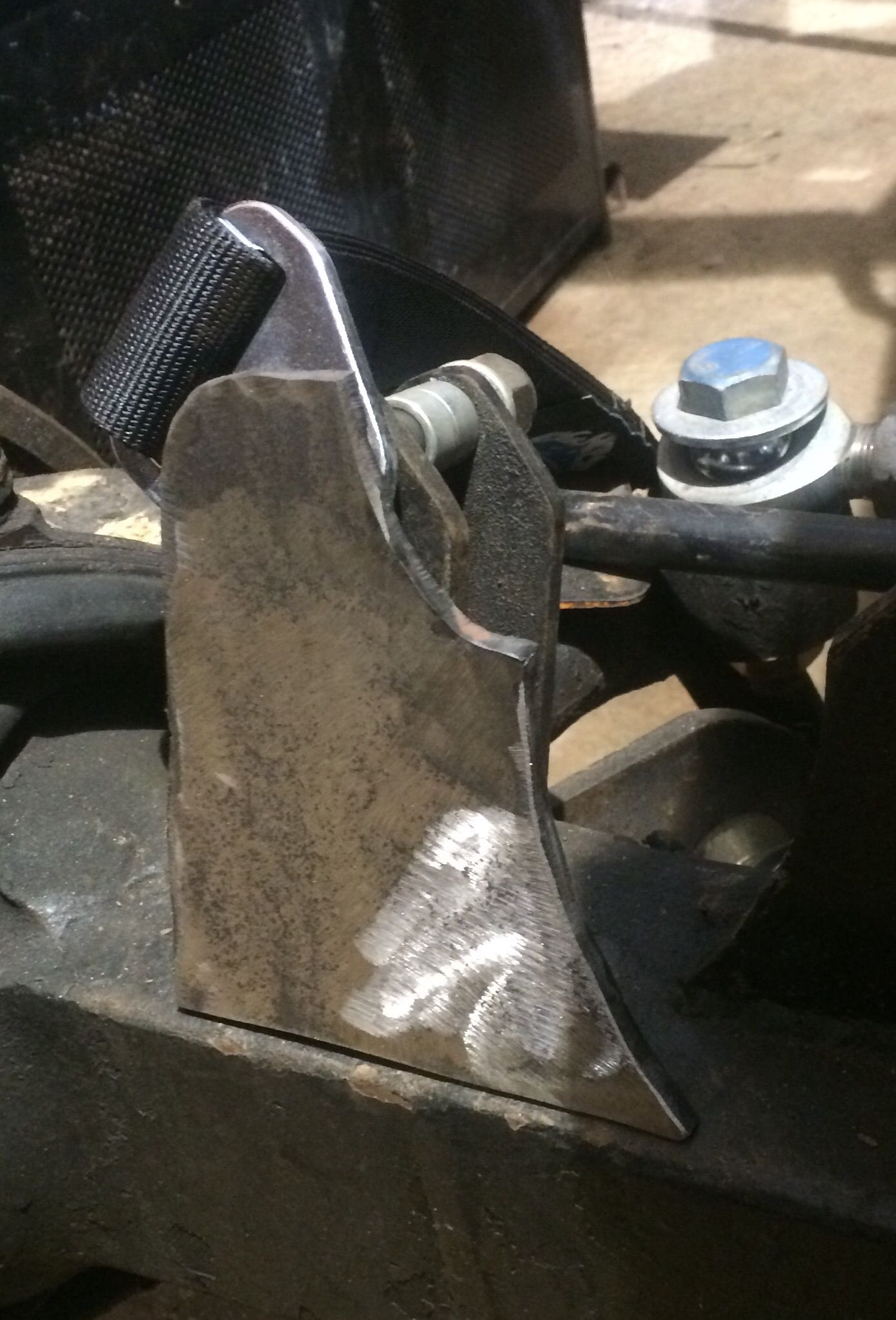

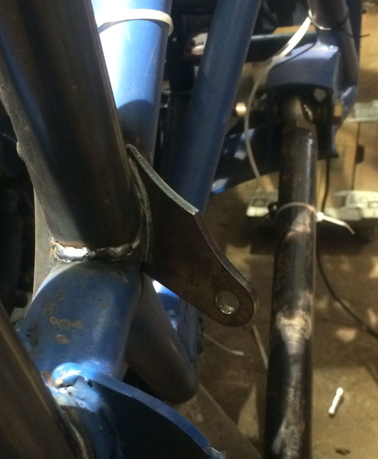

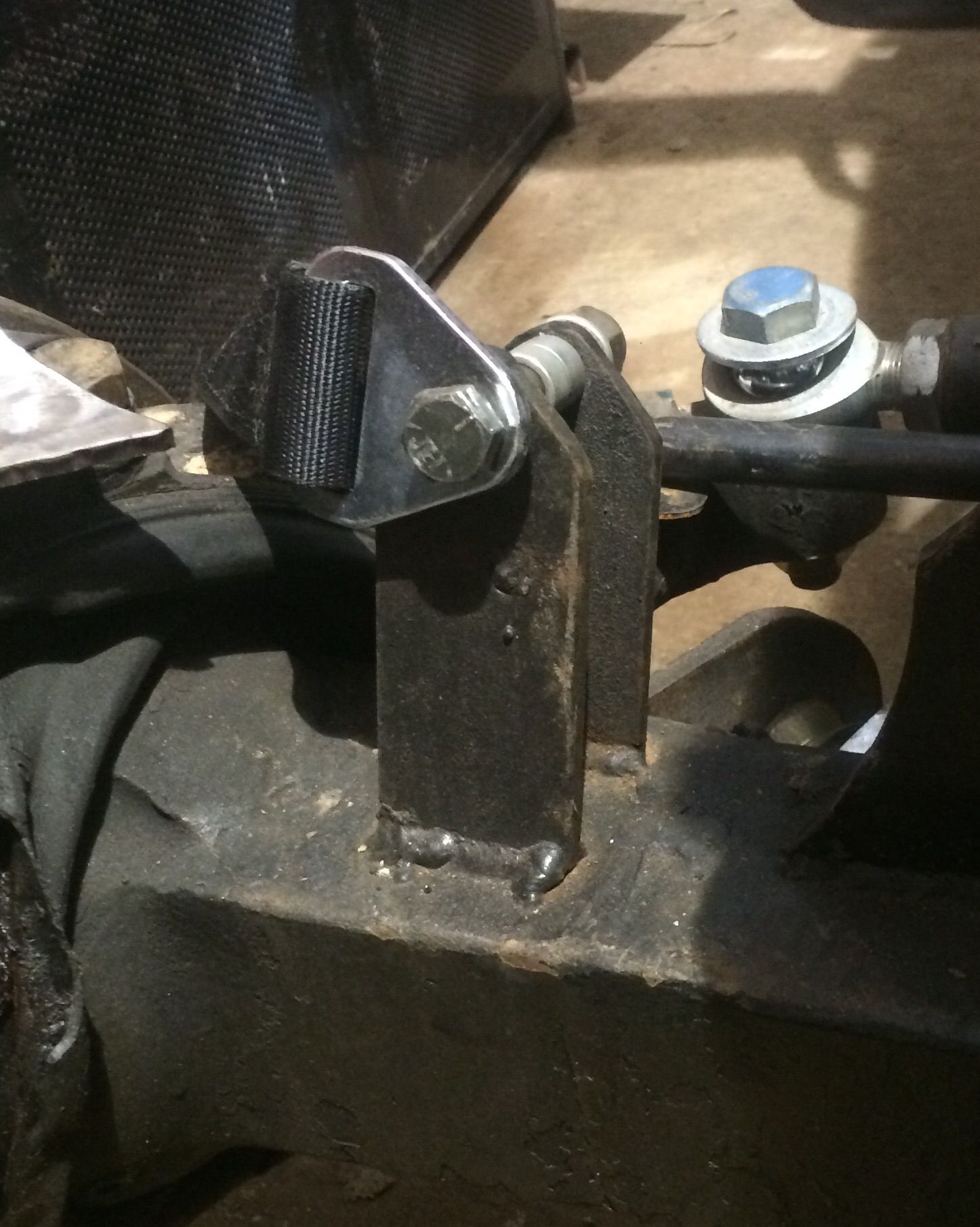

Did upper limit strap mounts. Found a BTF shock tab that worked perfect. I may add a second and mount it double shear. What do you guys think?

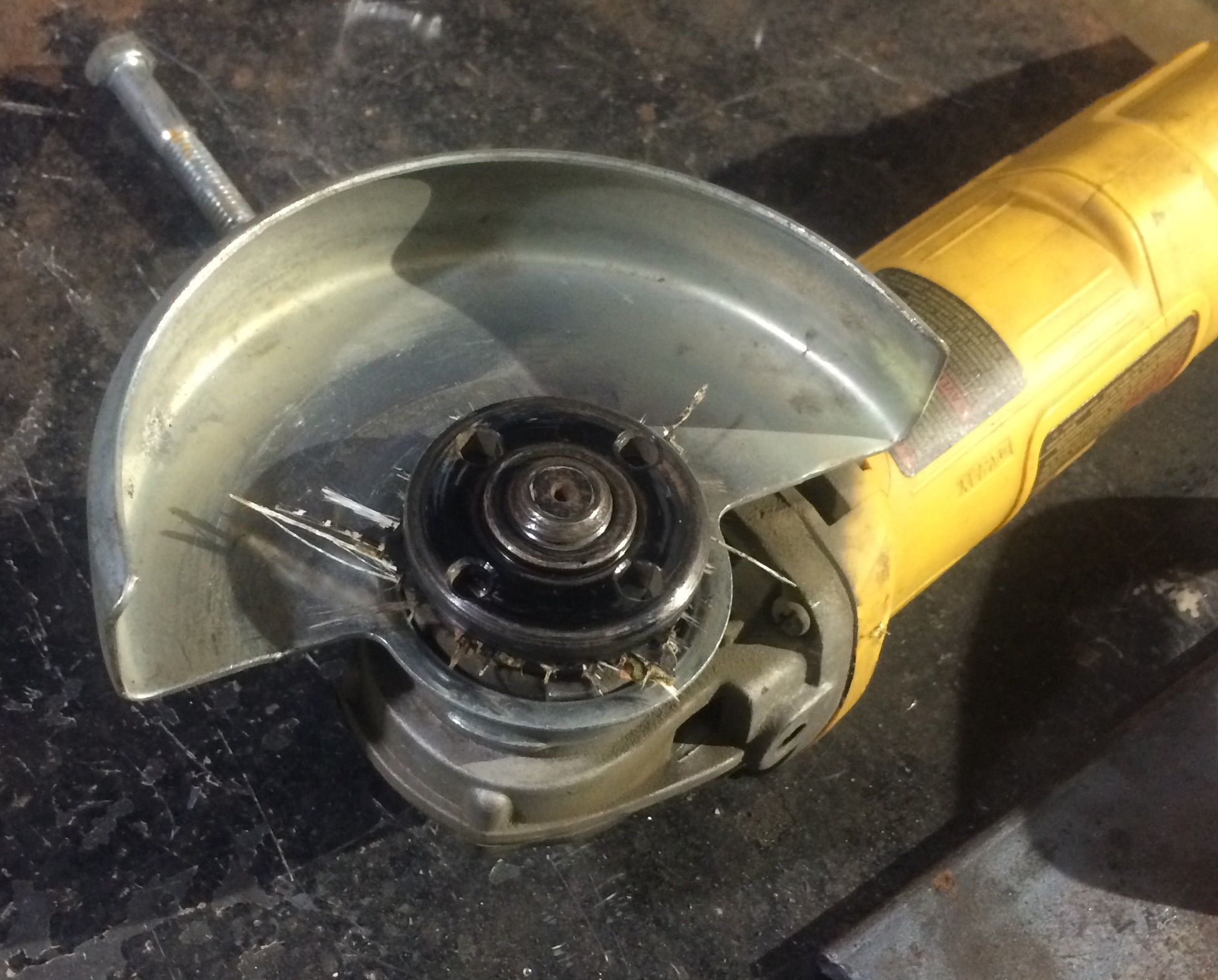

Had my first cut off wheel come apart on me tonight. That's a life changing experience! Luckily I had on my welding gloves, still hurt like hell.
Build is looking good man thumb.gif I'd go ahead and double shear it, no need to worry about it ripping out and messing up a coilover.
I haven't had one of the 4.5" wheels blow up yet. I spun one of the 7" wheels a little to fast on the air grinder once and it shattered, it was sketchy to say the least.
