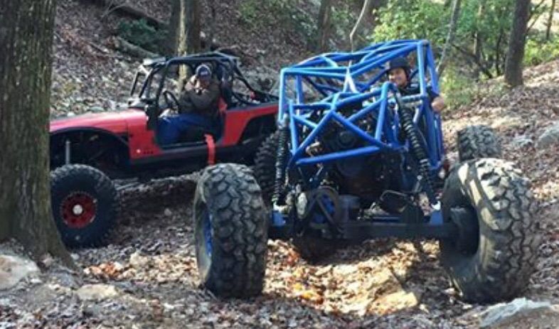

Well I got to beat on her for about 4 hours at choc. I ended up riding with John G, Jerod Yankey, and Kush. Awesome group of guys. John and Jerod seen me fumbling around getting ready and walked up and just started zip tieing and helping. :dblthumb: I wish I would have got to do a couple more hills but she drove back on the trailer at the end of the day and that was my goal with this build.
Only issue I had was the relay for fan was not a continuous duty and burned up. I have a Volvo relay pack to put on just haven't done it.
The mom and pop store that I get propan over filled my tanks. As John just happen to be walking right next to my rig, the pop off valve opened for a split second. John can still move if he has to, ol boy hit the ground and pulled some evasive maneuver. laughing1
It was really nice with Kush, cause his jeep was broke down more than mine. Took the attention off of my junk. :****:
Actually we wheeled all day with hardly any problems. My fan relay, kush's power steering pump was loose and something about a hose and bungy cord on kush's jeep that pissed John off.
I was feeling pretty good about my rig until I seen the "stickie club" walk up everything. :gay:
Last time I rode with joh he told me he needed a bolt one time and kush took his seat belt bolt out with his hand and gave it too him. :****:

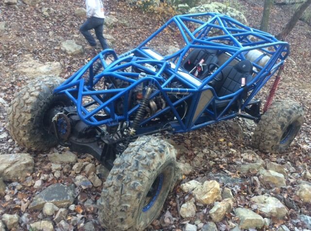

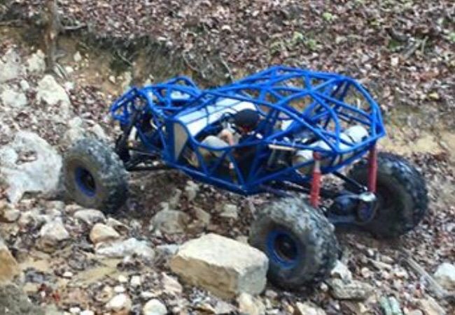

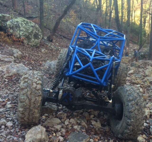

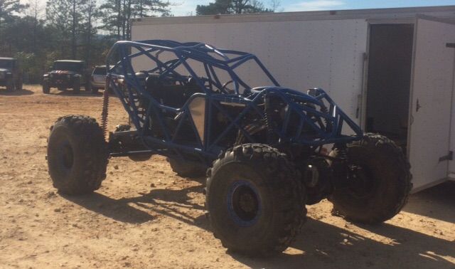

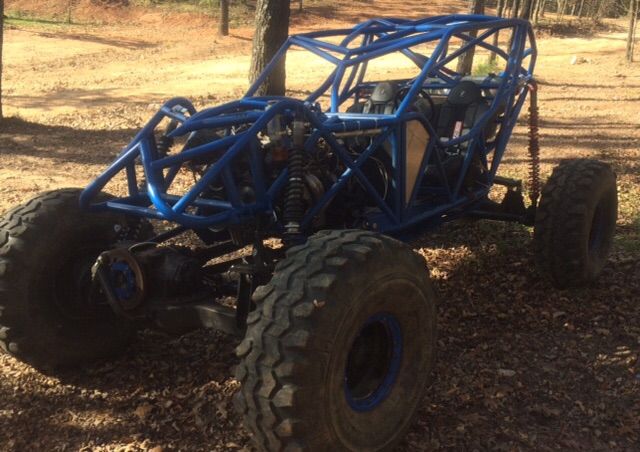

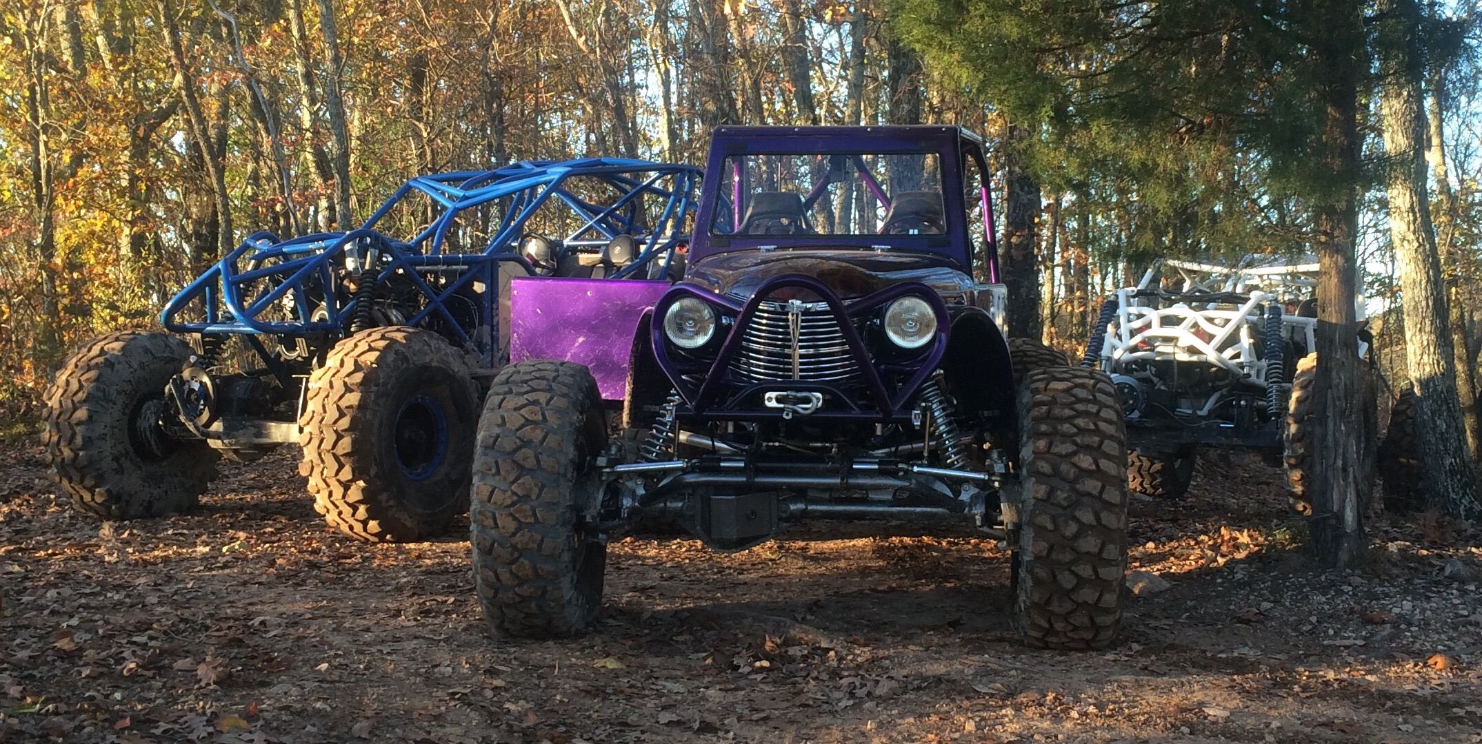

Pics from choc.

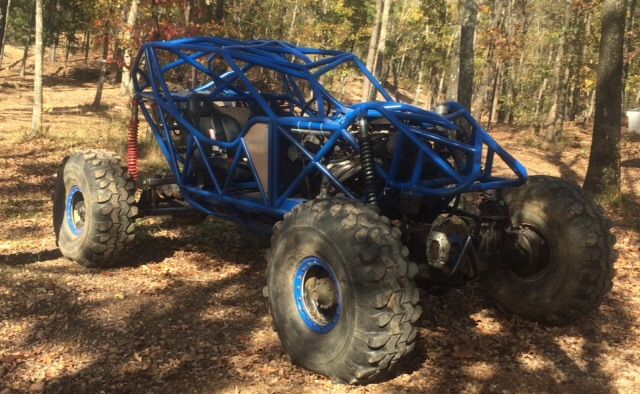

I wish I would have got some action shots.
Tech update: the 3/4 inch line going back to the radiator seems to be just fine. It was about 70 degrees outside the temp stayed at 170-185. The only time it climbed was running from the front of the park to back of park. It went up to about 195. I was running in second trying to keep up with John G, and should have been in 3rd. The RPM were pretty high, but RACECAR!!!!!
For anyone looking to build a cheap rig. I will say that one thing that has been on my mind during the build, is the gearing and manual transmission . Yes I would prefer a auto, but at this point I love the simplicity and knowing it's going to get me back to the trailer even with a hole in the side of it. The gearing is very good for all around wheeling. While I was building I was always looking for a doubler for sale on here. However after one ride, I found it is actually pretty good with the 205 in low. If I do anything I'll do a rebuild with a lomax kit. I believe, that second in low is very close to first in high. Same with third and second. The 3 to 1 would split the gears instead of them being so close to each other.
The 42 inch tires, rockwells and wore out 350 go good together. Just thought I would throw that out to anyone building.
