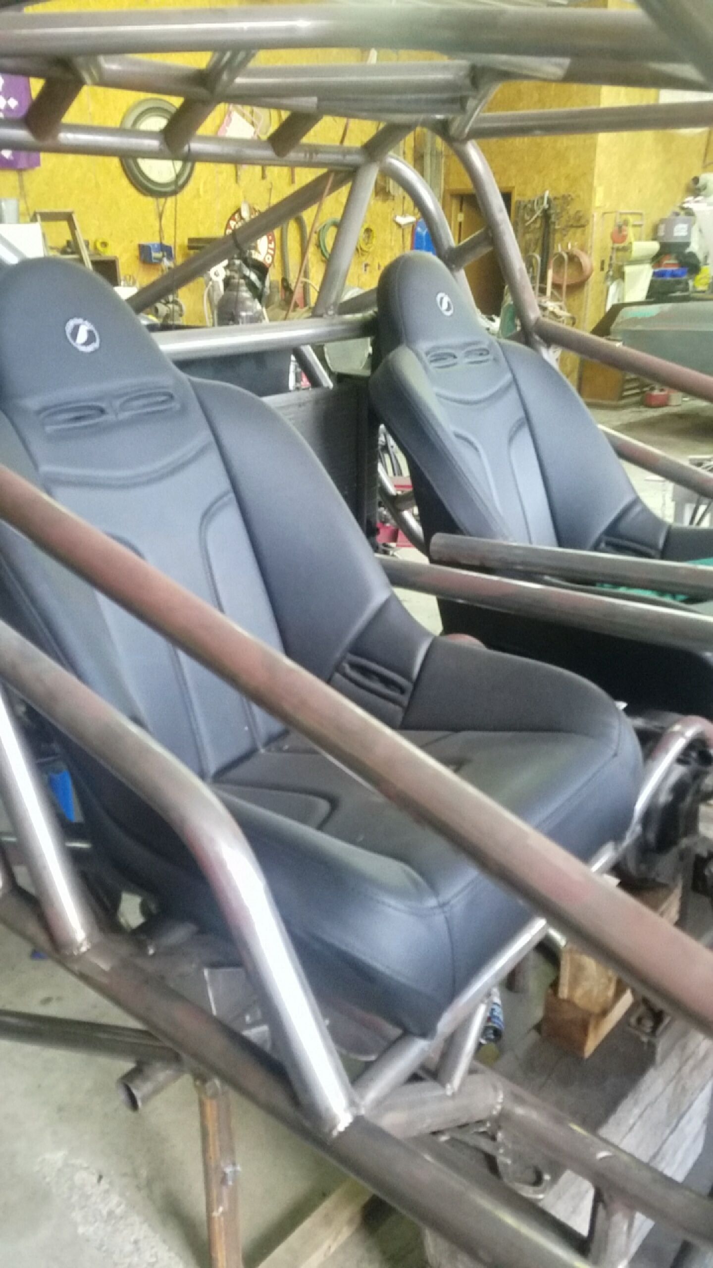

A few pics of the corbeaus in place, and the tons that I picked up from pholmann. Also a set of 16" travel foa, triple rate coilovers that I found on here a couple weeks back.. I know they catch alot of hate on here but I got em at a steal, they will work for now..

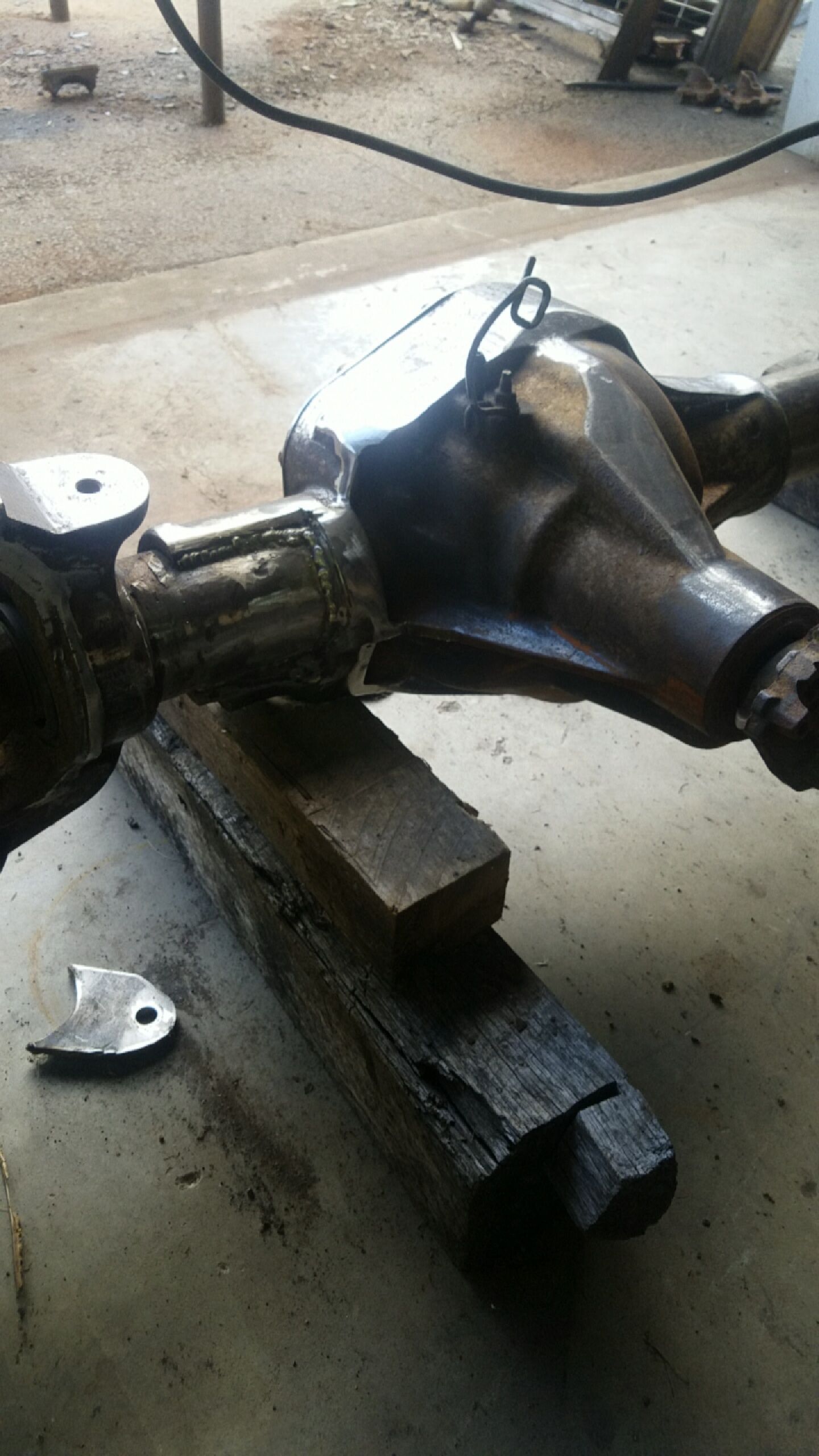

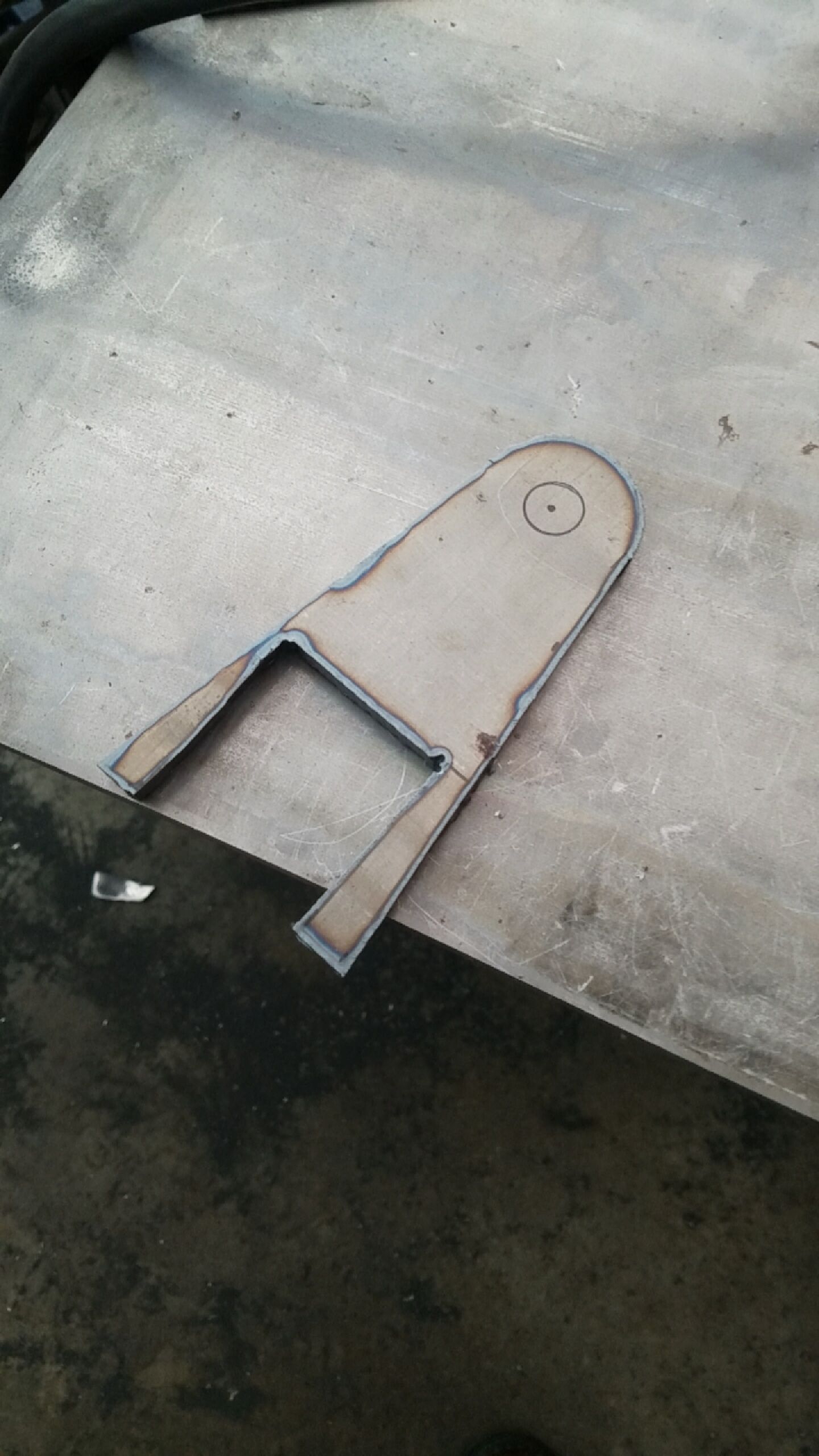

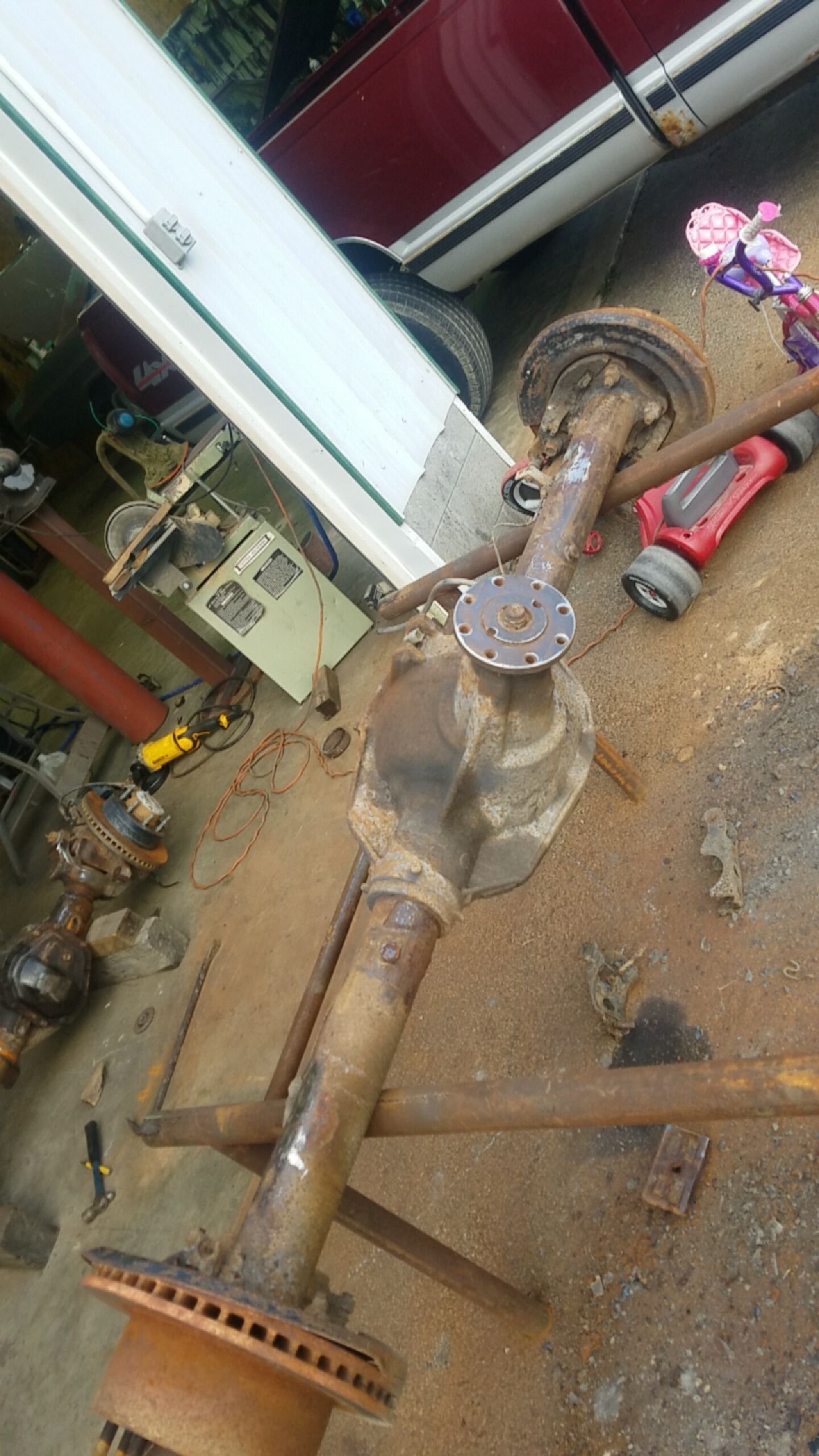

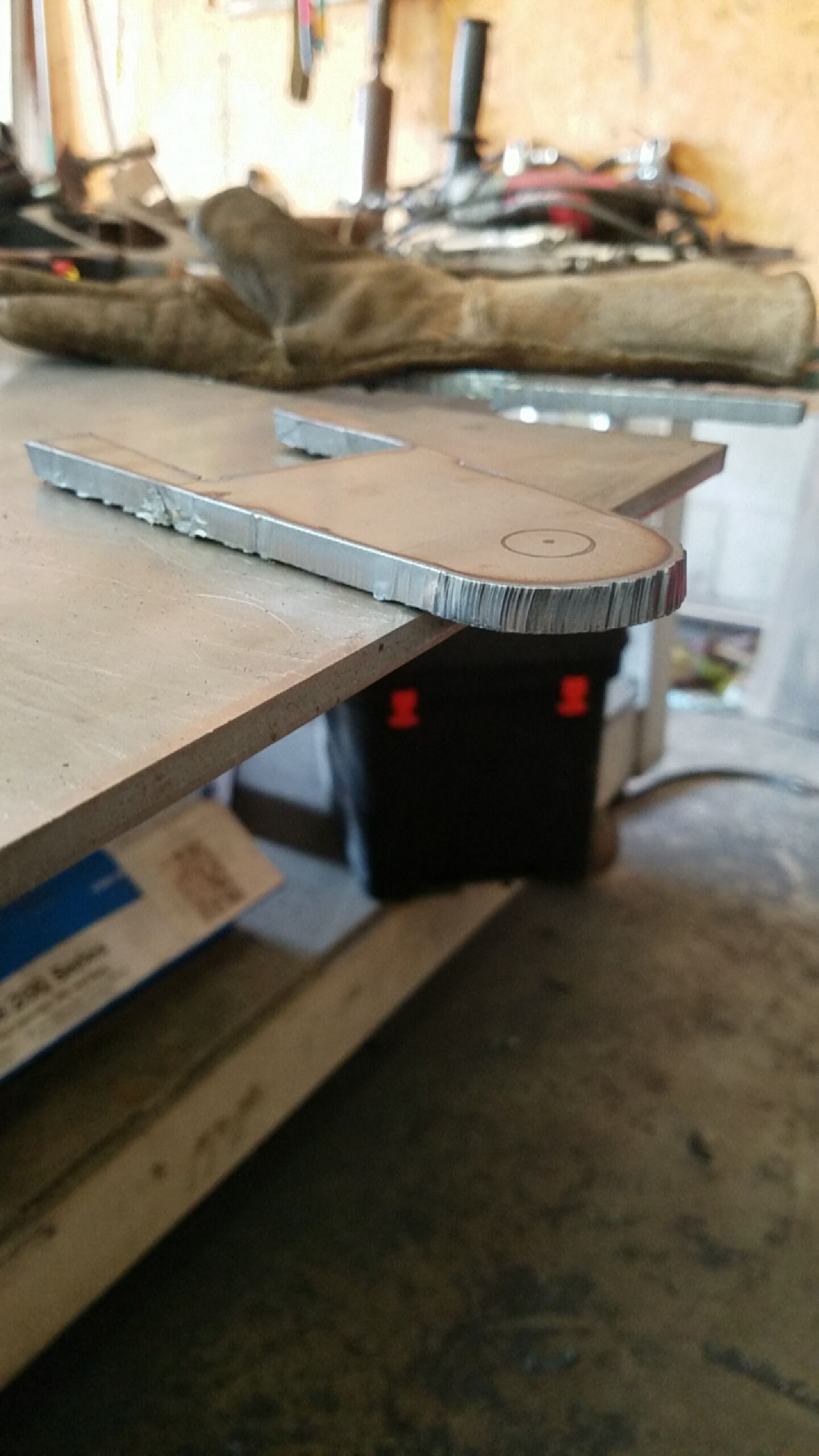

Progress has been slow lately, got married on July 30th so that has definitely been taking priority, but now I've been able to get back on it.. some pictures of the seats mounted and the start of the dash and console.. also been carving on the casting on the super dutys, the rear end brackets were cake compared to the 60 front end, but I've finally got it ready to weld a lower link mount to..

Looks good man. I know how much of a chore those SD60's are to get cleaned up. Did you decide yet what you're gonna do with the steering?
They are definitely a pain.. I really like the jesse haines kit like you have but I also stumbled upon a new outer knuckle that artec just came out with, their machined for high steer arms and everything, their pricing isn't terrible so right now I'm kinda just waiting to see how my funds are gonna be.. BTW your ride is looking bad ass! :****:

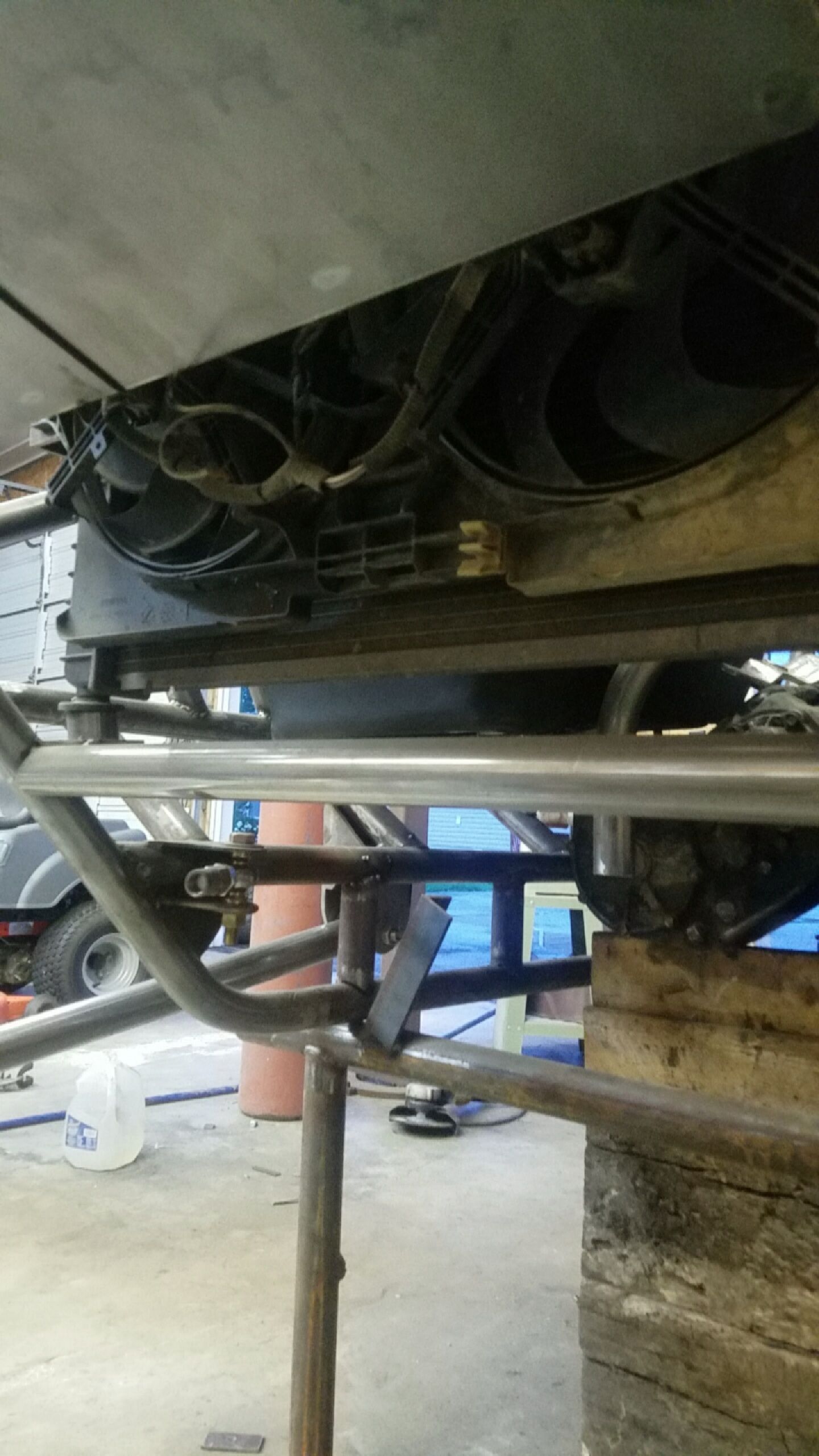

Thanks chasman9 I'm figuring out what options I have right now. I think I can lift my tank a little aND drop the radiator and fans a couple inches and lean them back. This will pretty much open the fans up for a unrestricted path of air.

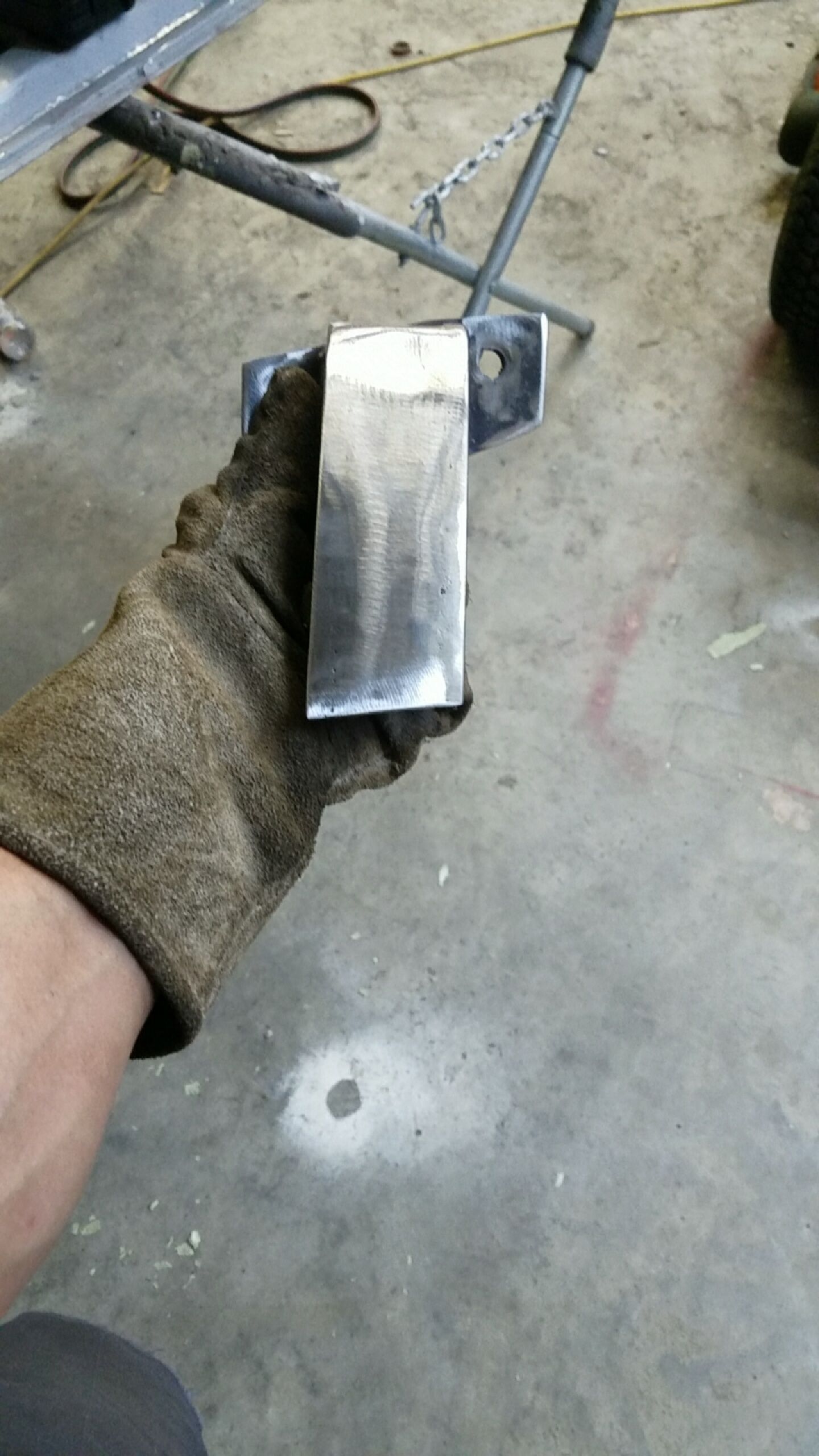

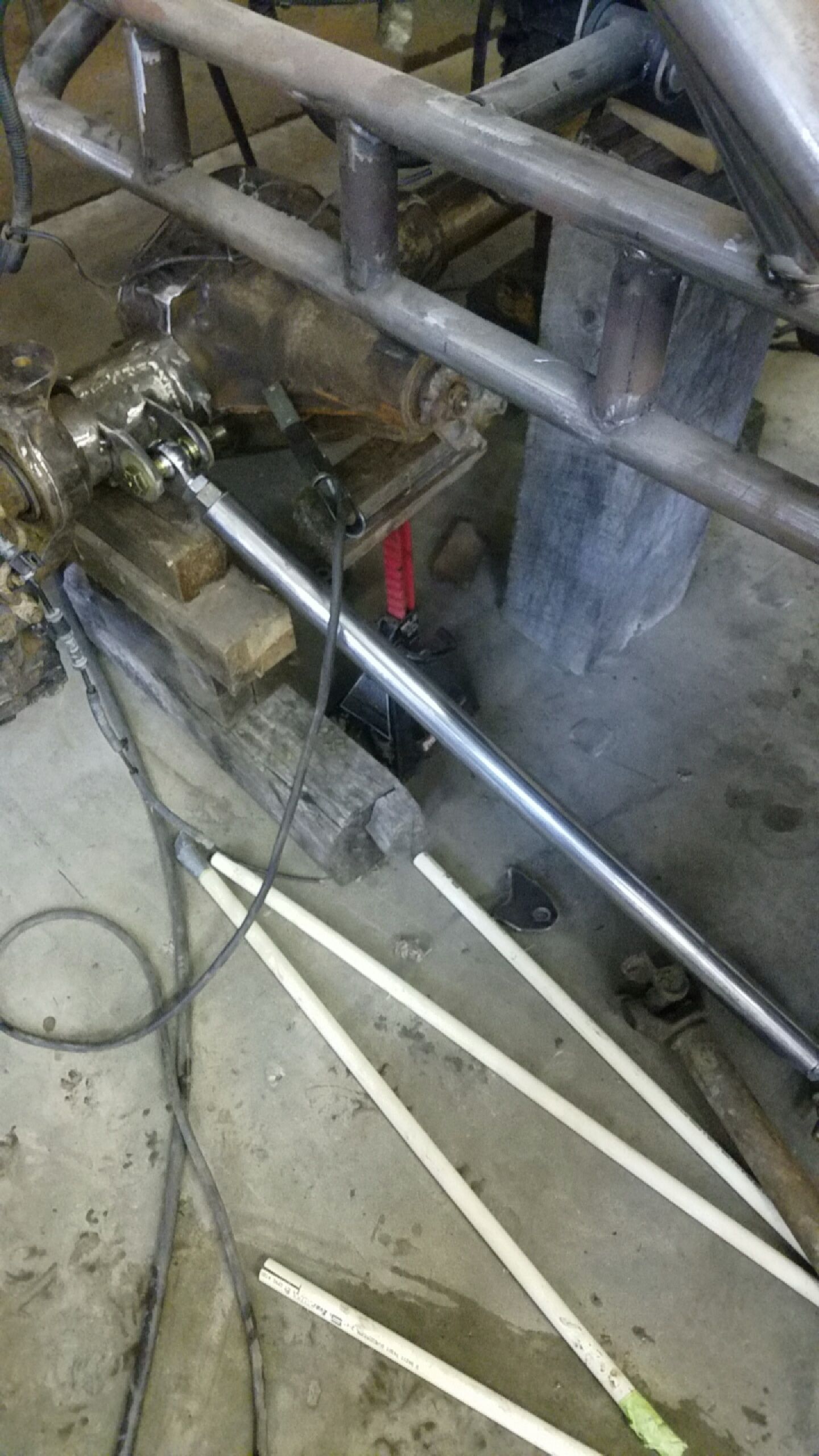

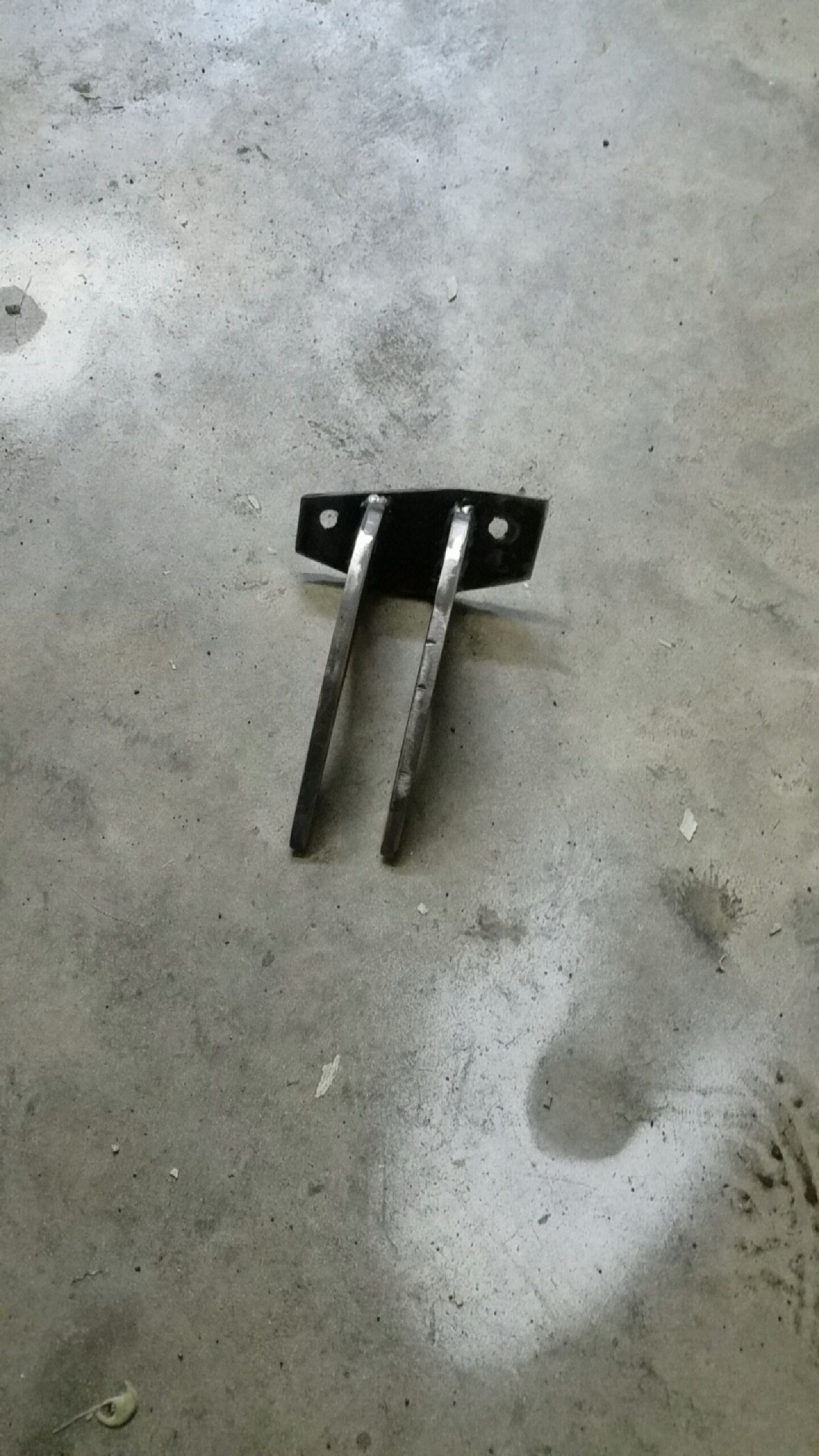

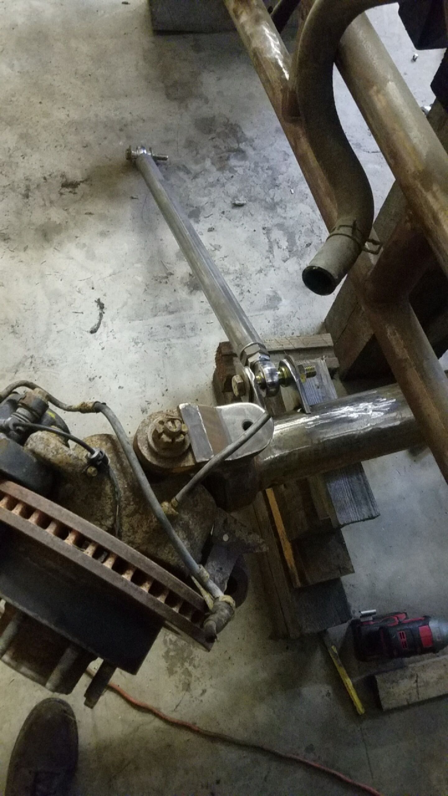

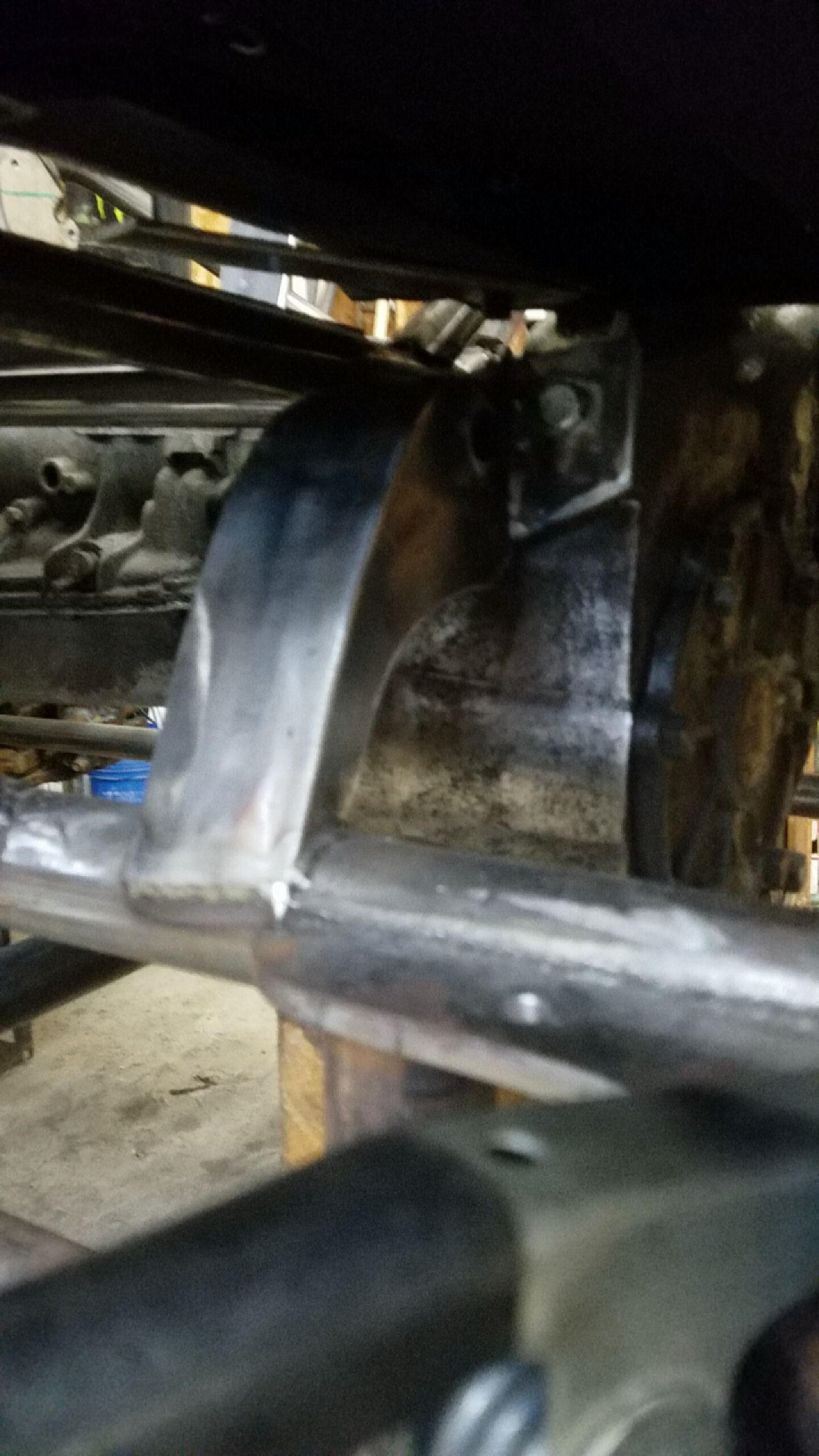

Making some progress on the front 4 link, hand cutting all the tabs and brackets has took alot of time but I like the way it's taking shape..

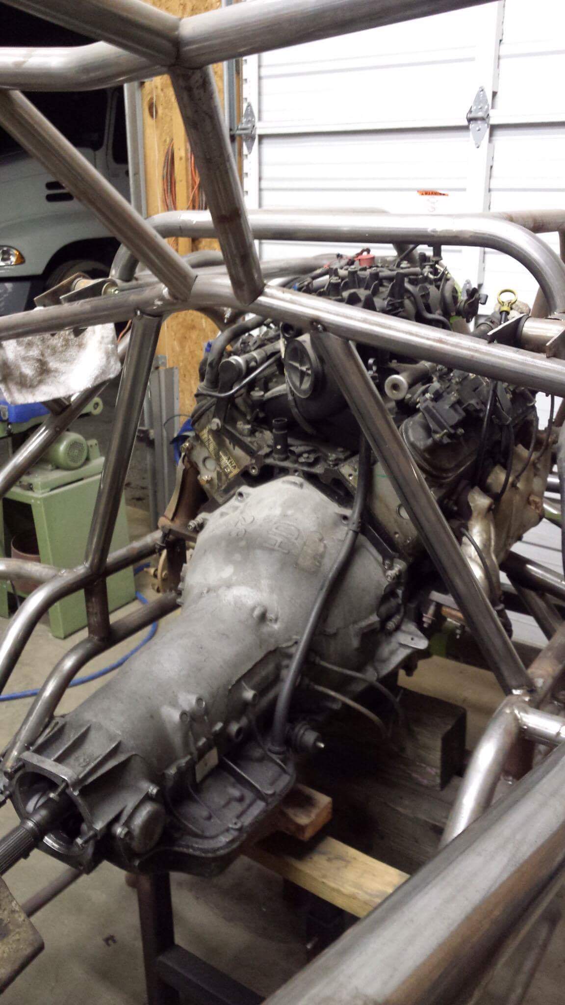

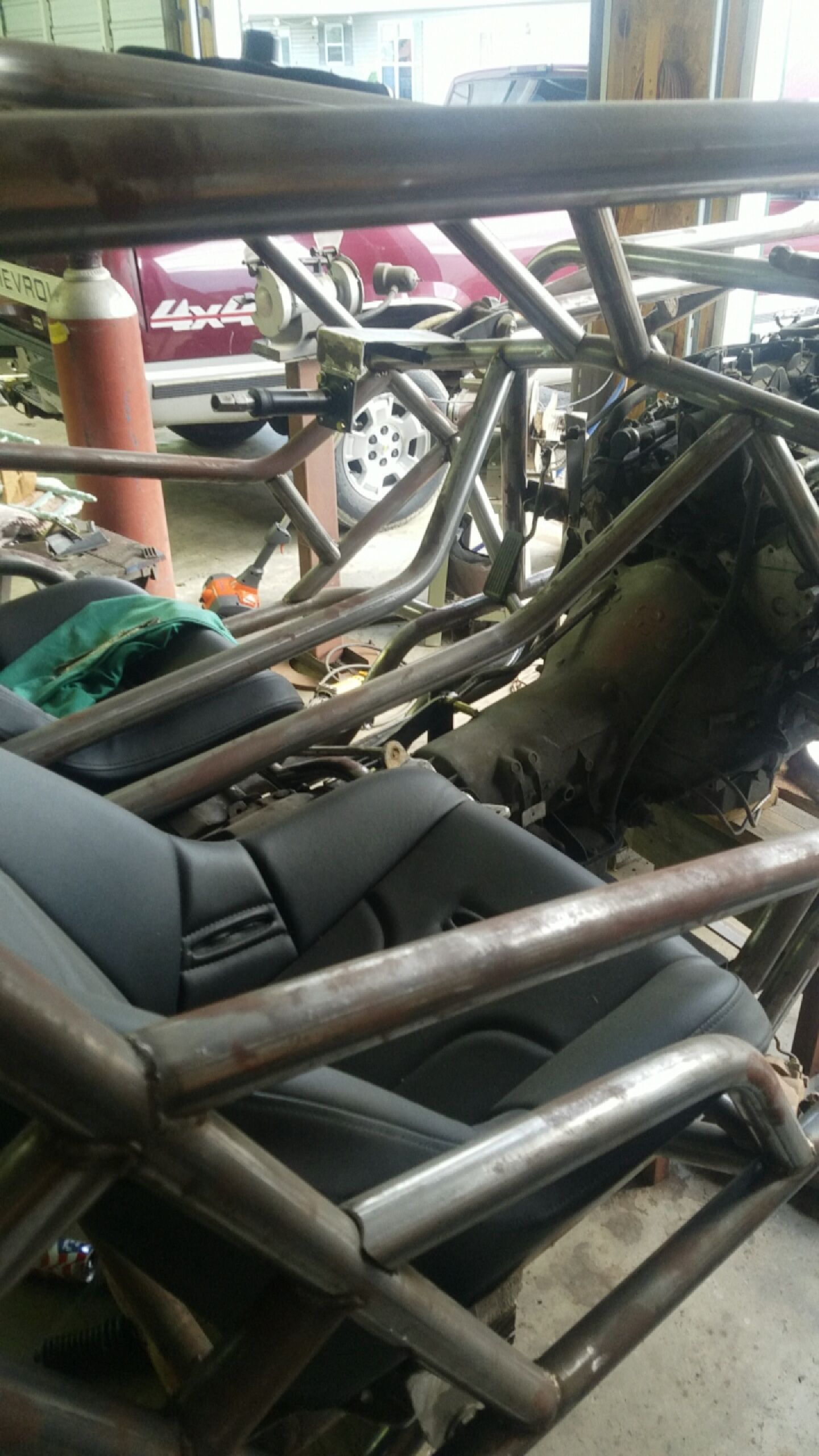

OK pholmann, lol I have neglected updating this thread but I have been chipping away little by little at the buggy.. in my defense we just bought a house back in December so we had to move all the stuff that we've been hoarding up..
