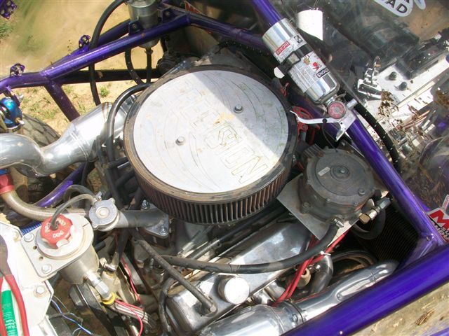

The photo is Tim Cantrell's rig running a 383 stroker that dynoed at 565 hp and had a killer torque curve that started around 1800 rpm. It was interesting at one of the Gray Rock XTERRA event when the weather changed and several of the guys running fuel injection were fighting driveability problems. Propane mixers are designed to be self adjusting and simple.
