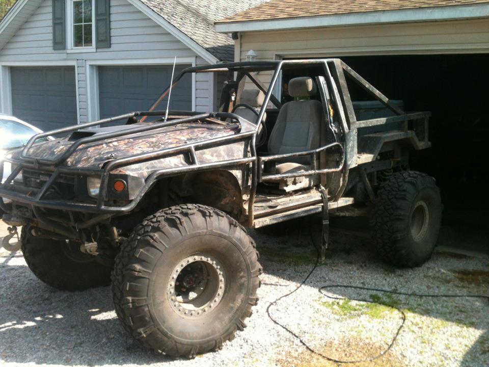

84 Toy Cab, 3.8 Buick V6, TH350, Toyota doublers, Toy axles, 39.5's, Steel beadlocks, exo, steel bed.
-4750lbs on intercomp scales

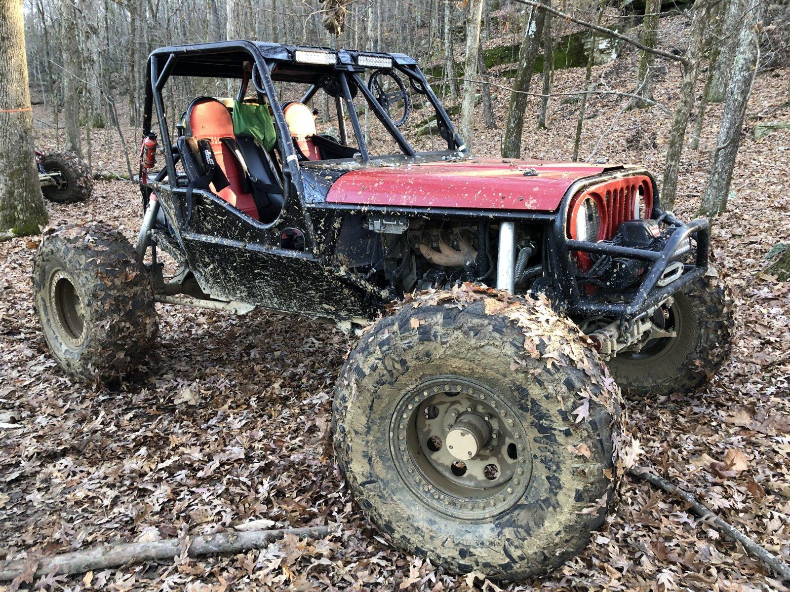

Juggy with frame rail from back of the motor mounts to behind the seats. 6.0 LS, TH400, Atlas 3.8, Dana 60, Dana 70u, 39" Reds, and Racelines. 4100 pounds full of gas (18 gallons), misc tools, and spare fluids without passengers.

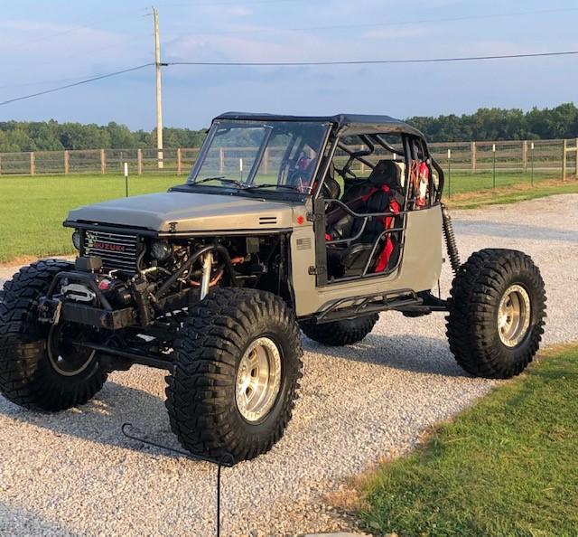

Back-halfed samurai buggy with 1.6 engine, 5 speed with samurai/sidekick doubler, Toyota axles, 40" treps on Racelines.
3,080 lbs with full tank of propane, misc. tools, fluids, and full cooler.

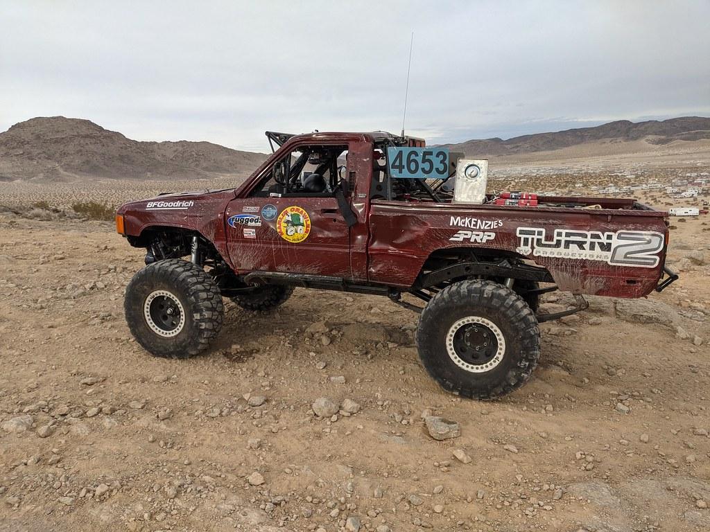

Truck was 4153 lbs completely race ready in 2020. That was including a lot of unnecessary parts, tools and two full propane tanks. The truck will be getting tech inspected by USAC for the 2022 ULTRA4 season. I will post the current weight after tech.
Toyota cab and full frame.
1 3/4" .120 wall DOM cage
22re
5 speed trans
dual t-cases
Leaf springs f/r
Toyota based axles
22 gal fuel cell
35" tires with beadlocks
spare tire
jack
tools
parts
safety stuff
