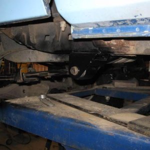

Must have cracked this one when I broke a center pin at the MM race.
Anyone got one lying around?

onetoncrawler said:brace that 205 and you wont break the adapter
only way you can break an adapter is if your inducing torque or bending , both can be solved with torque plates and bracing...
patooyee said:This is true but then there comes a point where it is too rigid to your chassis and cracks when the chassis flexes. Ask draggbody about his. He took out like 3 in one weekend in Harlan one day. I helped him change them out. He ended up having someone make hima s teel one for a good price and he hasn't had a problem since.
