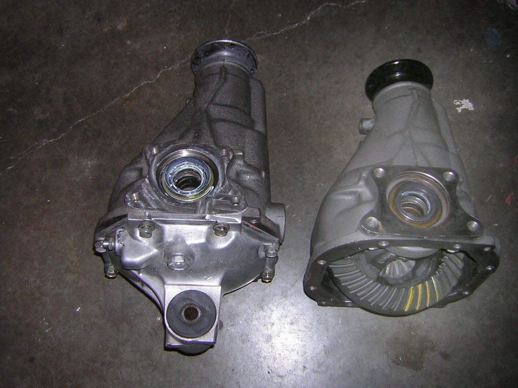

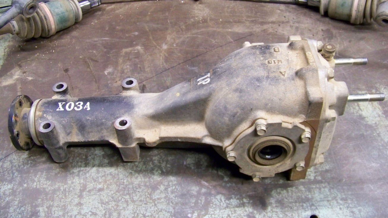

Im not a fan of the Subaru diff for how small the ring gear is and that they are so long. Top picture is the Subaru and the lower is the toyota

Subaru front diff is part of the transmission. The Explorer-Mountaineer setup seems to be the easiest to find cheap.
Yeah but that **** goes boom routinely on normally driven pavement pounding stock junk, although it's not like you are going to put a hundred thousand miles on it, so it might work ok. :dunno:

Subaru diffs go boom.
You can get gears for Toyota its down to 5.29.
1st gen Tacoma ifs is a high pinion version of the older 7.5" diff.

Bad choice of words, I tend to say stuff is blown up when it's really just broke, needs rebuilding ect. We see bearing failure in them and the occasional one that cracks the housing because it has so much (owner neglect) wear the pinion get shoved out the bottom. :dblthumb:
Man subarus hold together well. I see WRX and STIs pushin well into 500s and running low 11s, high 10s at the track then drive home. Weekly. I think they are a pretty tough little set up

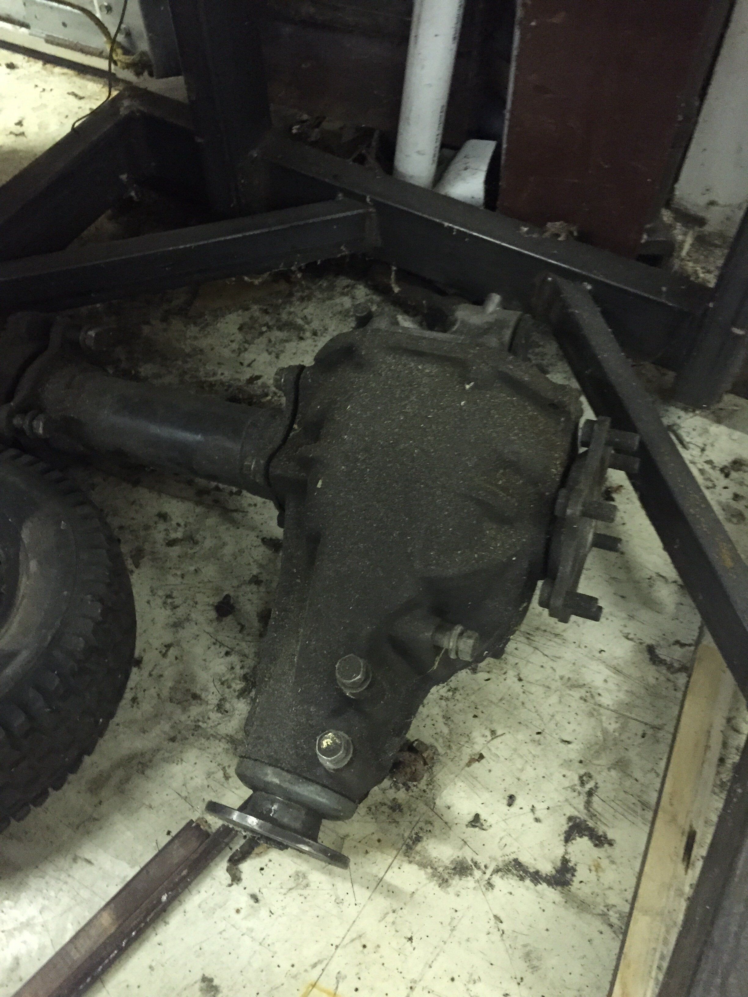

I have these 2 differentials if anyone's is ineterested, I just saved these in hopes of doing a small ifs buggy but probably never will.One is out of a 2007 tundra with a 9" ring gear and 4.30 ratio. The other is a 90's toyota pickup with 4.10 ratio.
I'm going to mill down the long side on both of them and machine for a seal so these can be ran as center mounts

That buggy pictured can't weigh much if any more than 1000 pounds with a driver in it. Theres no need for 1 ton sized gears, a tiny little geo tracker ifs set up would hold up just fine and not be overly heavy.

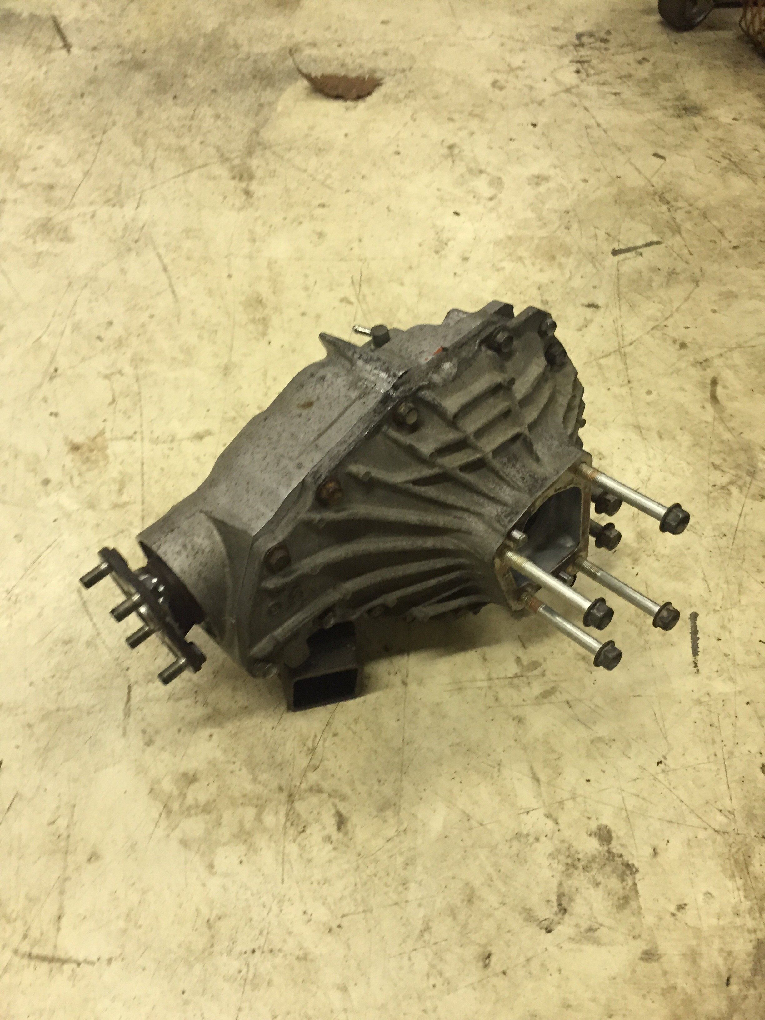

I have 2 nissan 240sx diffs laying in my shop for the same thing. I had a guy working for me last year that was into the whole drift world. He gave me two one had limited slip the other open. They look very similar to the Subaru unit but don't have the long pinion snout. They're between the size of a d30 and d44 diff. Have a flange on either side that accepts a CV and are only like 10" wide face to face. Plus they have a cast iron housing and nice finned aluminum cover. The half shafts that come in the cars are two different lengths, a long side and a longer side but the diff is ambidextrous so you can choose your width by running 2 longs or 2 shorts. Parts are readily available and they're a dime a dozen. The rear uprights are even pretty light and simple so they can be modified easily to use as fronts. They use decent disc brakes and bearings. I think they'll work great.
