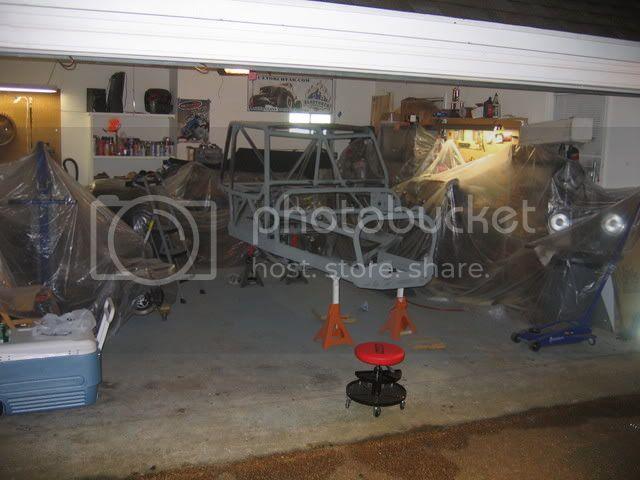

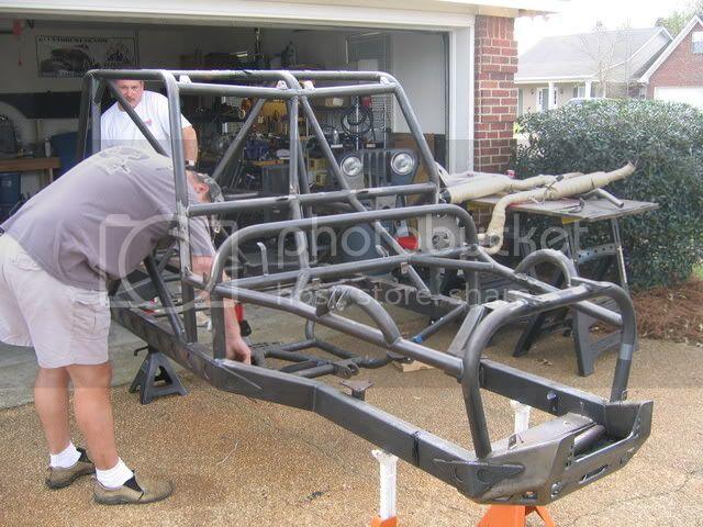

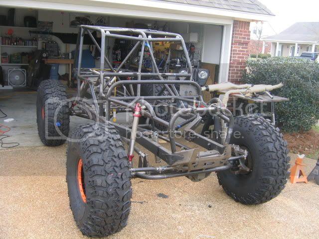

put in some work today....got the car stripped to the bare chassis...
i would like to thank again, and in no particular order:
tweba99
87yjtoy
davids_yj
bigsilly
these guys came over today and helped me snatch the engine & tranny, transfercase, and all other BS on the chassis...
they also put in work on sanding while i did some finish welding on the front axle hydro tube, ram mount, orbital, and a few other little misc. tabs that i had to burn in....
the guys helped me get it back in my paint booth, and left me to put some primer on it...

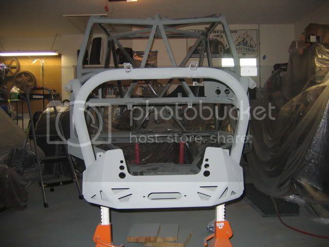

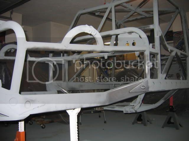

after a 3x wipe down with acetone, she was ready for some primer....i shot it up pretty good...i have 7 cans on it and need a couple more to finish a couple spots...the entire underside is done, so hopefully after a little more primer tomorrow, i can shoot it with some real paint......
here are a couple pix from today....
Man I know it is late in the game but support those front coil over hoops with tube going back down to the frame. You will bend the whole bar the hoop is mounted to. It is not a good place to have a problem. I'm just really trying to help with this suggestion. I have fixed many mounts on buggies just like that one. I believe Cole Shirley had to have his rear mounts fixed that were mounted like this also. Please take me up on this advice.
Right on man... Im about in the same spot, outside of no primer on mine yet and I need to finish a few welds first. thumb.gif
Add the tube as Woodlee said and stay on it ! Lookin good
agreed they will bend in, and I was thinking the same thing when I scrolled down to see your post. what I did on the malvado was connect the towers crossways over the front of the engine to transfer the force (those hoops go all the way to the main frame rail, so less of a worry). I think the down bar you describe is a good idea.
