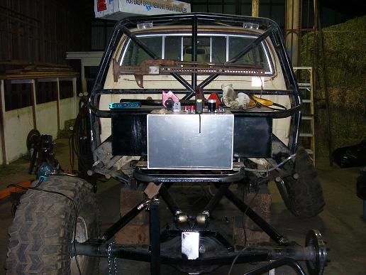

Fullywrecked said:Looking good. you going to get the links cyro'd and chrome plated?:redneck:
heat treated and and 24K gold plated, gotta get the bling bling baby:redneck: .

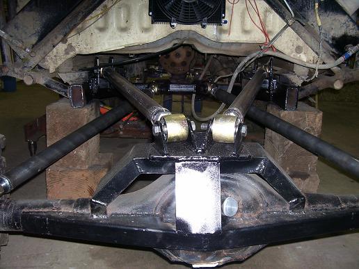

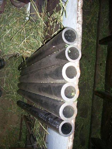

no excuses said:beefy :redneck: , 2.25"x..375" lowers and 2"x.25" uppers.![]()
Jobless said:They'll bend...especially the lowers :redneck:

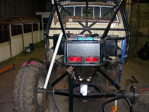

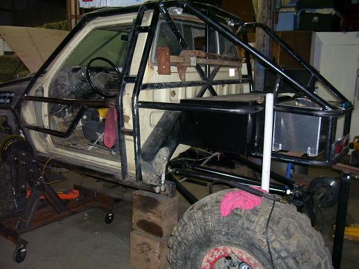

rooinater said:i'll keep the pvc in mind for mock up, when i do my 1/4 elliptical rear.
no excuses said:probably :redneck: and they do not help it lose much weight:wtf: . Was thinking of going with 2.5"x.5" but figured that might be a lil overkill:wtf: :flipoff: .

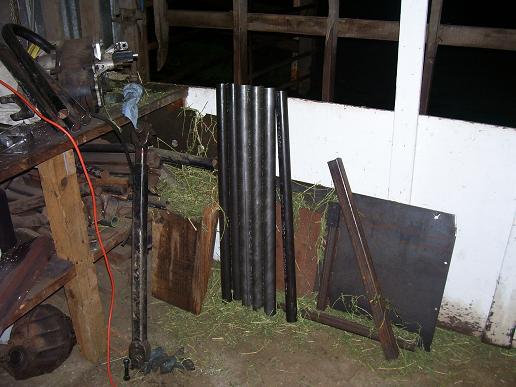

TMFabrication said:Looks good, but how do you keep the hay from catching on fire when you're welding or grinding?

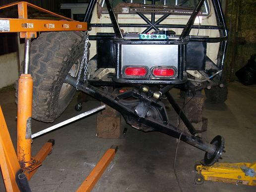

Tankota said:Why not just use some dana 44 axle tubes?:redneck:
That's about all they are good for![]()

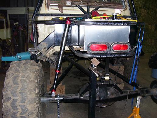

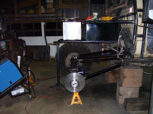

Jobless said:Move the shocks out as far as you can so they will not rub the tire during suspension movement. Mount the top angled in and forward a few degrees.
