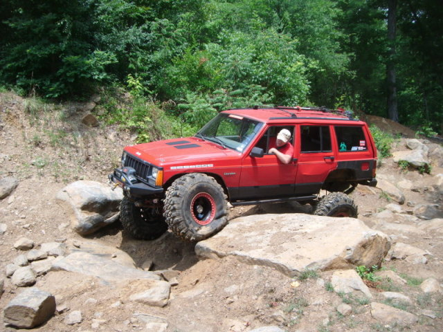

Been a while since I updated this. I beat on the jeep a bit more. Finally broke an axle shaft and decided to stick to my guns and not sink a penny into the stock axles. So I sold the 44/60 combo and decided to find an 05+ sd 60. Found one with 4.10’s on the cheap. Now I’m hunting a 4.10 14 bolt. I’ll regear eventually. For now I’ll just run it and deal with the lack of power
I’m going to reuse the stock sd brackets as Paradisepwoffrd suggested. For now though I’m going with the ruffstuff radius arm kit. It was on sale 25% off for Black Friday and I jumped on it. I tried piecing it together for less and couldn’t get close.
Can’t wait for New Years ish when I’ll be taking it up to Eric (Bronco72). I’m going to let him set it up for me. I trust his welds a lot more than my own.
Coming right along Luke, I'm still hunting for some tires for ya, I'm not sure what the budget is for wheels and tires but someone on here threw up a set of TMI bead locks I believe.
More than likely tires and wheels will be on hold til after I sell mine. Which I hope to happen after I list mine. Which theoretically will be as soon as I drop it off at Eric’s with nothing underneath it. Whatever mine sell for will be what my wheel and tire budget is. I’m hoping for the $600 range. Shouldn’t be too hard since my tires are dang near brand new.
I’ve seen that eb do a lot of donuts. It’ll hold up to following Tony on the access trails.
Thanks for the crane Selvy! That works way better than winching up a tree!
Started the swap today. It’s up to Eric now. I’ll probably be competing against TC, burkey and all those other guys next year.... hahaha
It’s coming right along. Eric is knocking this thing out. He does some dang good work. Rear end is in. Front end is mocked up. Lincoln lockers installed. Sye is done. Master cylinder is swapped out for a dodge 3500. Still gotta knock out unibody stiffeners, hydro assist, driveshafts and a few other odds and ends.
Better plate the unibody where the pan hard mount is. (Probably planning on it anyway)
