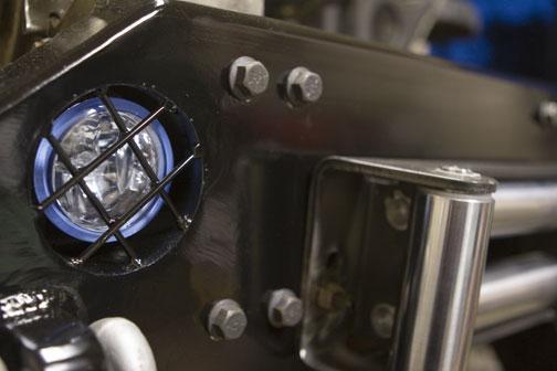

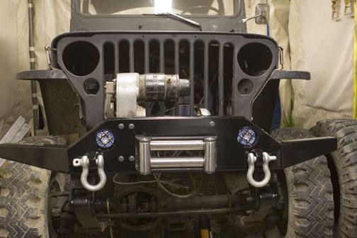

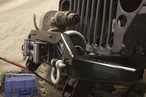

Well getting a little closer to the front being finished. Probably got about 2 more hours of fab work to finish it all off (front x-member to make & steering box brace)
here are a couple more pics of the current progress...

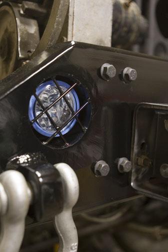

The first pics are of how the front bumper is looking now, and the last couple are of the lights that I inset into the bumper.
I added some round stock in front of the lights to help with protection, and also to give it a little something extra in look and style.
I also added the 1" plate pieces (6" long 2" wide) through the front bumper welded on all sides and onto the frame for tow points. They are set up and drilled for 3/4" removable shackles.
Hope you enjoy the shots.... soon the back will be getting the work and then it is up the ramp we go...
