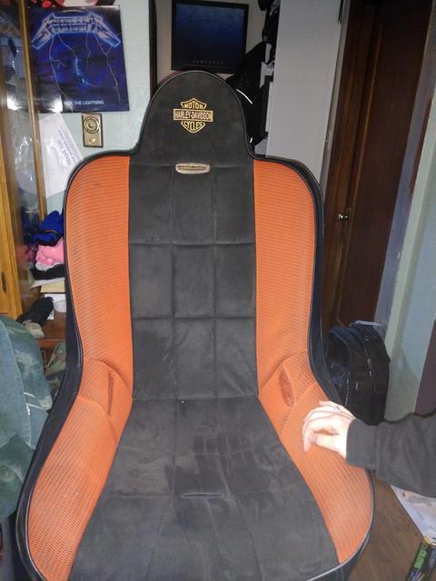

got seats at the moonshiner's swap meet this last weekend
4 bills for the pair.
krunch had prp seats in it before, but I don't know what steve did to the seat mounting for his el cheapo seats

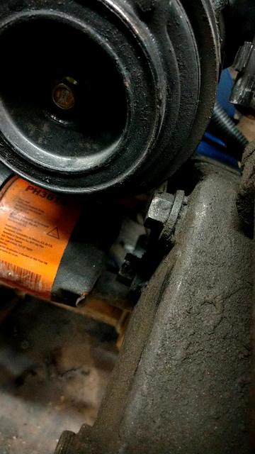

The ls400 compressor top plate isn't going to work so well.
So I'll either change out the top plate, just stick a shipping plate on it, or see if one of the other variant's compressors will work better.

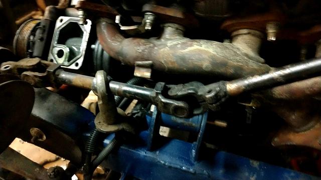

There's not a lot of clearance for the pulley either. May need to swap out the clutch for something else if I can't make the room for the steering bolt.

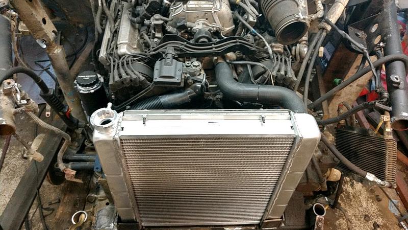

I have a universal "drag race" radiator and a spal fan inbound.

Had to make the hard choice to go Hannibal Lechter on 'er
needed a little clearance for the radiator/fan

Got my steering wheel disconnect. It's a damn empi part. Gotta adapt to my steering wheel (omp)
So I ordered that.

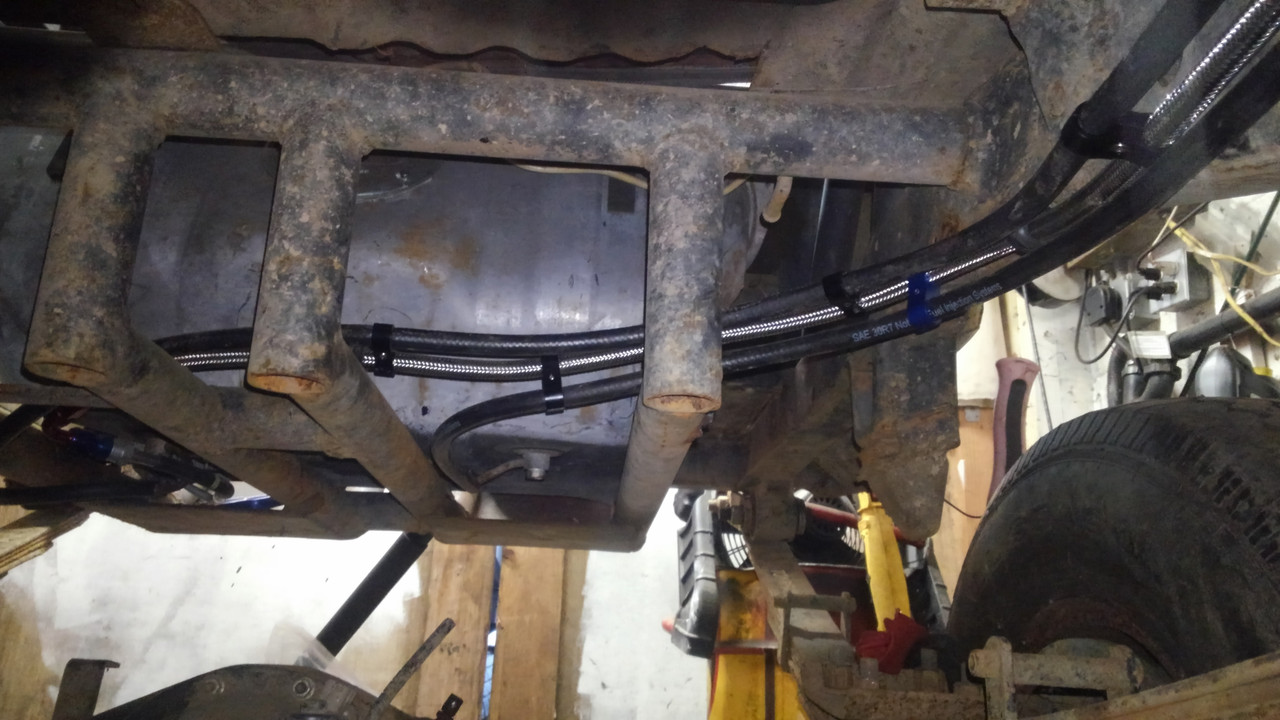

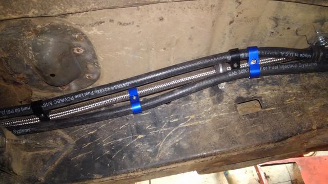

More AN Clamps showed up. I'll need one more pack I think.
P.s. pressure Hose is on
