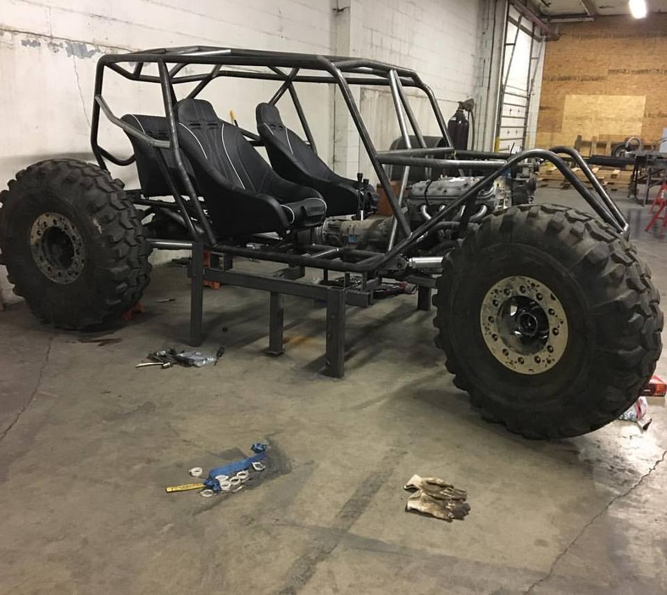

LARGE MARGE 4 seat build

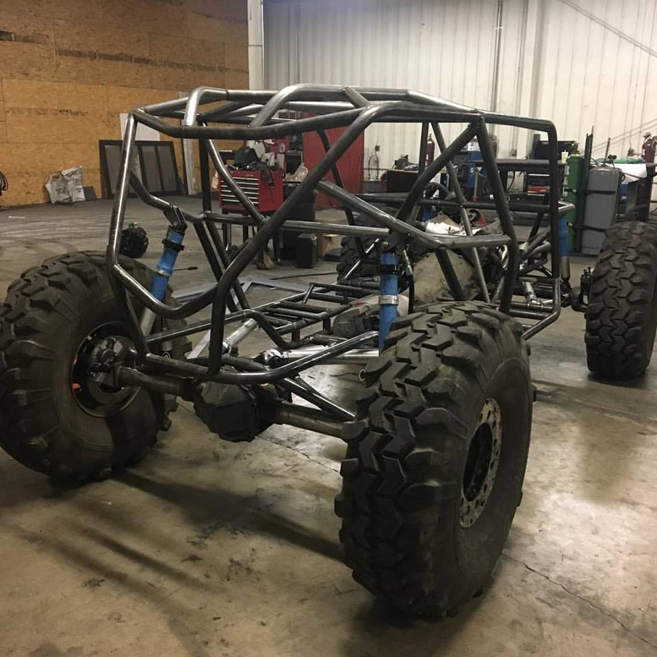

7 piece roof line looking good

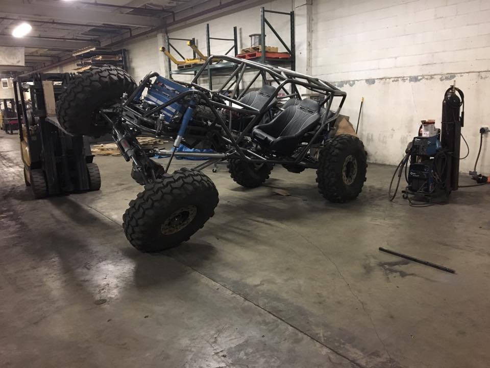

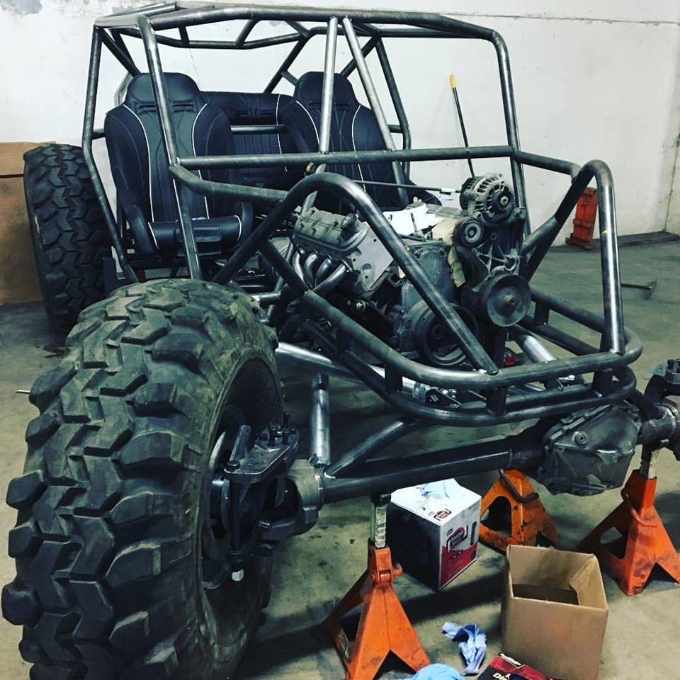

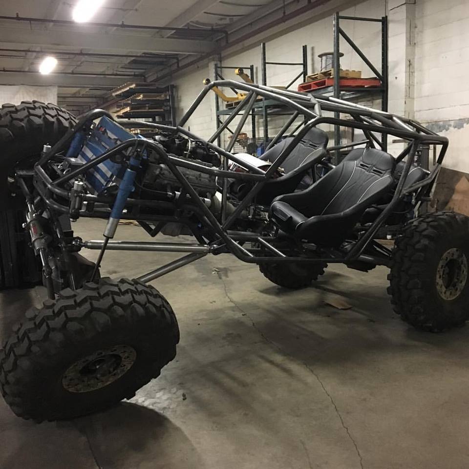

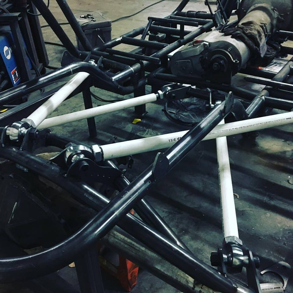

links are mocked up and machined and back on with 2.5'' 7075, didn't need to go that fat but hell with it its large marge, got my disc brake conversion on and was able to finally bolt some wheels on and start mounting the coilovers. can't wait on a serious mission now.

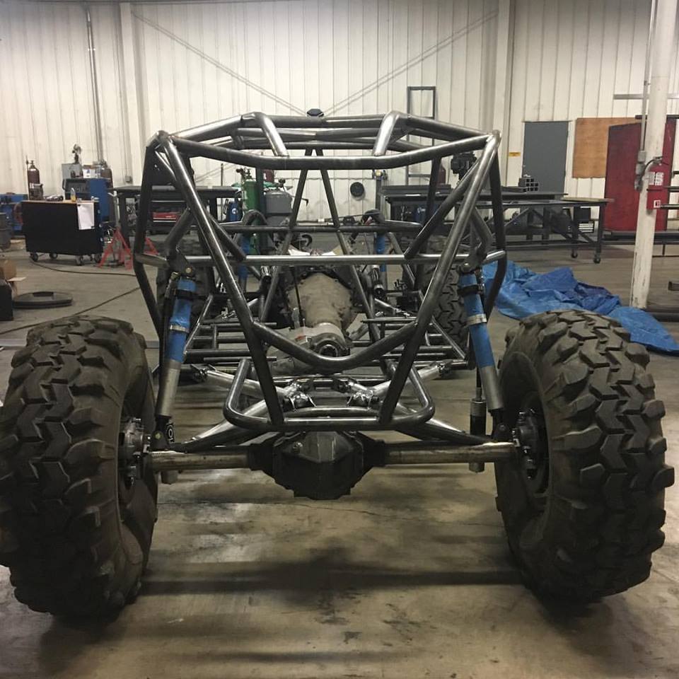

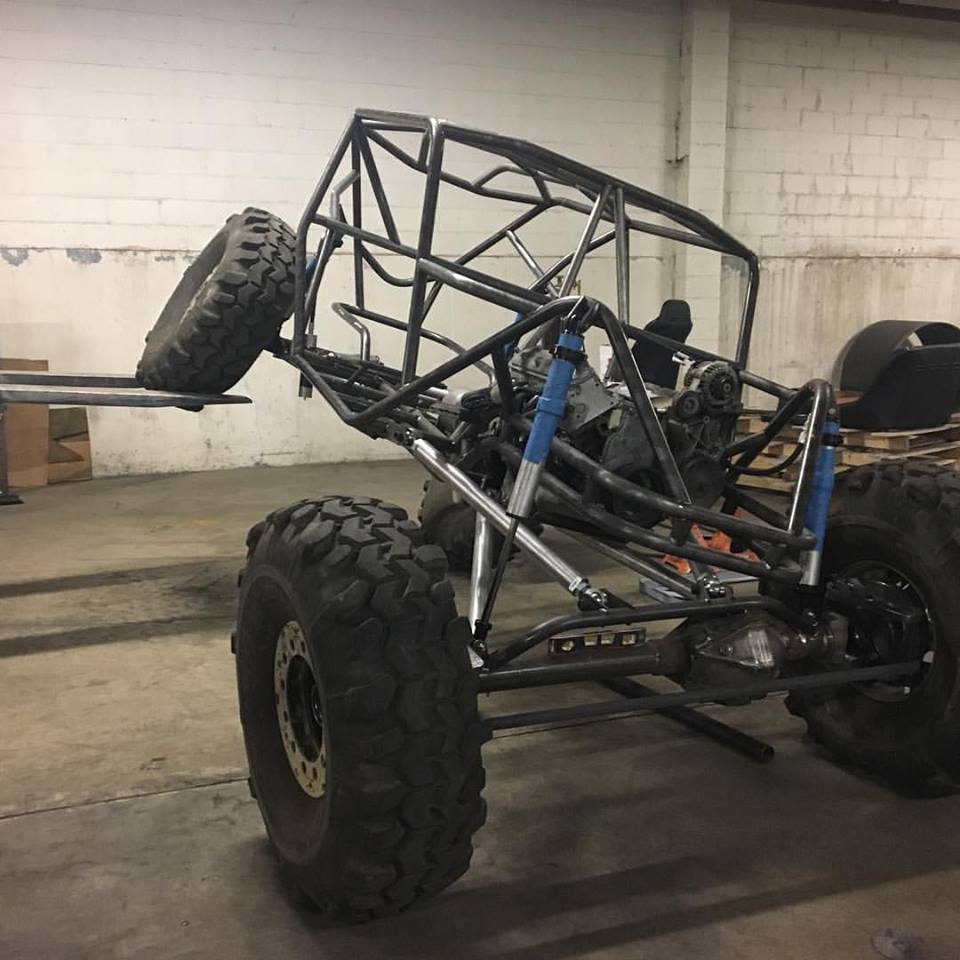

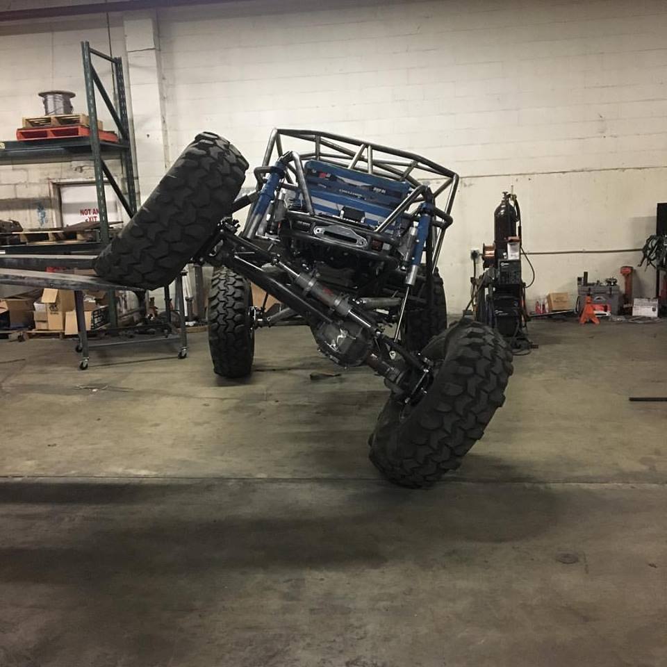

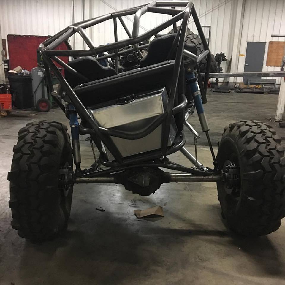

made some more good progress over the last few weeks all the links and shocks are on and everything seems to work great so far working on mounting the sway bar. i've had to adjust a few tabs here and there everything is pretty tight specially with the back seat. I also found out that the coilovers I bought are 14'' and not 16'' like the seller said, was pretty pissed about it but since I built everything around these dimensions I couldn't get any more flex even if I swapped them out. On the optimistic side I've got over 44'' under the tirel when its maxed out which is pretty freakin good. word to the wise even when buying from people you know either look up part numbers or do some basic math and make sure what you think your getting is what it is.

shes getting there slowly sway bar is mounted and broke to fit around seats steering is mounted everything seems to be functioning and clearing.

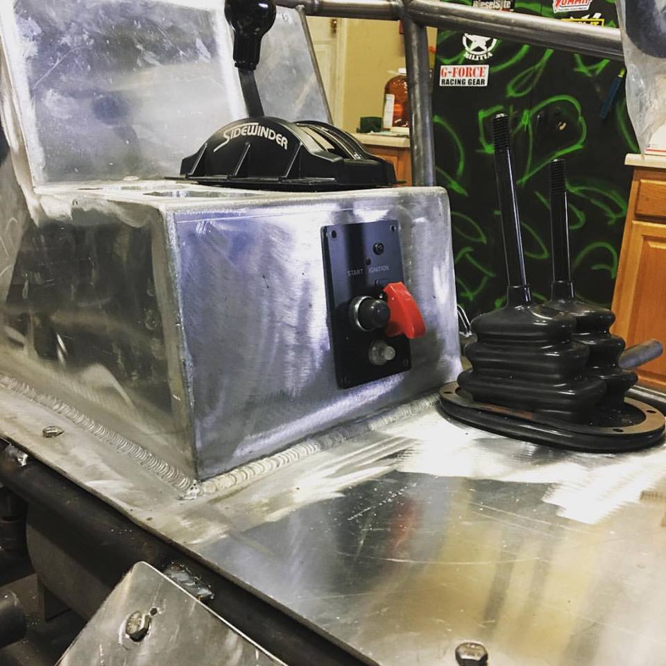

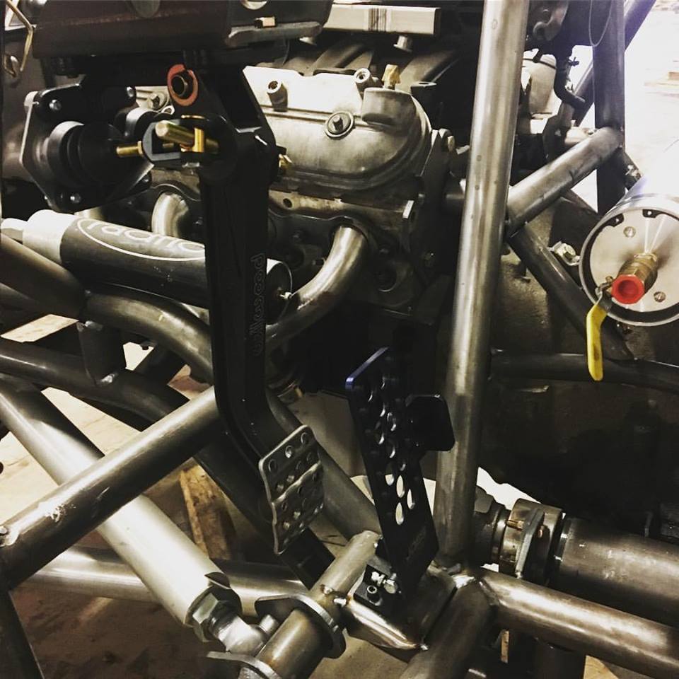

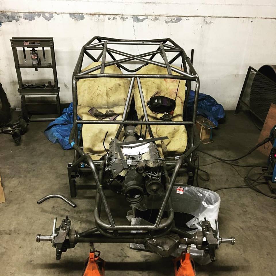

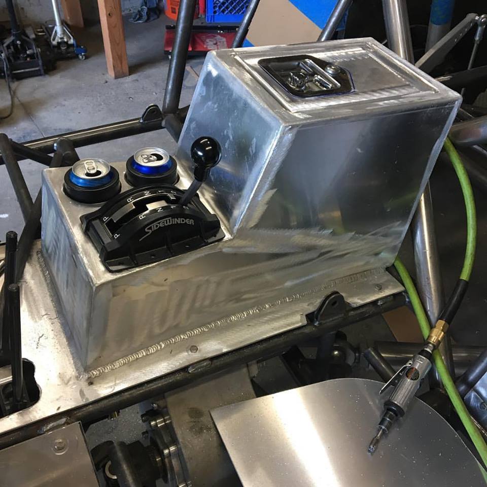

got lots done but not too many pics everything was mocked up and I just tore it all back down to finish weld. took it out of my shop and back home to get more time on it.
