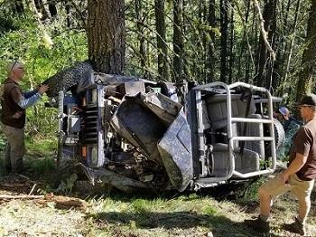

I'm hearing a family of 3 went off on the stair steps, mom and daughter were ejected but sustained the least injury, driver was in bad shape, and believe 2 of the 3 were flown out. Rig recovery efforts today.
Was staying in town right where the responders were staged. It was Shindig Wheelers club. Pretty much as stated above, family of three, the teen daughter was ejected and sustained (relatively) minor injuries, I believe her arm was broken. She was brought down by jeep and transported to hospital. The woman sustained multiple fractures, I believe a broken pelvis. She was carried down on backboard and brought down on a UTV, then taken to airfield and flown to Harborview. The driver was airlifted off the mountain with serious injuries, including possible head trauma.
Apparently the roll was fast and violent and rolled a long ways down the hill. Possibly caused by a rear driveline failing. People who went up to assist reported that the cage was mostly intact. The rear passenger was ejected when the seatbelt broke.

It was caused by the rear u-joint straps and small bolts breaking on a nasty hill. The driver and person in the back seat stayed in and rode it down. The passengers seat belt broke and she was thrown out, The seat belt is still latched, The webbing tore. The passenger as bad internal injuries.
