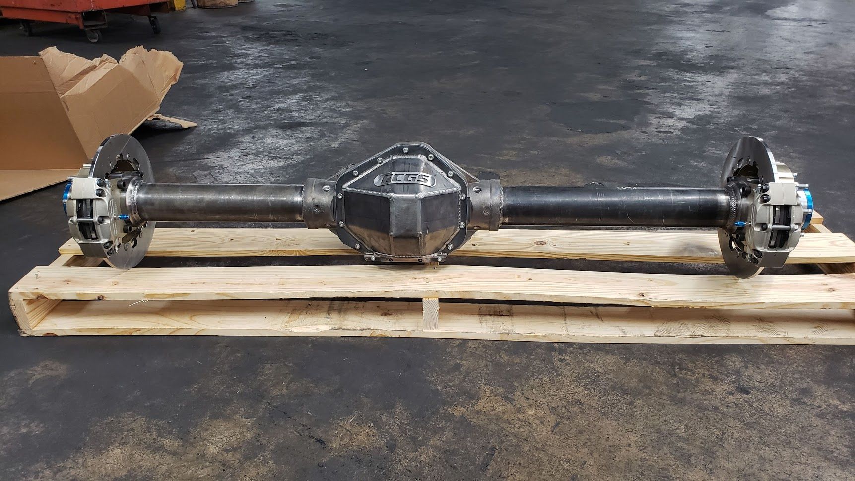

Axle is here but shafts won't be until next week. Ya'll have fun, tell Zach to text me if you need any trail recommendations. And post back with a report on the cooling.

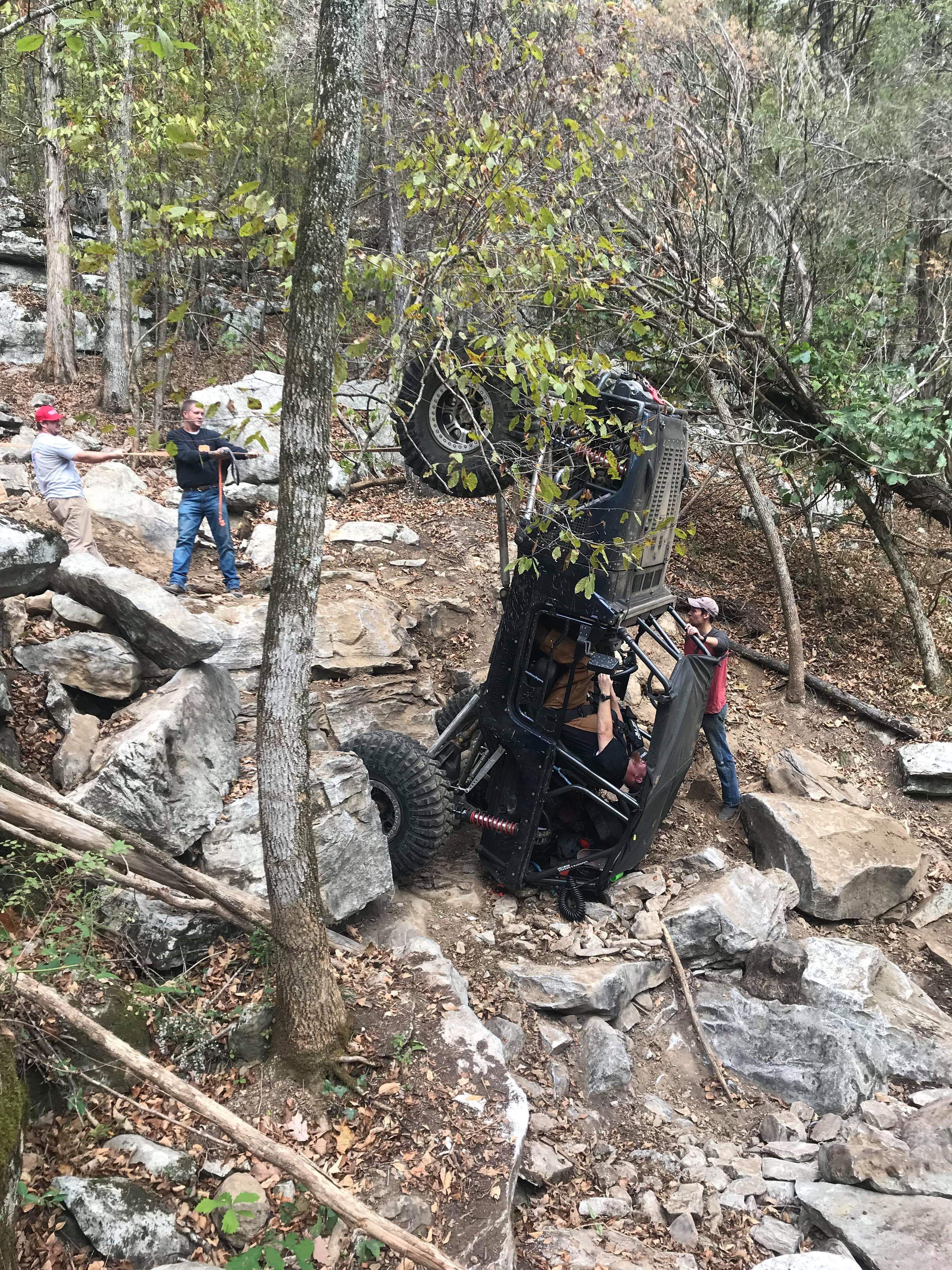

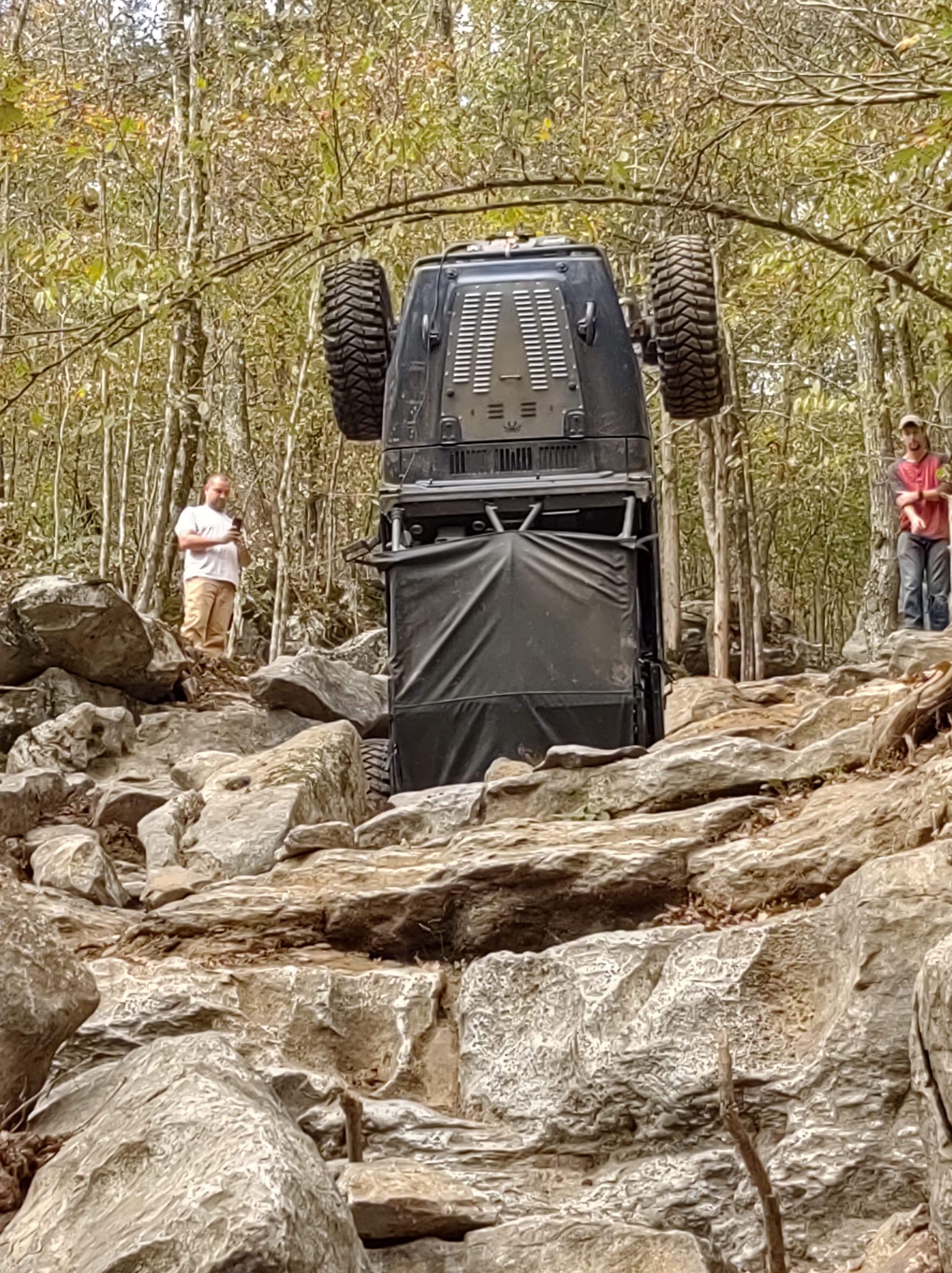

Temps were much much better! Spent most of the trip around 180-185 and it seemed like it took a while to even get up there. I never saw anything over 205 even when beating on it for prolonged periods. I'll have to wait a while to see what it does with elevated summer temps, but as of now I'm pretty confident the problem is solved!
We had a hell of a great trip. Creampie and Little Caesers are bad ass and definitely a couple of my new favorites!
