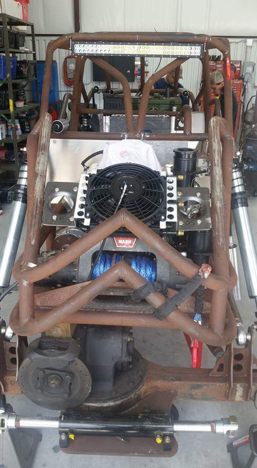

my mistress buggy build
halcat said:
You will love that steering cylinder. I don't know if I would trust that mount tho. PSC clamp will fit it for a double mount. My .02
Ya I called psc awhile back about ordering some clamps but they weren't very helpful cause it wasn't a psc ram but I need to measure it and order some then thanks for the info.
No need for clamps. Just weld some small flat bar just inside the mounts themselves. This will take the load off of the bolts. I've had zero issues out of mine that way on 44s. The bolts will then just basically be holding the ram down.
OK great thanks for the advice
It's not the bolts I was worried about. The mount is welded to the thin wall cylinder right at the end (seal area). Without it being clamped from the top, I thought it would distort the cylinder and cause a leak. I guess I worried for nothing.

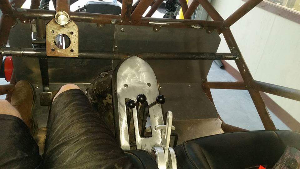

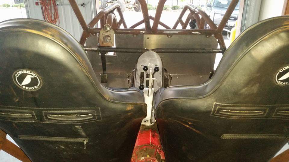

Yes call the guys at mad 4x4 outpost mine will show up today it looks bad ass. I'm running an art Carr from my old buggy but it's too bulky for new one so went this route.
Okay I need some help on where to mount my rear steer joystick any pictures ideas would be great don't have too much room and wanted to be easily accessible here is a pic of the dash and what I have so far

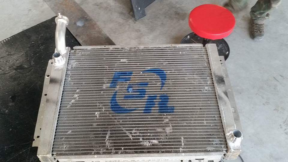

Radiator finished up and dash mocked up

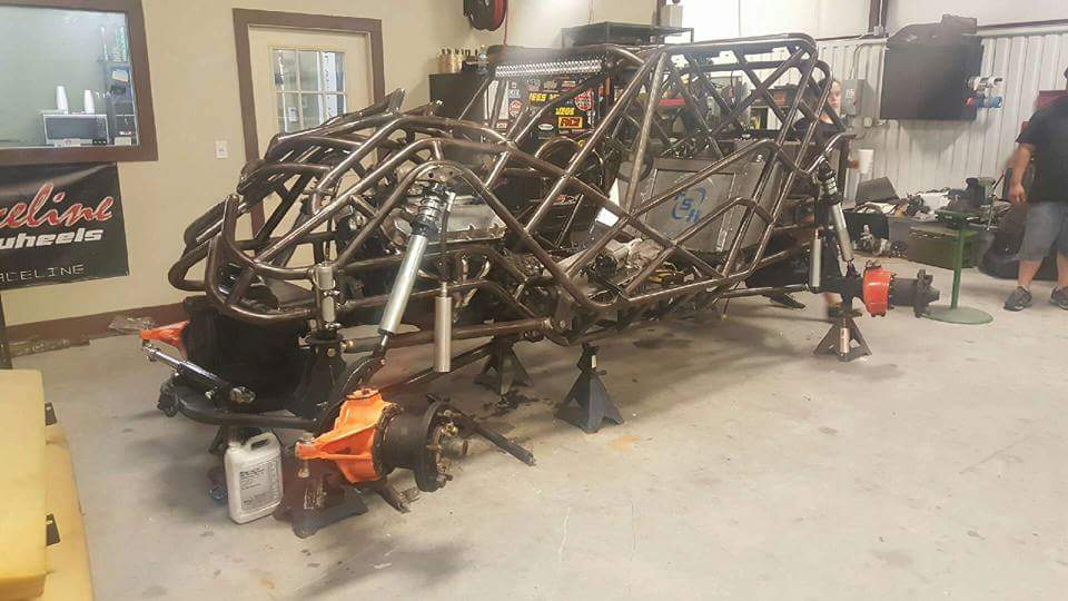

Little more work done getting closer
Few more pics

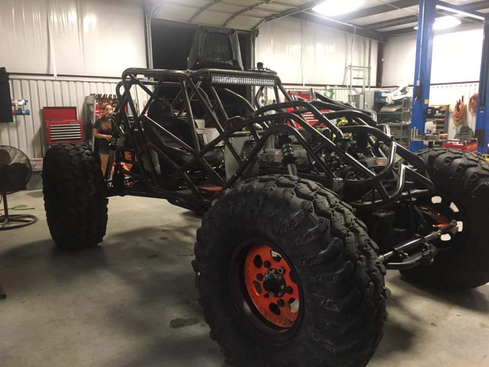

OK haven't posted in a while final assembly began
