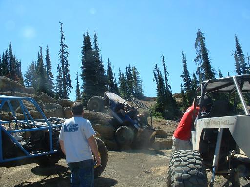

Once we were at Moon Rocks, we were attempting to climb one of the rock faces and it kept dying under the load, so we back off and found this little beauty:
As soon as we got that wrapped up, we start to head over to the other side of the rocks and loose stearing :wtf: Turns out that the pin for the hydraulic ram had fallen out... after a few minutes of trying to come up with a solution, I suggested using one of the hood pins:
At this point we decided to just park the damn thing and watch everyone else for a little while:
