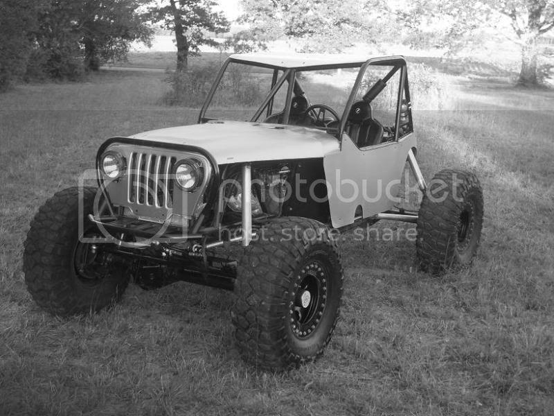

a little update
I have been pleased with the buggy so far = 3.0 and 5.13s is the perfect gearing . wish i would have made the chassis a little different (cab room/proportions) but it looked a lot different in the shop than it does on its tires :****:

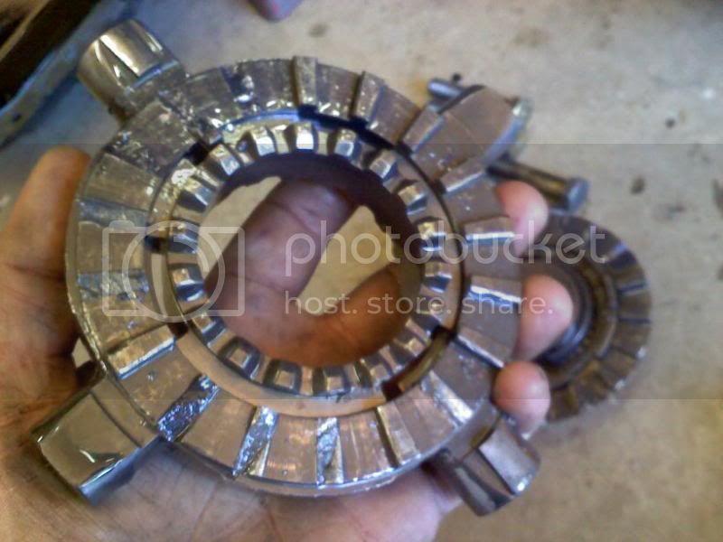

had a couple of bummers but nothing too bad - broke the front detroit and a dana 70 rear shaft..Chromolys in the future
deffinitely going to upgrade valve bodies before long..shifting into 2nd and 3rd at just the wrong time sucks
buggy is currenty stripped of its skins and interior panels for a little adjusting and a color splash..back together for the Halloween ride
