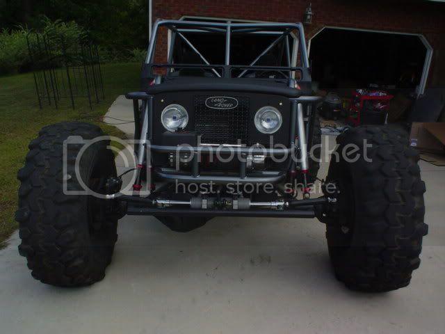

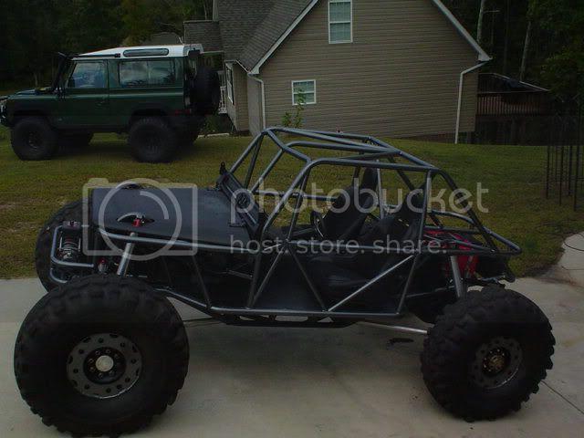

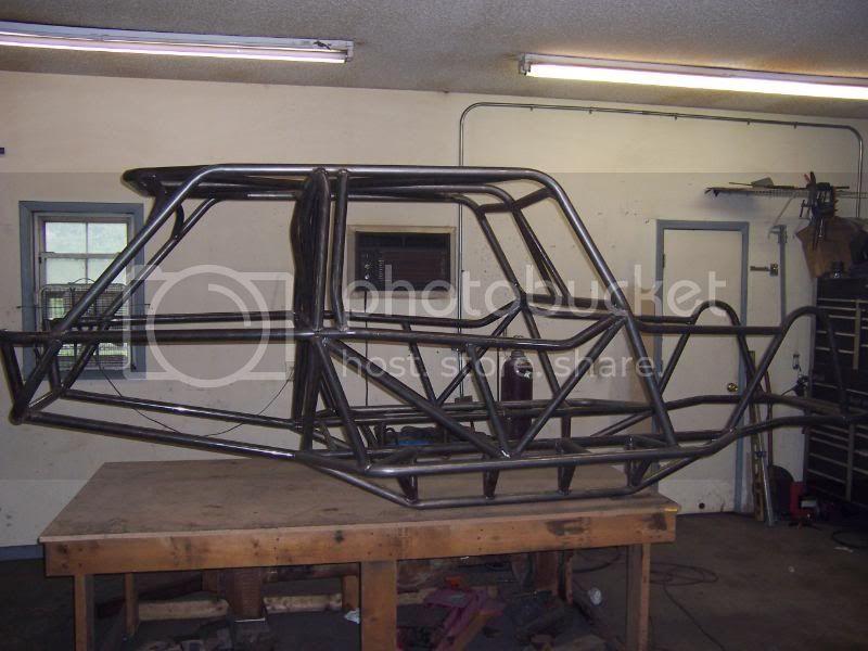

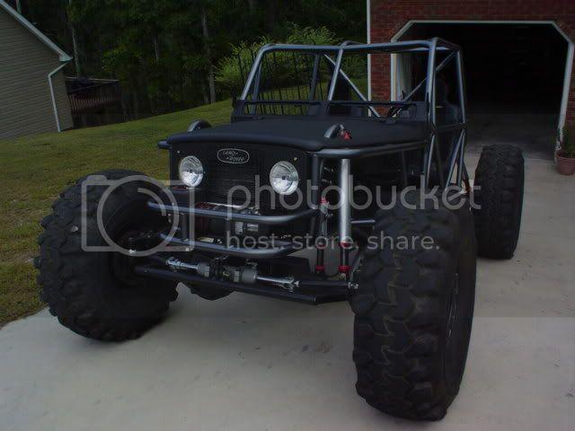

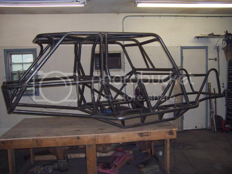

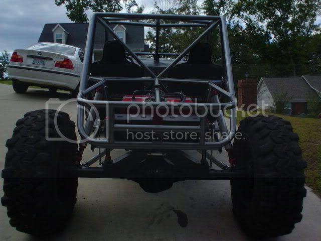

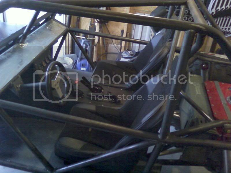

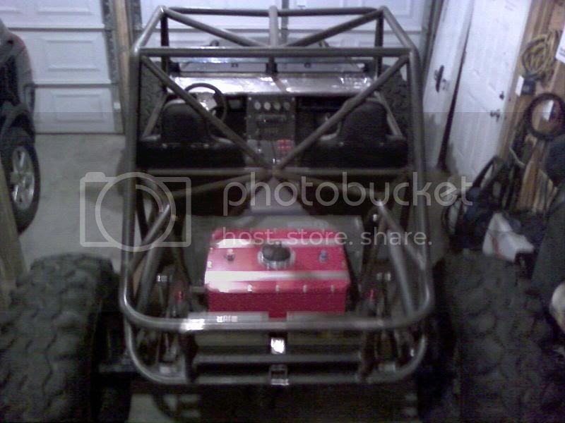

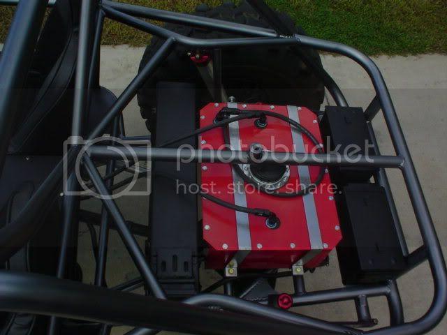

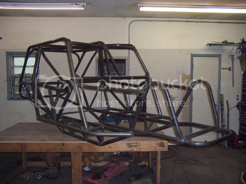

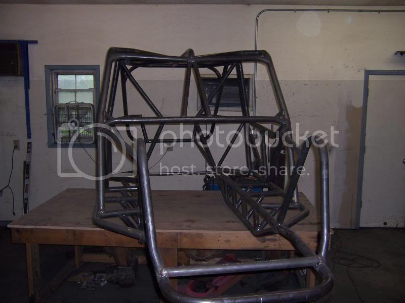

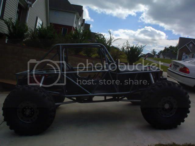

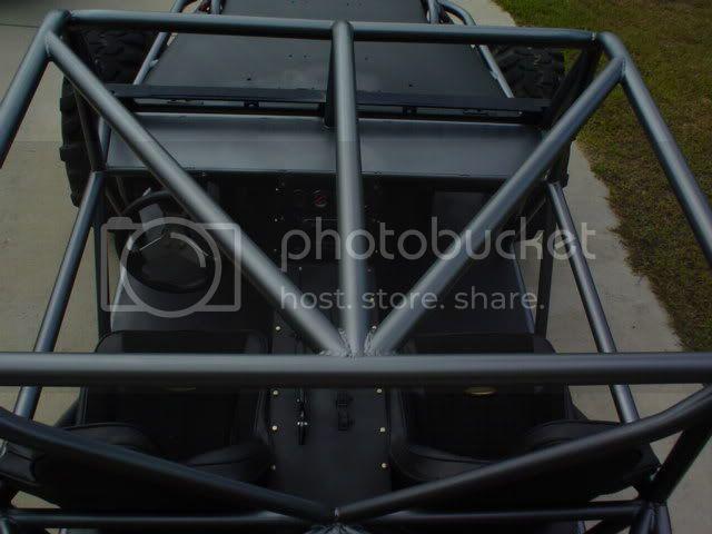

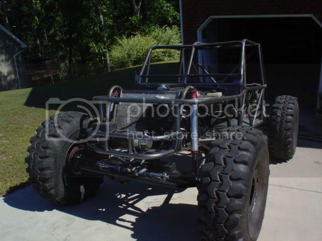

The engine is a Land Rover, rest of the goodies;
Tube- 1.5" DOM 180 wall lower chassis, 120 wall upper chassis
Engine- 4.6, electric fans, headers
Trans- ZF 4spd
Transfer- LT230, twin sticked, internally modified solid difflock shifter
Dana 60 rear- 5.86 gears Lockright, Dutchman 35 spline axle shafts
Dana 60 front- 5.86 gears Lockright, Dutchman 35 spline axle shafts
Steering- PSC double ended 8" ram, tc pump
Sway-a-way 16" x 2.5" air shocks
Sway-a-way 2" x 4" bump stops
Ballistic Fab Diff covers, Beadlocks
