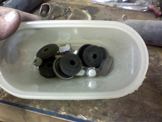

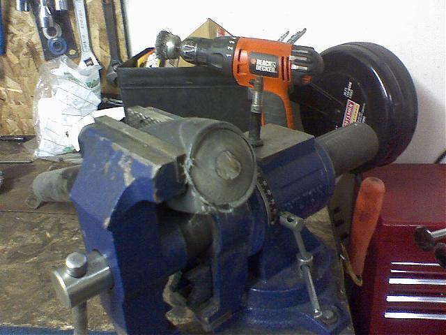

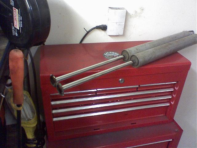

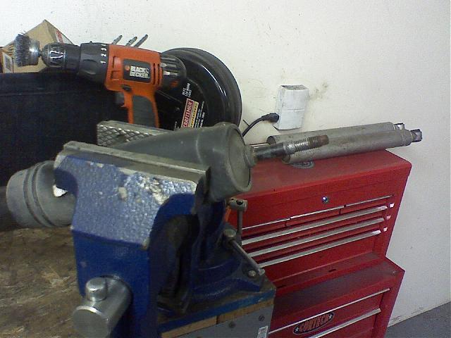

cut off the bushing end of the new shocks.
cut off the stud off of some old cherokee shocks.
scored on the washers and bushings also.
welded the studs to the new shocks and painted them.

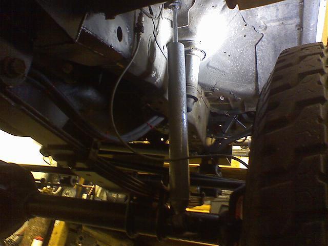

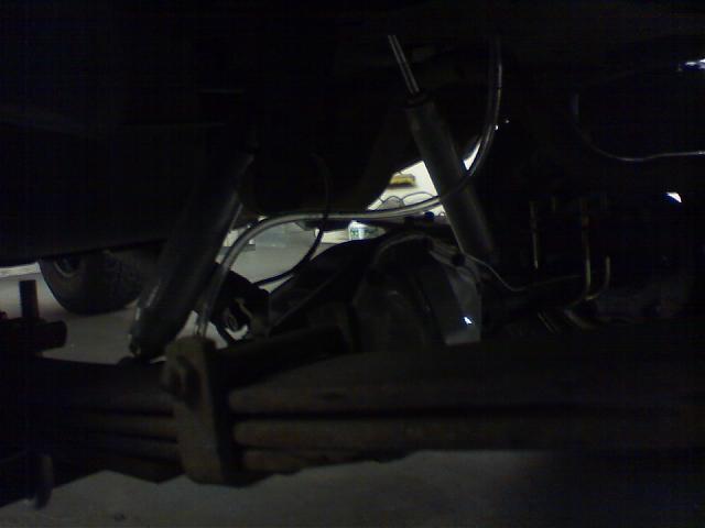

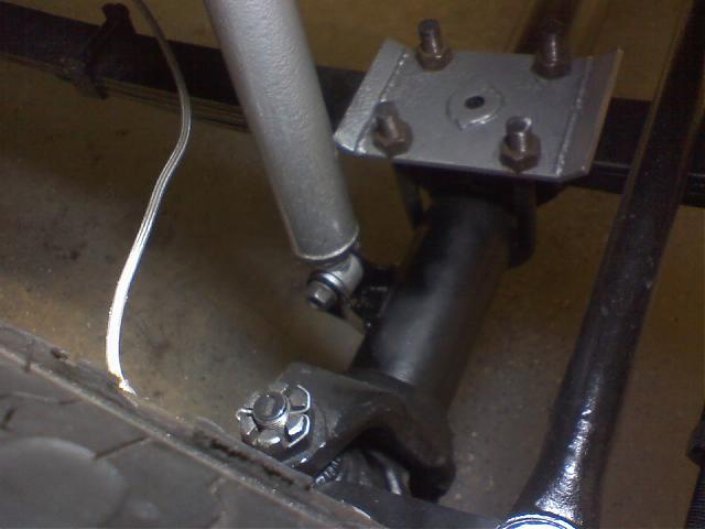

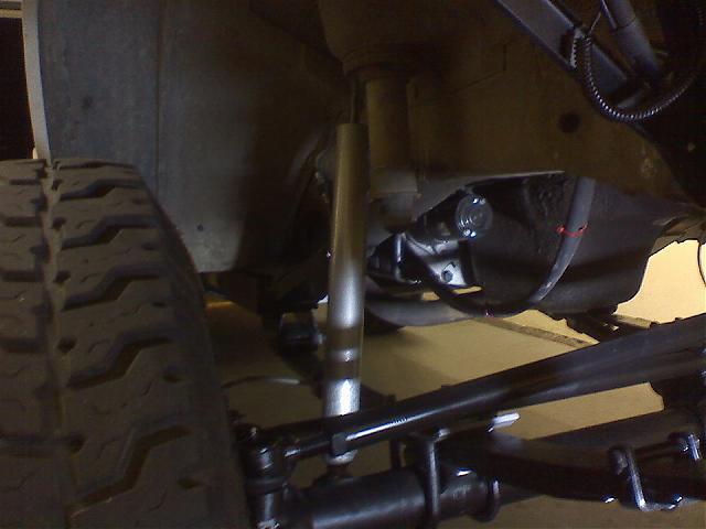

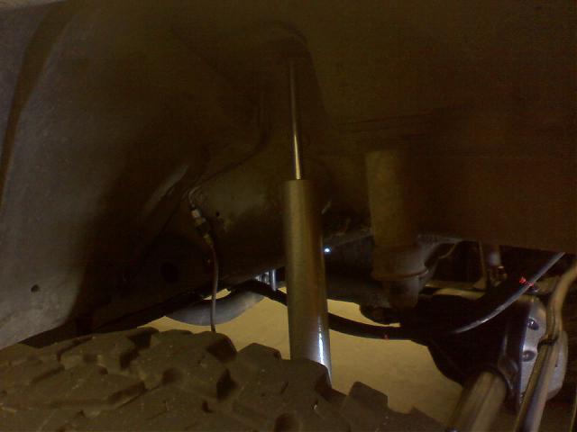

Mounted Front Shocks
Hope this is right...had no way to flex the Jeep to check for compression and droop....
Used some old shock mounts cut off a toyota.
the shocks have 12 inches of travel....5.5up and 7.5 down...if it doesn't work i'll just have to cut the mounts off and try again.

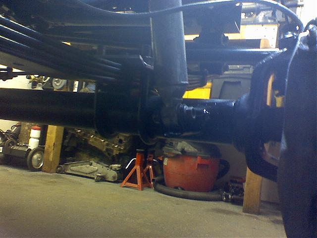

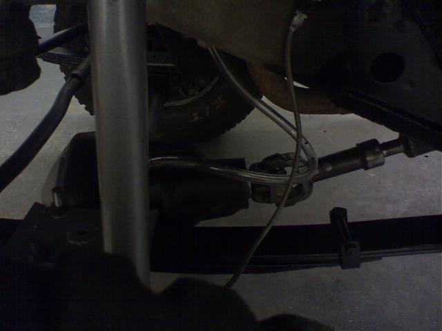

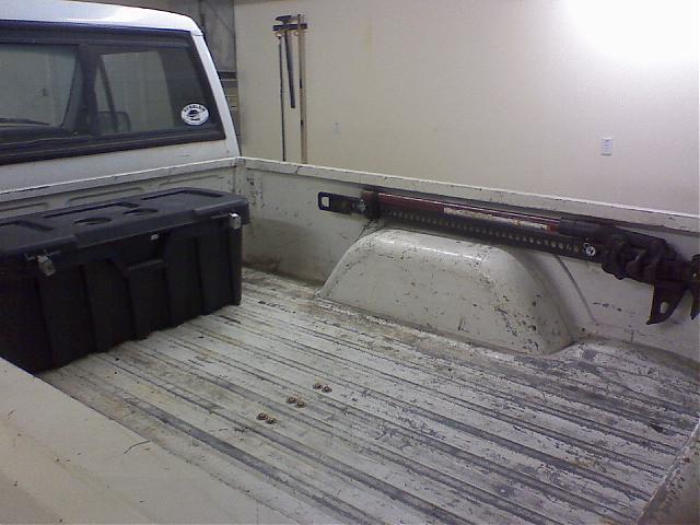

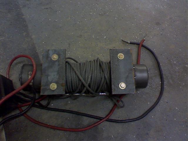

Got the highlift mounted, used cotter pin bolt with multiple settings and a bushing on the back side to keep from rattleing.
Got the tool box mounted, robbed from my cargo trailer, figured it would be more usefull in the Jeep.
Got the axle breather hoses on, used 3/8I.D.9/16O.D. vinyl hose, rated at 175degrees....clear so I can see if anything nasty gets in there.
Also, got the draglink adjusted so my turning is even both directions and so my steering wheel is straight.
and....got the tranny lines mounted in 2 places to keep from catching on anything and to keep from rubbing on anything bad....
LETS WHEEL!

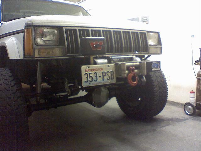

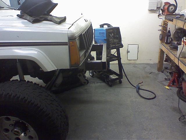

Winch bumper and winch
Got me a winch and made me a bumper the night before the shake down run.:stirpot:

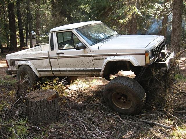

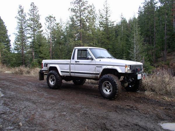

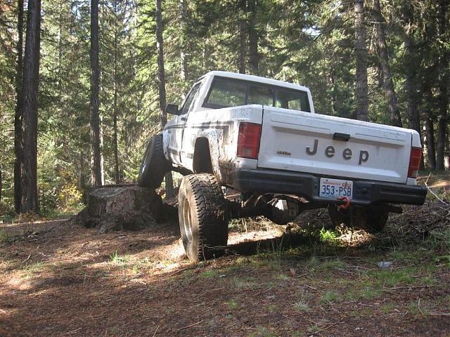

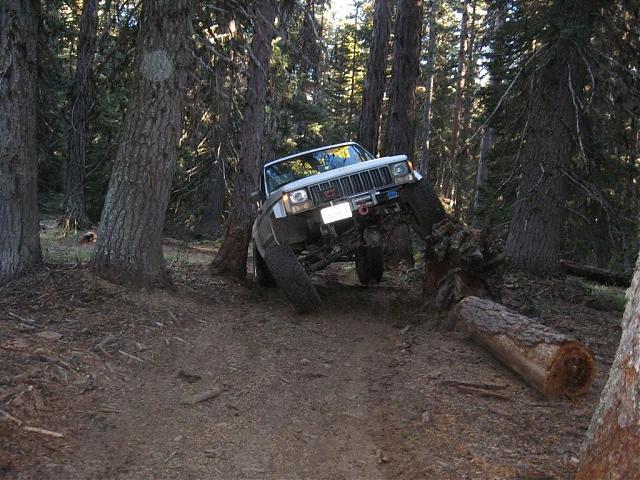

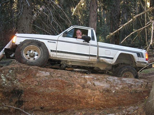

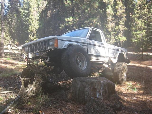

and everybody says leafs don't flex well.....
that stump is about 4ft tall on the trail.

The comanche leafs in the rear flex out pretty nice, huh? Aaron's is like that too. I dig.
Too bad I wanted to ride shotgun a bit today at Liberty, oh well next time. :cool:

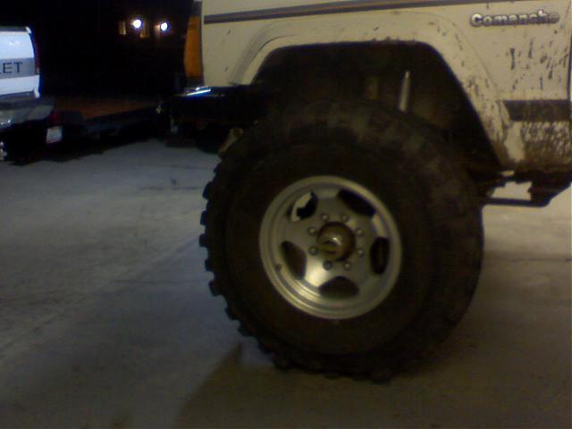

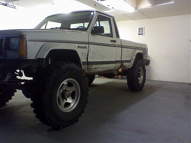

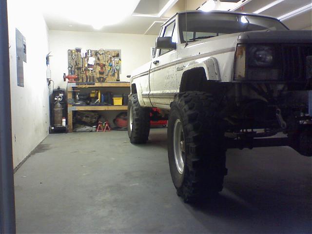

oh yeah...despite on how shitty the BIG O BIG FOOT'S are and how bald they are.....they actually did pretty good!
traded a buddy across for some 35.5 swampers on a 16 in wheel because mine were 16.5's and I couldn't air down enough because I was afraid I would break a bead. Plus they are narrower and the MJ will fit better on the trailer....as far as tread, that are pretty worn but the whole swap is better for me.

Who cares they are swampers with side lugs. Buy or borrow a tire knife and make some more tread haha. It looks alot better with the new wheels. Very cool build youve done.
That was my thoughts exactly! Thanks for the comment, I appreciate it, alot of work in a short period of time....now I need a cage and some protection.
