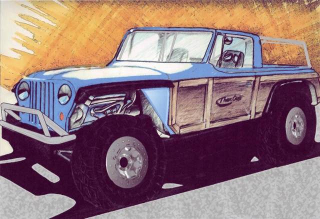

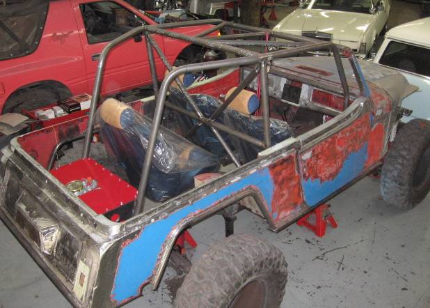

Some of the guys and I at the shop started this a couple months ago and plan to have it ready for EJS this April. It will be a multi-purpose rig, for trails & rocks (not going to see it on BYS anytime soon), go fast, show, media, advertising, etc.
Specs;
1967 Kaiser Jeepster with CJ3 grill and hood (from previous owner), front of hood dropped 3", high clearance fenders in hood, smoothed firewall, all shaved, windshield laid back, molded rear gate, molded rockers & rear bumper, paint will be Toyota Speedway Metallic blue with real Oak woodgrain siding
Tig welded 2x3" framerails, tig welded 1.75 & 1.50x.120 dom cage
mild chevy 350 w/ AFI polished MPFI, th350 to clocked dana 300
Tom Woods drivelines
32 Gallon RCI fuel cell
Spidertrax Spider 9" w/ Ultimate 60 knuckles, 35 spline & detroit, Spider 9" with spool rear
Trailready 17x9 beadlocks w/ 37" BFG Krawlers (blue for driving, red for playing)
4 link rear, 3 link front utilizing Ballistic Fabrication brackets, tabs, mounts, inserts, joints, etc
14" remote reservoir coilovers front & rear (mfr. undecided)
4" air bumps front & rear (mfr. undecided)
PSC steering components
3 seater via PRP's newest seat, the "Velocity" w/built-in camelbacks
Crow harnesses
Superwinch ep9i with Winchline rope & fairlead
7" color navigation w front & rear cameras, intercom system w/ iPod capability
Yes, there is more work to be done,
Yes, the cage needs more tube,
Yes, it will get done on time,
Yes, there is probably things I have forgotten,
Yes, they are crappy pics

Couple new things showed up today,
Two Spidertrax Spider 9's and Spidertrax Ultimate 60 knuckles, we will be using 35spline Ford outers with 14" Wilwood rotors and calipers in the front, 13" rotors in the rear.

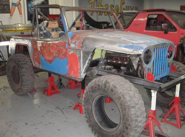

Down to a few weeks left,
front axle is cut down and ready to be built, put back in, brakes showed up, rear axle is in, got it wired today, floors started, just a bit more to go :rolleyes:

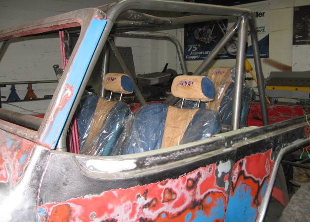

Down to 4 weeks to go to have it in the Those Guys/ Winchline booth at EJS soooo,
Today got the major portion of the front coilover mounts done, front air bumps mounted, steering done minus the orbitall and lines, and started on the rear coilover mounts and rear air bumps. In the last few days the wiring is done, fuel lines are almost done, brake lines are being ran, dash is mocked up, woodwork has been started. Should be built and ready to disassemble in the next week for paint, then reassemble and do woodwork before we leave.

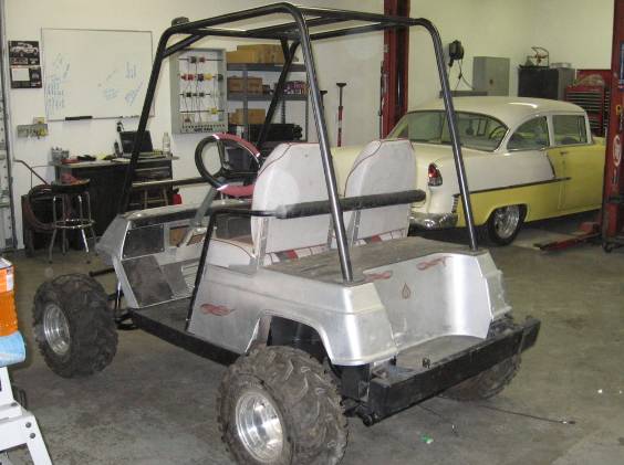

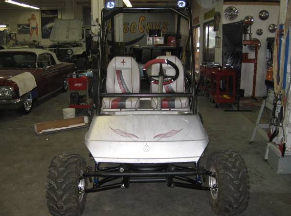

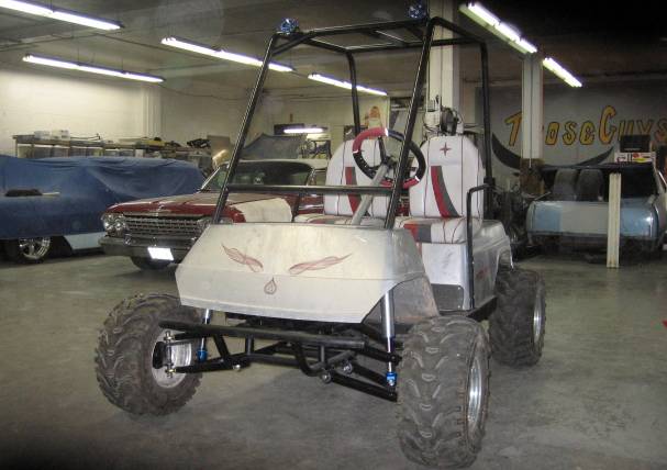

Brian H said:
How about some pics of the golf cart or what ever that is in this last pic?
Yep it's a golf cart, pulled the 4hp gas engine out for a 18hp version, 14" travel in the rear with a 5" wider axle, 12" front travel, 6" wider overall, all tig welded a-arms, fox struts, cage, harnesses and probably seats at this point. The customer wants to clear the 6' doubles at his house.

The doors at getting the woodwork cut now, the engine, tranny & t-case are now out to be gone through and painted, the suspension is basically done, rig is wired, bodywork on the tub is 90% done. We plan to have the rig ready for disassembly and paint on Tues/Wed, then a week for paint and finish woodwork, which gives us a week for assembly and a week of oh crap time :D
