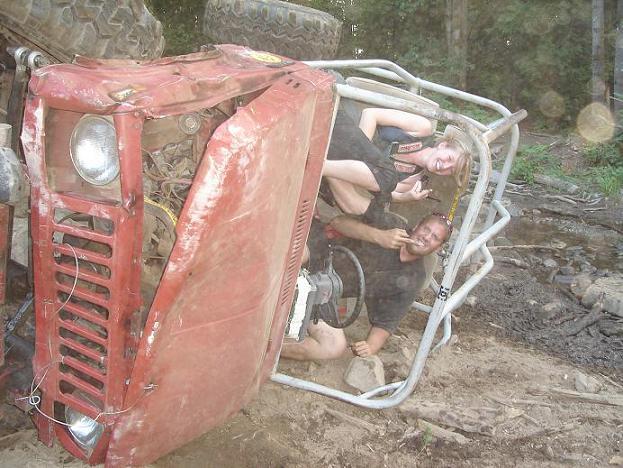

Here's another.....
lol
lol you mean this one? i believe thats your rig in the background by the power lines
turd thanks for the pic forgot about that one
Ya--thats me. you didn't see the big lazer looking thing on it? Built a new thingy that makes rigs fall over by the pish of the button,lol....
I think you took the sami out after the top was cut off and only had one piece of tube on it...
