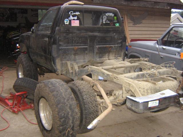

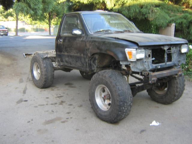

1 week 1 month same difference the axle is all bolted up the truck sits on its own weight I just have the engine problem now I stopped by schwabs on tues to give you some cash but you weren't there
I had the day off, but i just mocked up the rear axle on my truck and im ordering the sky's SAS kit in a minute.

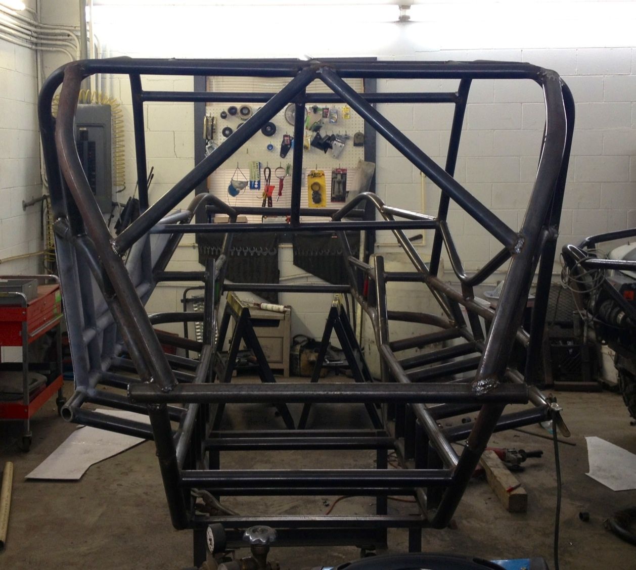

so i got off my lazy ass and did some work now we get to start doing rear suspension and a toyolets old tube bed is going on it going to be running waggys in some variation double shacklesor singles maybe some buggys there will be a track bar involved not much lookin different bed will go on tonight hopefully:beer:

not trying to start ****, but just leave the springs alone with a single shackle and no buggy spring. leaf springs are only going to work so well, and they are designed to work just as they are. any additions like double shackles or buggy springs just screws em up.
if you have the $ and your going with leafs?.. maybe go with chev 63's or all pro super flex rear's or waggys?
Yeah I just got done moving my rear springs to the front and now am throwing in the 63 chevies. . . had a set before they flex out great!!!!

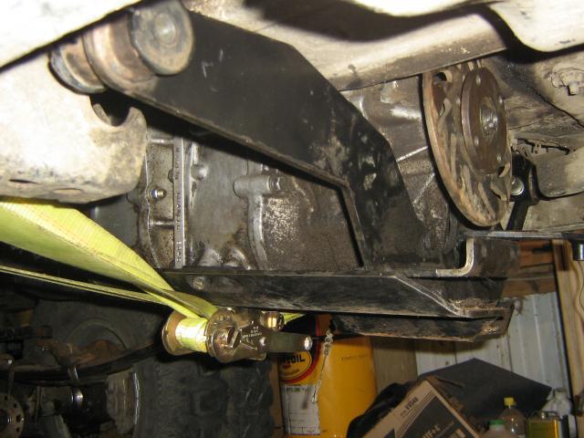

so my engine and tranny and duals are in gotta weld it up tommorow
......Updated specs list........
axles
5.29s f/r yukon front axles gusseted rear and ordered my front gusset
suspension
waggys on the rear with shackles no ghetto buggy leaves:awesomework:
with trail link anti wrap traction bar
52 inch chevy spring front centered pins, need to put a stock yota rear on top
Tires wheels

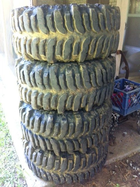

35 12.5 tsls 50 percent tread
15 in aluminum wheels need some black steel ones anyone Got any?
Transmission Transfer case
top shift tranny not sure what kind any help how to tell?
Dual marlin boxes 21 spline input 23 spline output and some fancy shift knobs. allpro high clearance cross member and driveline e brake
Engine

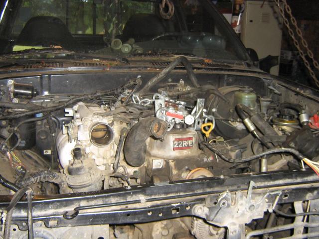

22re its the high rev special will bounce off the limiter all day long... lol
Bumpers sliders cage
non existent yet workin on some money for some tube for now stock bed is going back on

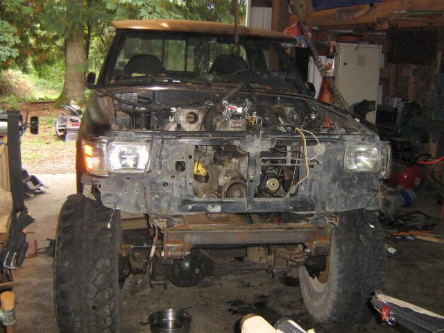

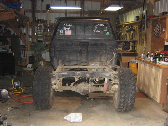

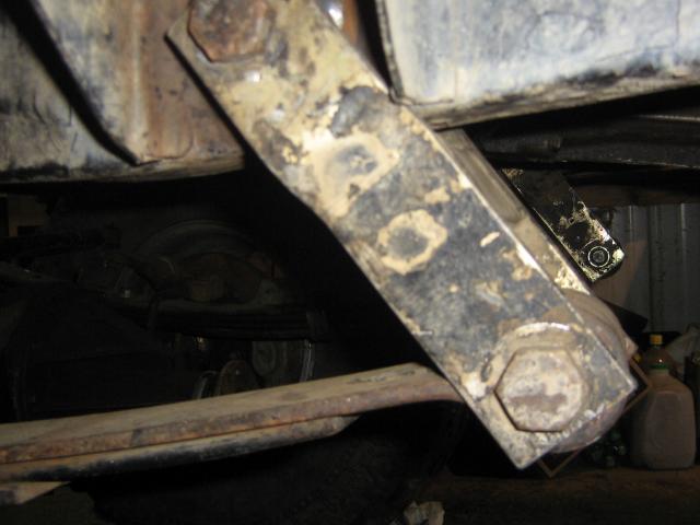

got my leafs springs and axle on tonight sittin almost level little front high but i still have to change my front spring pack with a rear top leaf on the front move that axle a bit forward but i have made alot of progress in the past couple of days heres some more pictures not the gratest pics but it will be ready for some snow wheelin

update
runs perfect now got my wiring issues figured out beenmakin some progess ill get some new pics up tonight
