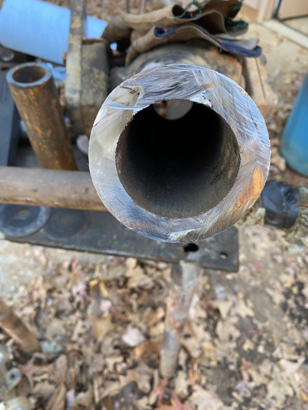

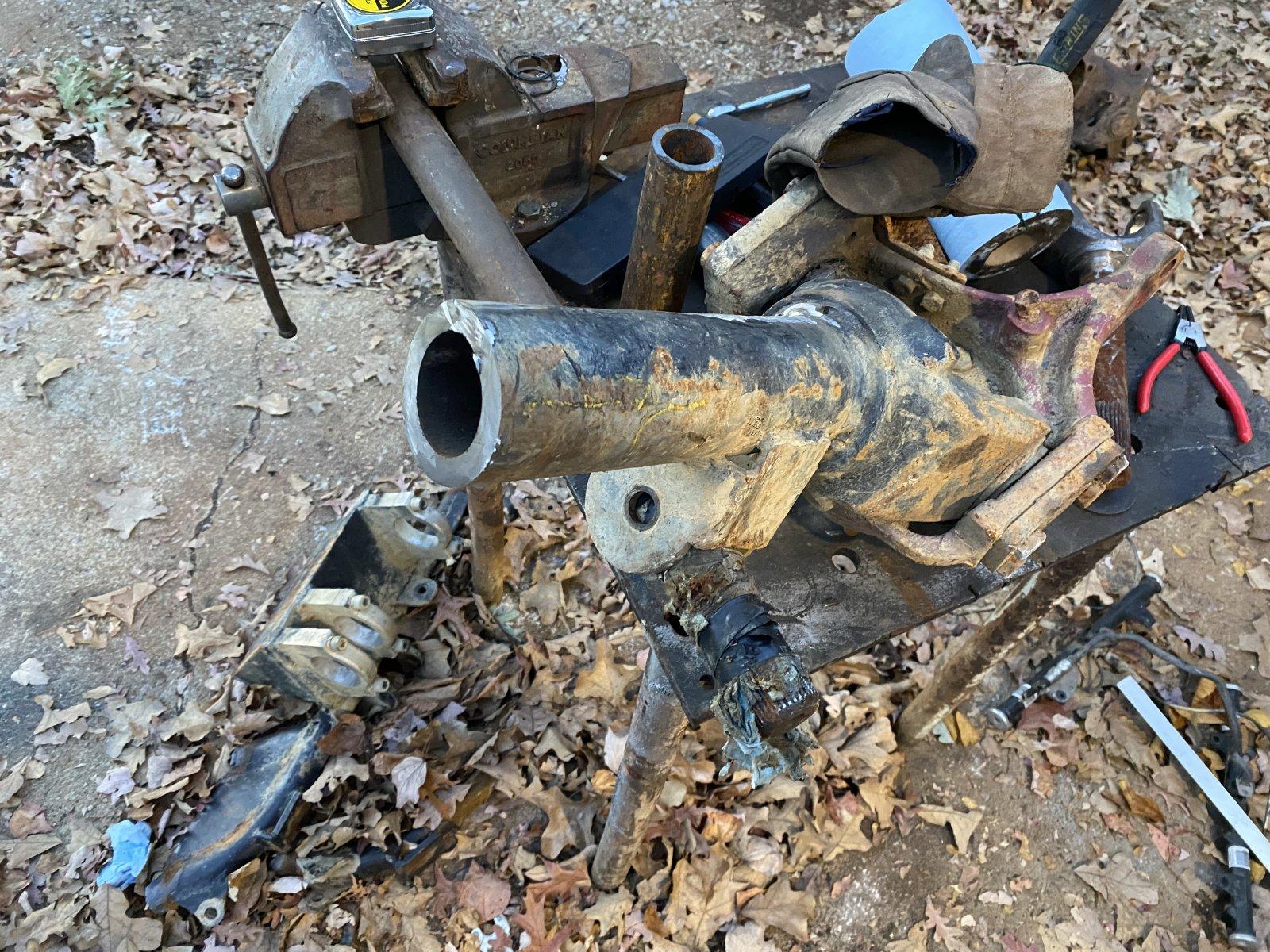

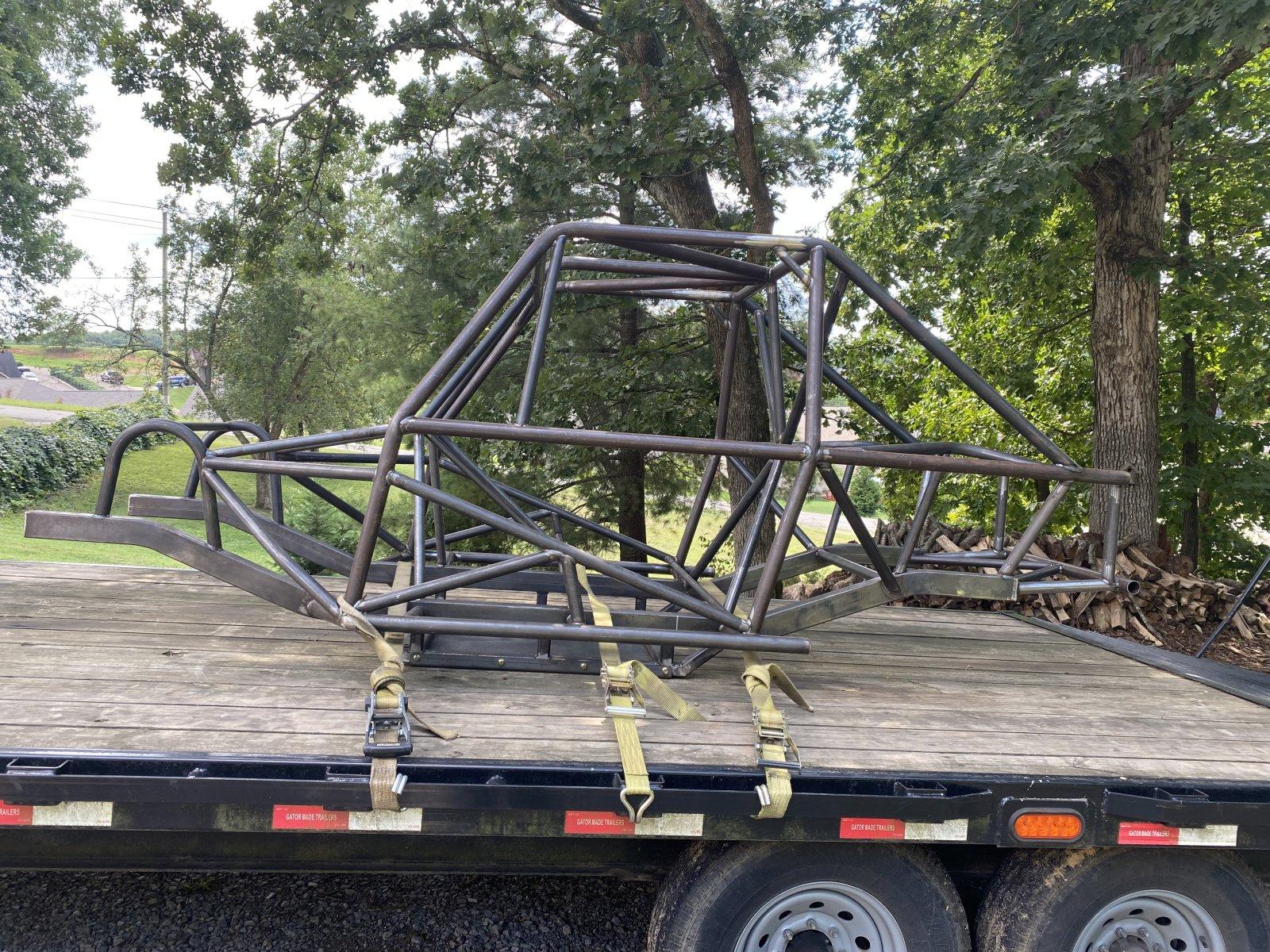

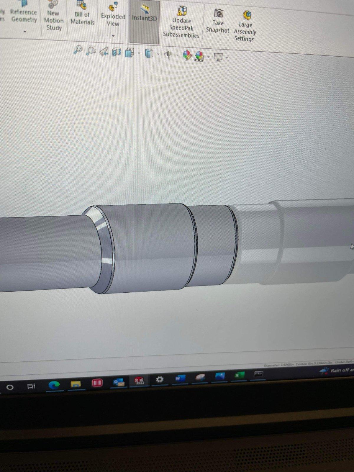

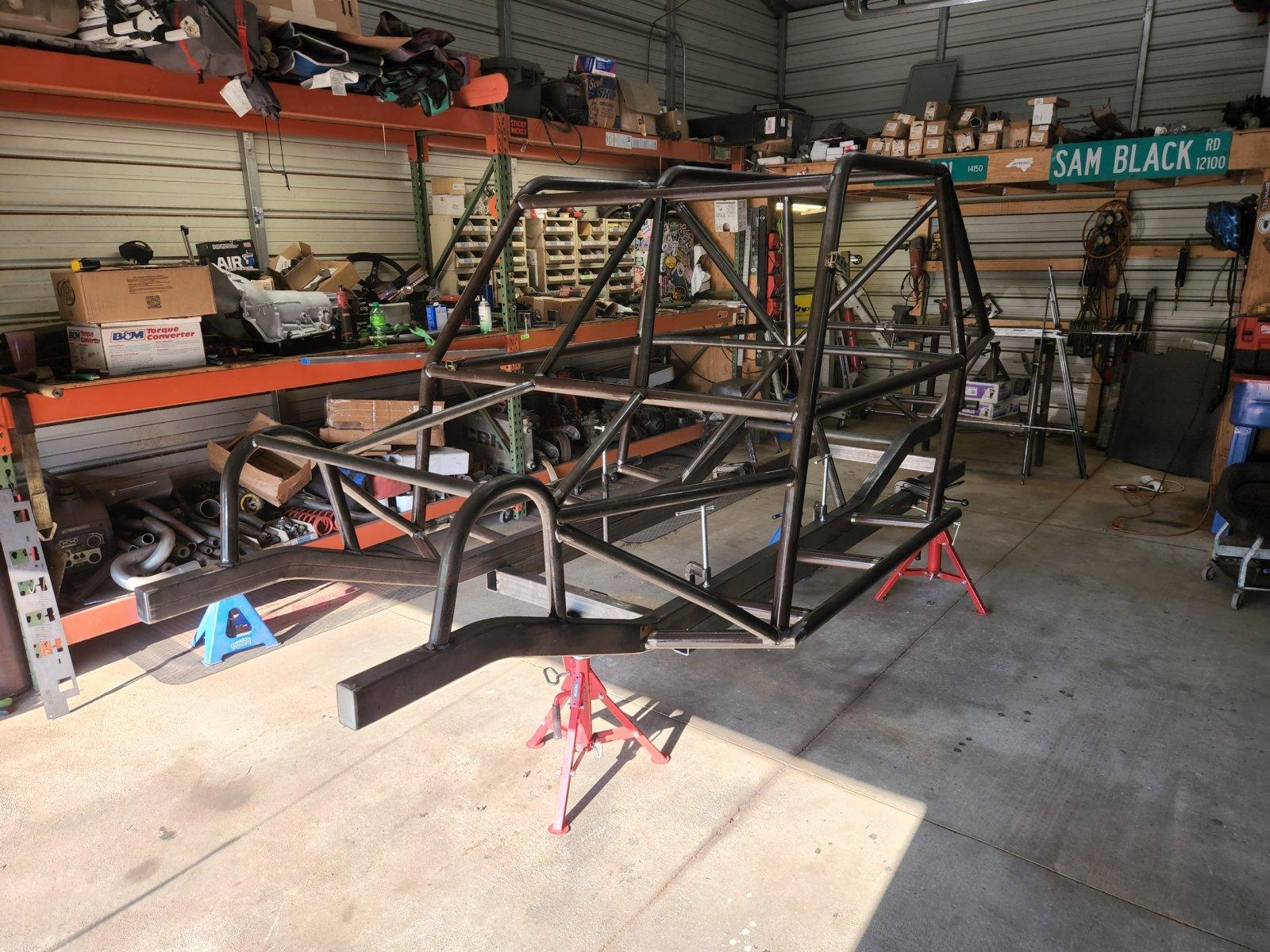

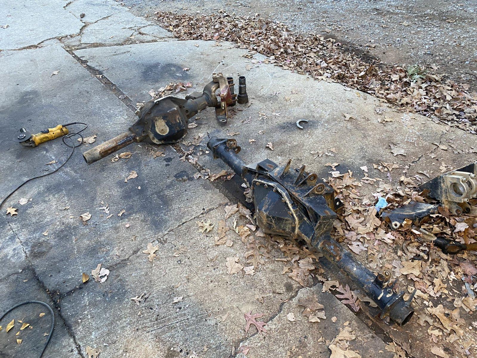

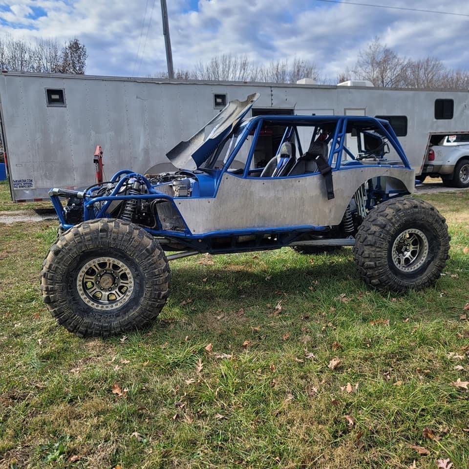

Little update… chassis is done, rev limit fab killed it with an awesome job! The d60 is cleaned up for the most part and 4” section cut out of it. We’re all kingpin 60s 1/2” wall tube? Impressive nonetheless. 14b spindles have been cut off and a buddy has drawn up an adapter to go from the old 14b tube to the 05up sd C. Need a small section of 2.125” tube to slug the 60 back together then will be waiting on the 14b adapters. Slowly gathering parts for this thing so when I actually move it in the shop I can make a decent start.
Will continue to update as I go and will also update as things happen to the other buggies as well. Dads may get trailing arms this winter. Stay tuned.

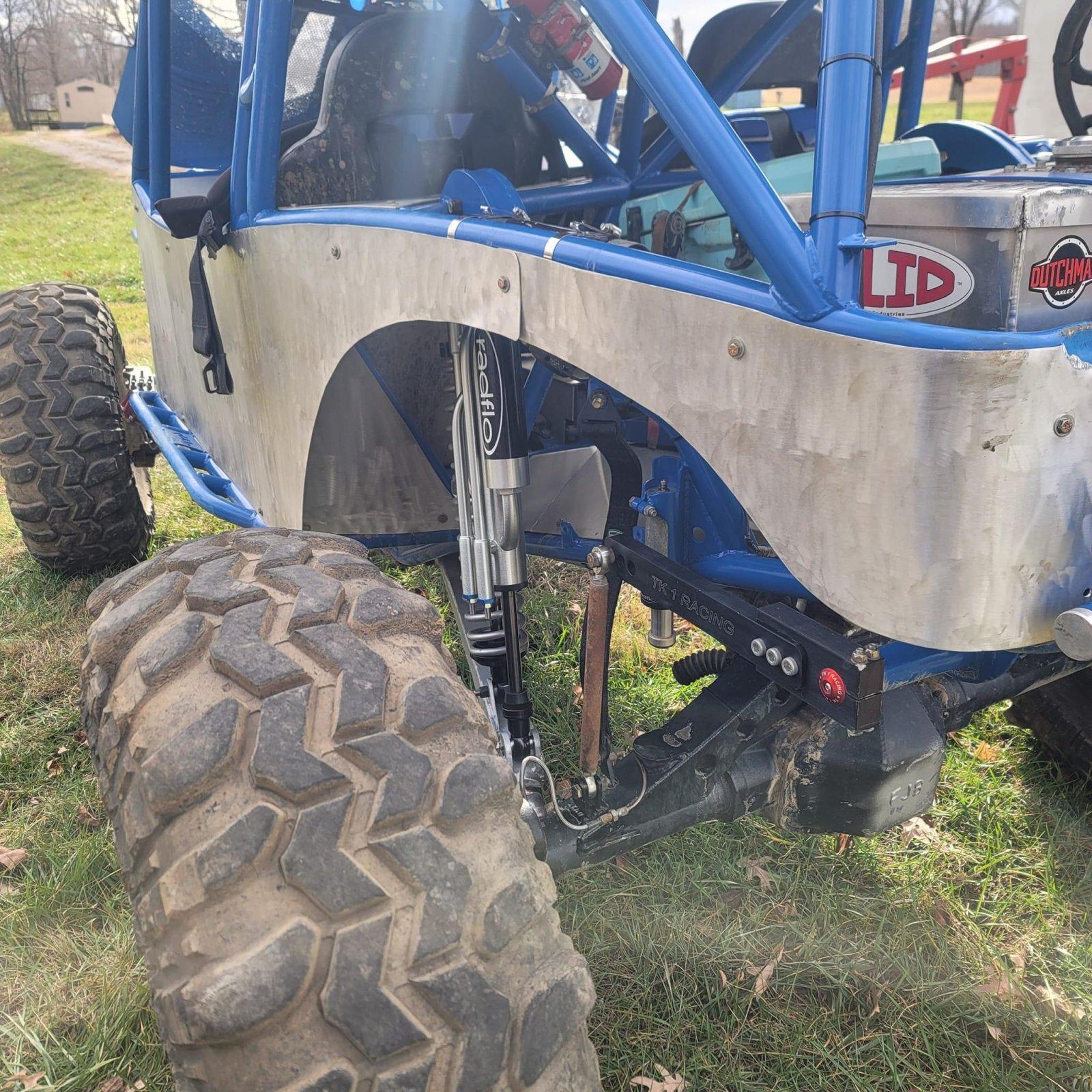

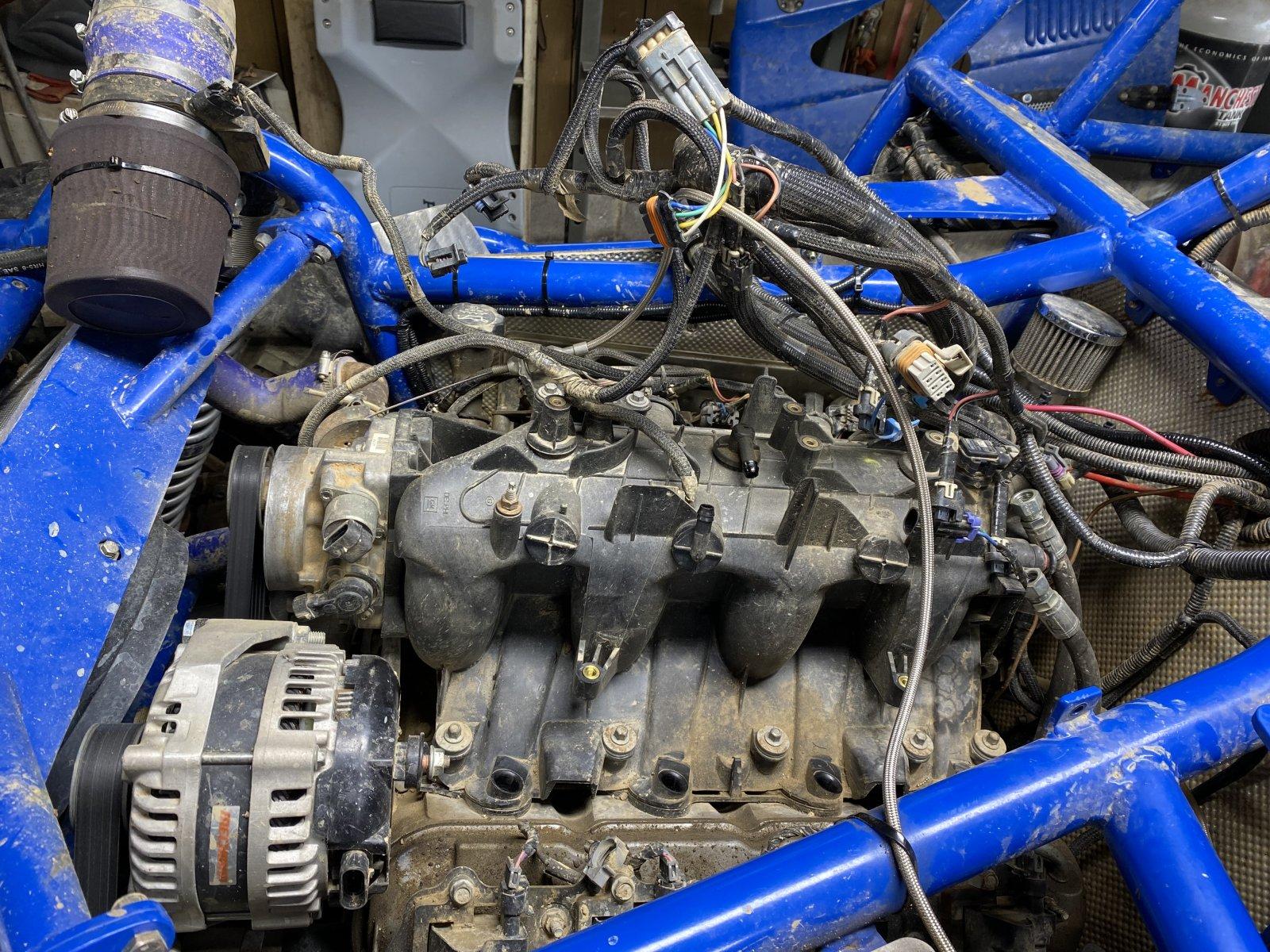

Not much to update but the wagon got rear bypasses from Diddys Big Block Race Shop, got some injector madness goin on, and the metal came in for the JHF to splice the d60 back together.
