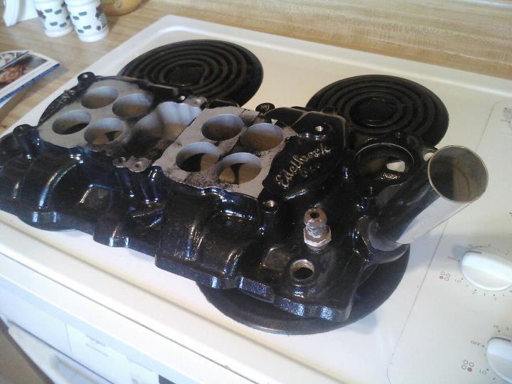

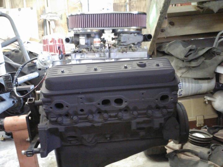

yeah i got that fixed i hope
This is the setup witha an intake like the black one
