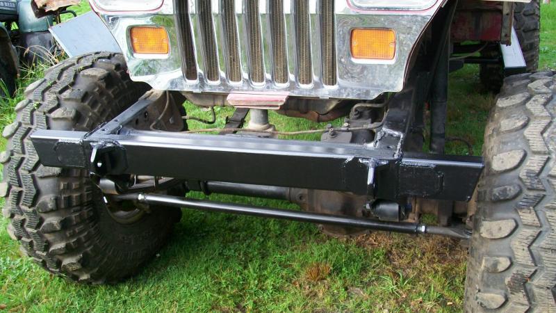

Moving onto the front some more-got the new steering built and installed, along with removing the winch plate only to find....you guessed it, more bad welding!:haha: removed the front tube bumper and plated the front frame horns and the existing front 2x4 .250 wall crossmember someone welded in place of the original, and fashioning some ends from .187 wall 2x4, I think it tied everything in nicely! Also got some clevis mounts built/installed for the front....still need to do these on the rear bumper. Have some pics, but need to take more of the progress to date...will post up in the next day or two...:awesomework:

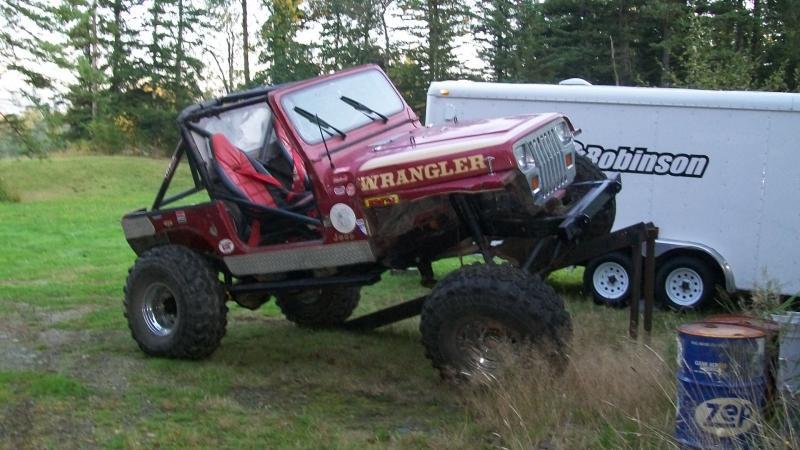

The picture shows where the shocks will be. We will probably Add a leaf or so to the rear packs to account for load. We also need to work out something on bump stops.

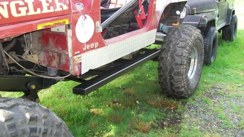

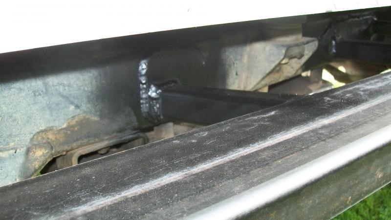

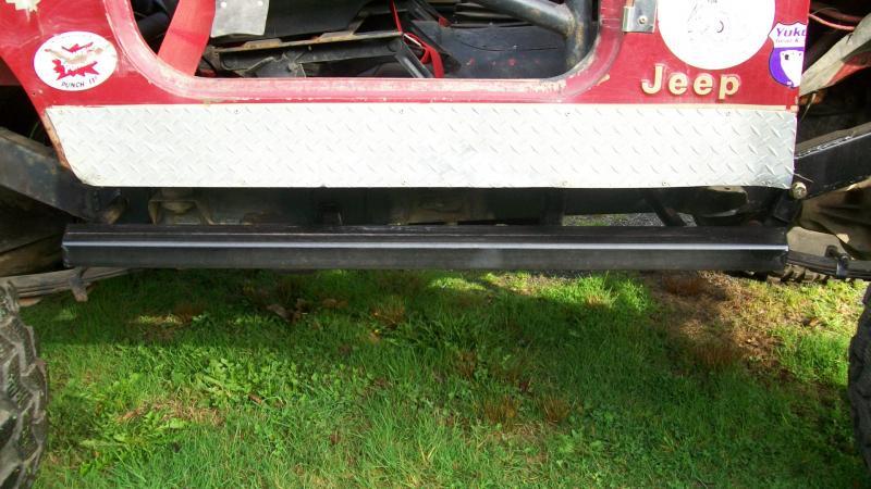

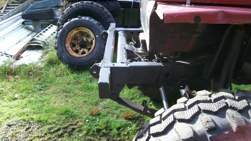

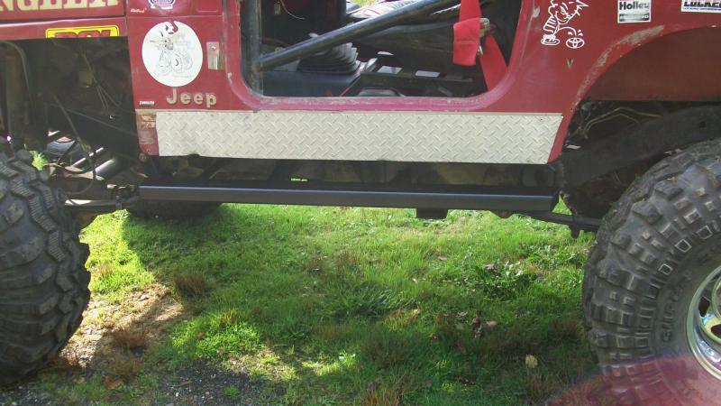

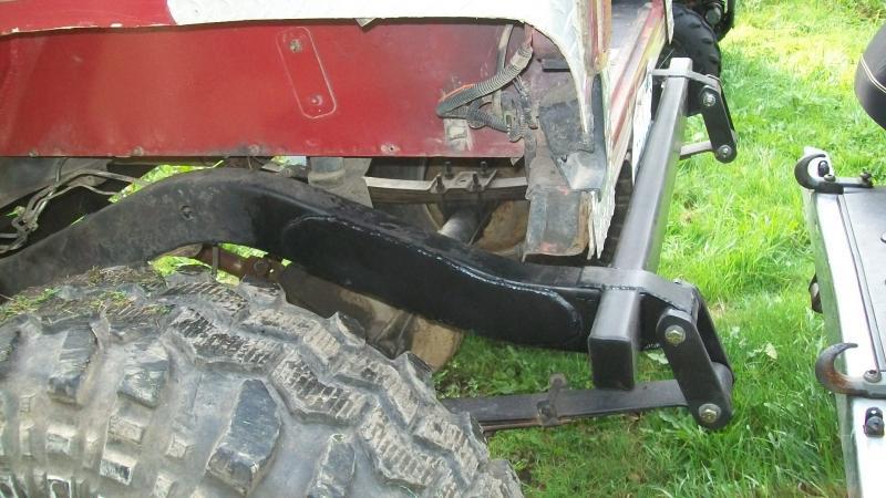

Few pics of the finished sliders/bumpers...also some re-enforcement plating at the back of the frame in front of the rear bumper---note in previous pics there were hooks bolted on thru the frame...no sleeves, just crushed the frame back there about .5"...all better now! :awesomework:

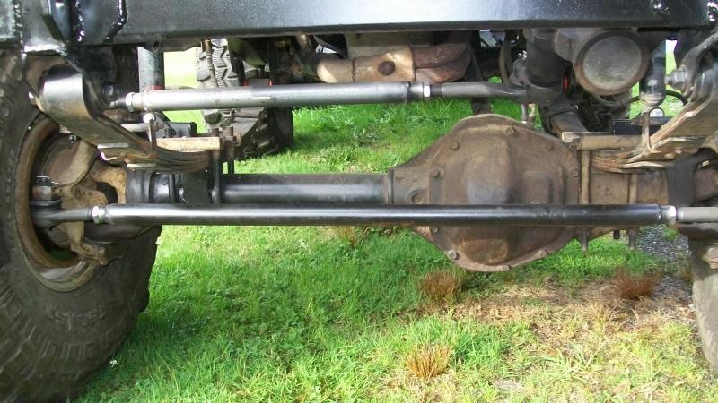

Pic of the finished steering...couple more of the sliders....Keep in md, the reason for the space between the body and the sliders, as well as the rear shock placement, is for the future removal of the body lift when the new tub goes on it...

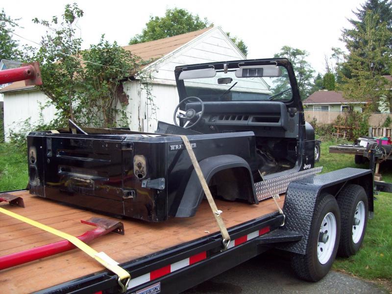

I actually did pick up the tub today. It is as clean as I remembered. Ended up negotiating with my wife as to what color we are going to have the tub painted. It is going to be some variation on black.

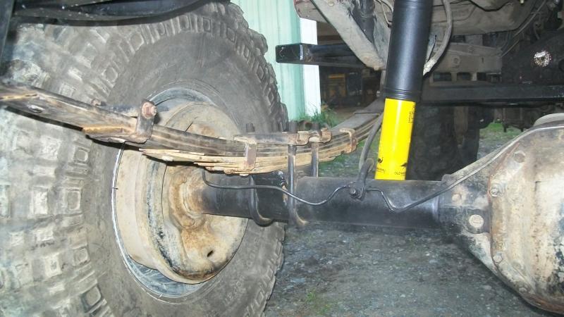

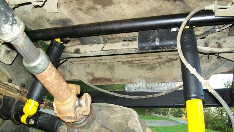

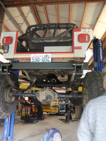

Few pics of the rear shock setup...it's dialed. Also took out the overloads in the S-10 pack, and swapped them for the 3 bottom leaves from the old pack...it's now a 6 leaf pack. Doing this raised the rear 5/8" at the rear bumper corners (perfect for comesating for being loaded for the trail)... axlewrap is very minimal in 2wd, and almost non-existent in 4wd==sweetness...:cool: And yeah, almost couldn't get him outta the seat this afternoon! (and not just because he's old :haha:).....Sorry about the winch! :redneck:
