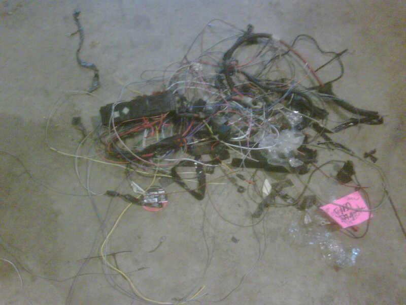

Yup, long day, but well worth it in the end---LOTS of progress was made....NEEDED to get the fenders finished and mounted so we knew what we had for space in mounting the ECM and underhood fuse block :awesomework:...These items were originally inside the passenger area on the old tub where the heater box would be, along with a total ratsnest :yikes: of wiring, all hidden by the alum. panel that WAS the dash....The wiring will be cleaned up of course. :D

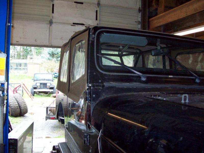

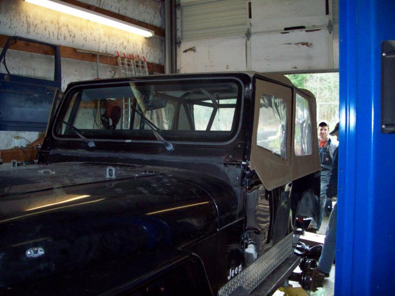

Kevin hung a set of half doors this week. Also, we dropped the new cage in place today and confirmed that the soft top does fit over the cage. Finally!! Some real progress.

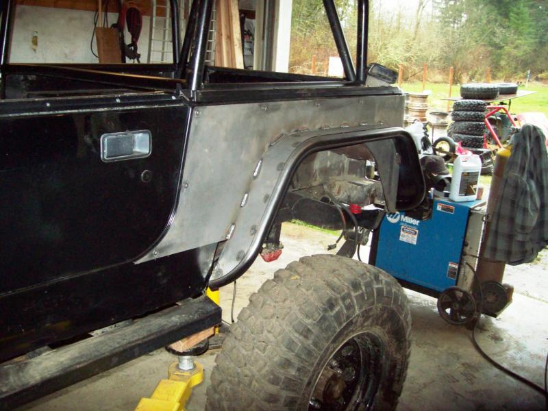

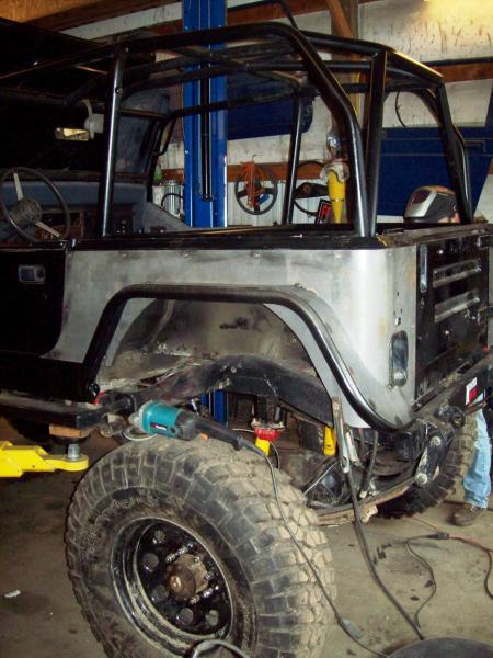

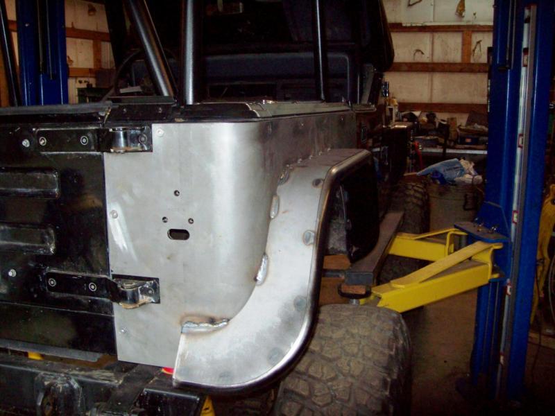

After a few weeks of frustatingly slow progress, we made some real progress this week. The brakes are done. The rears are converted to disk and all the rubber lines are replaced with braided stainless lines. Most of the hard lines were replaced with kink-free lines from NAPA in Bellingham. Those are fantastic!!
Yesterday we hung the rear corners and mounted the rear tube fenders. Even though the front and rear tube fenders are different brands the top sightlines line up perfectly. Unfortunately the batteries died in the camera before I could capture that.

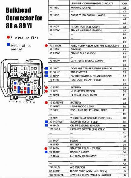

We (well, really Kevin) have been beating our heads on a wall trying to get a '95 harness to work with an '89 body. I joined jeepforum last night and someone came up with the detail that we needed - the pin outs for the bulkhead fitting on the tub.

Im digging those rear tube fenders, i like how they wrap around!
Funny you mention, those Flares are actually for a stretched TJ, and we didn't read the instructions, which stated so, that they "may require modification to fit a YJ"...needless to say, they also fit a YJ unmodded! :redneck: at first it looked kinda goofy, but it grows on ya...:D
