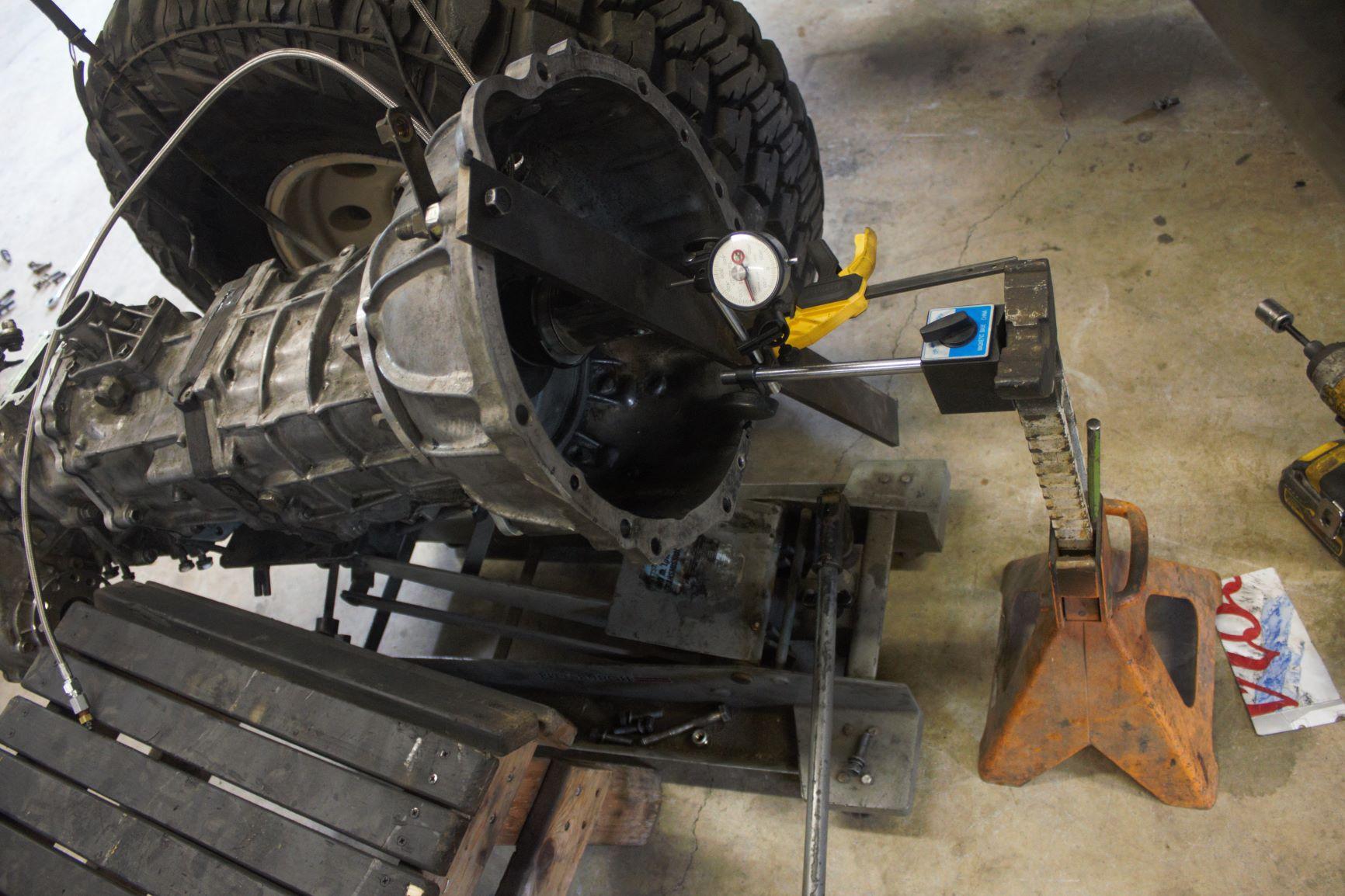

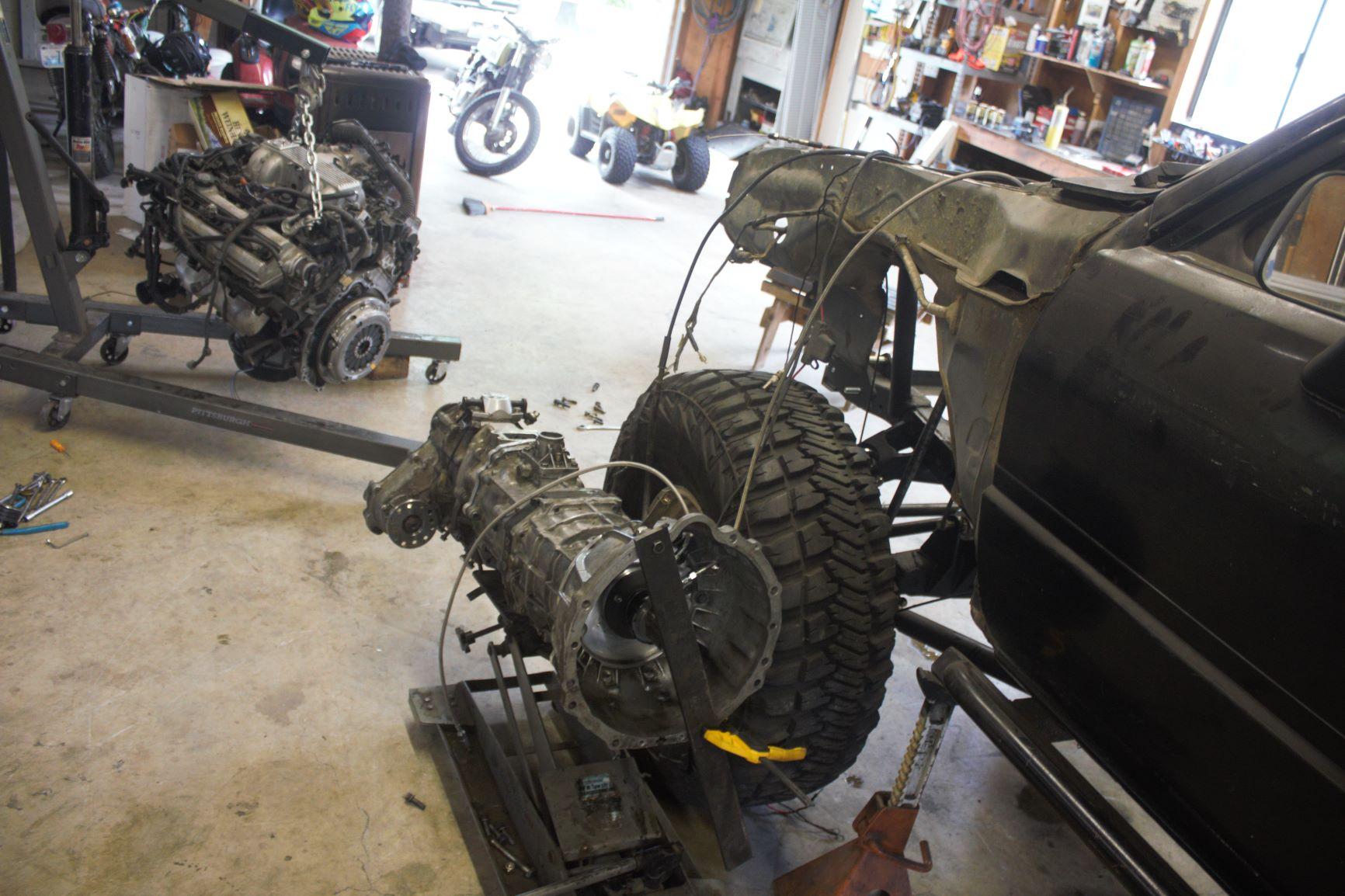

IMG_7246.jpg after installing the motor and trans and hooking up/bleeding the clutch, i still couldnt feel any clutch disengagement. (pedal depressed while trying to turn tcase output with breaker bar) So I took the trans back out, hooked up the slave, bled it again and clamped a piece of flatbar across the bellhousing so I could check the throw...

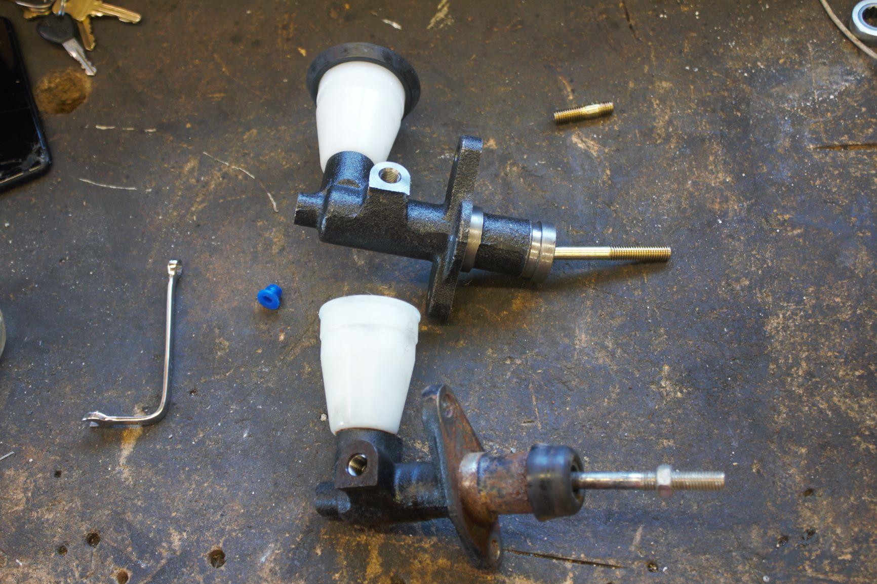

IMG_7250.jpgit was .2". I didnt think that was going to cut it, so I picked up a clutch master from an 80's FJ,
IMG_7251.jpg with a 3/4 bore. had to drill the firewall a little bit, and drill some threads out of it, but it fits real nice in there. Now the throw is right about .4", so that will have to do.

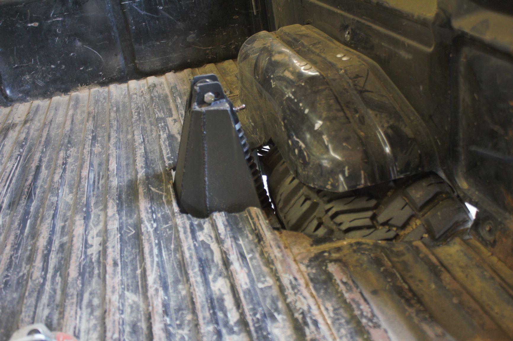

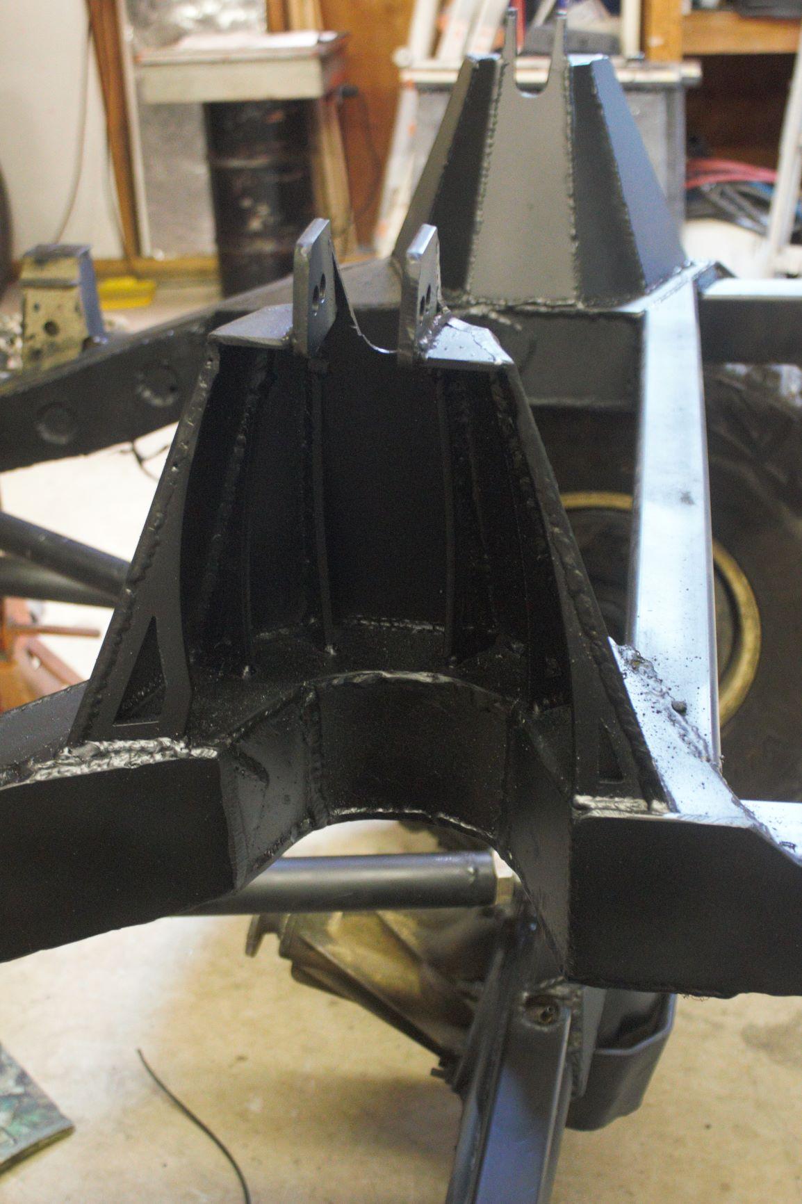

IMG_7262.jpg finished up the gussets on the towers and gave them some rattle can

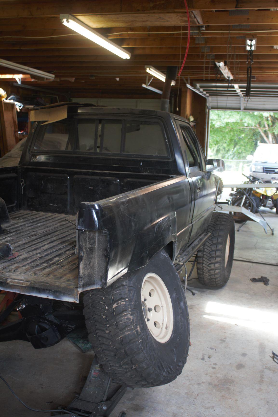

IMG_7265.jpgput everything back on to test fit the bed, trim it out for tire clearance and stare at it for a bitIMG_7267.jpgthis is going to be fun, eventually.

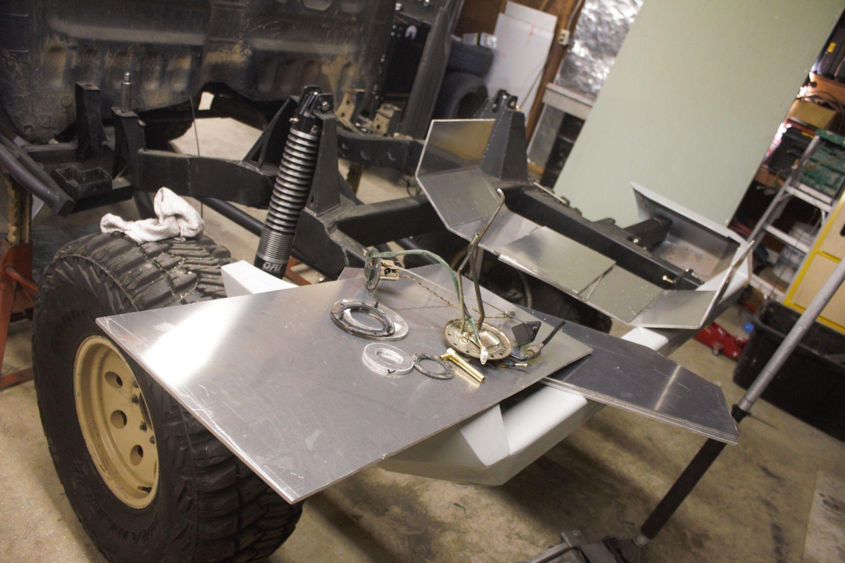

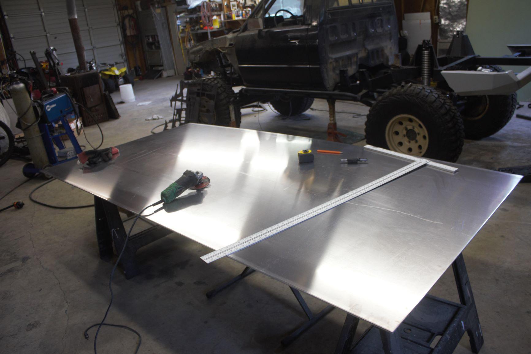

picked up some 1/4 alum from a guy on offerup

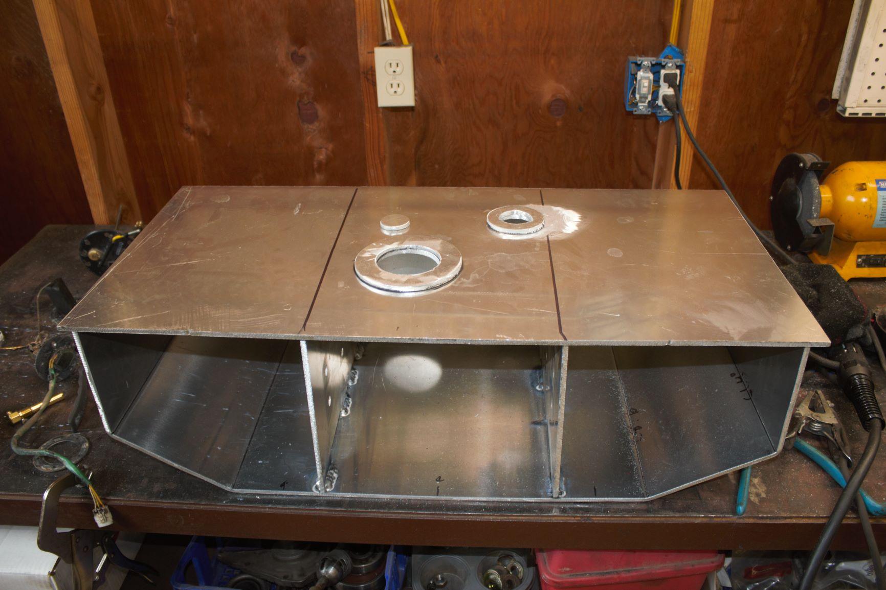

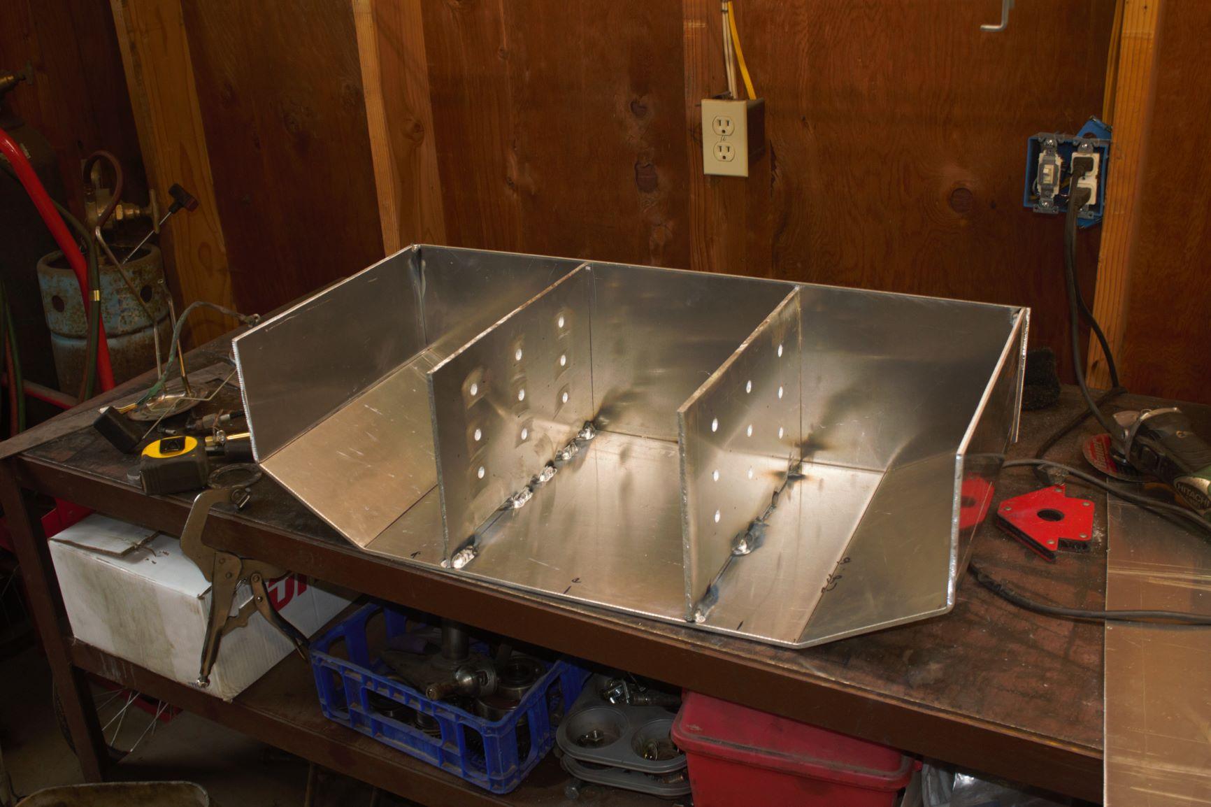

IMG_7270.jpgguess ill try to make a fuel cell

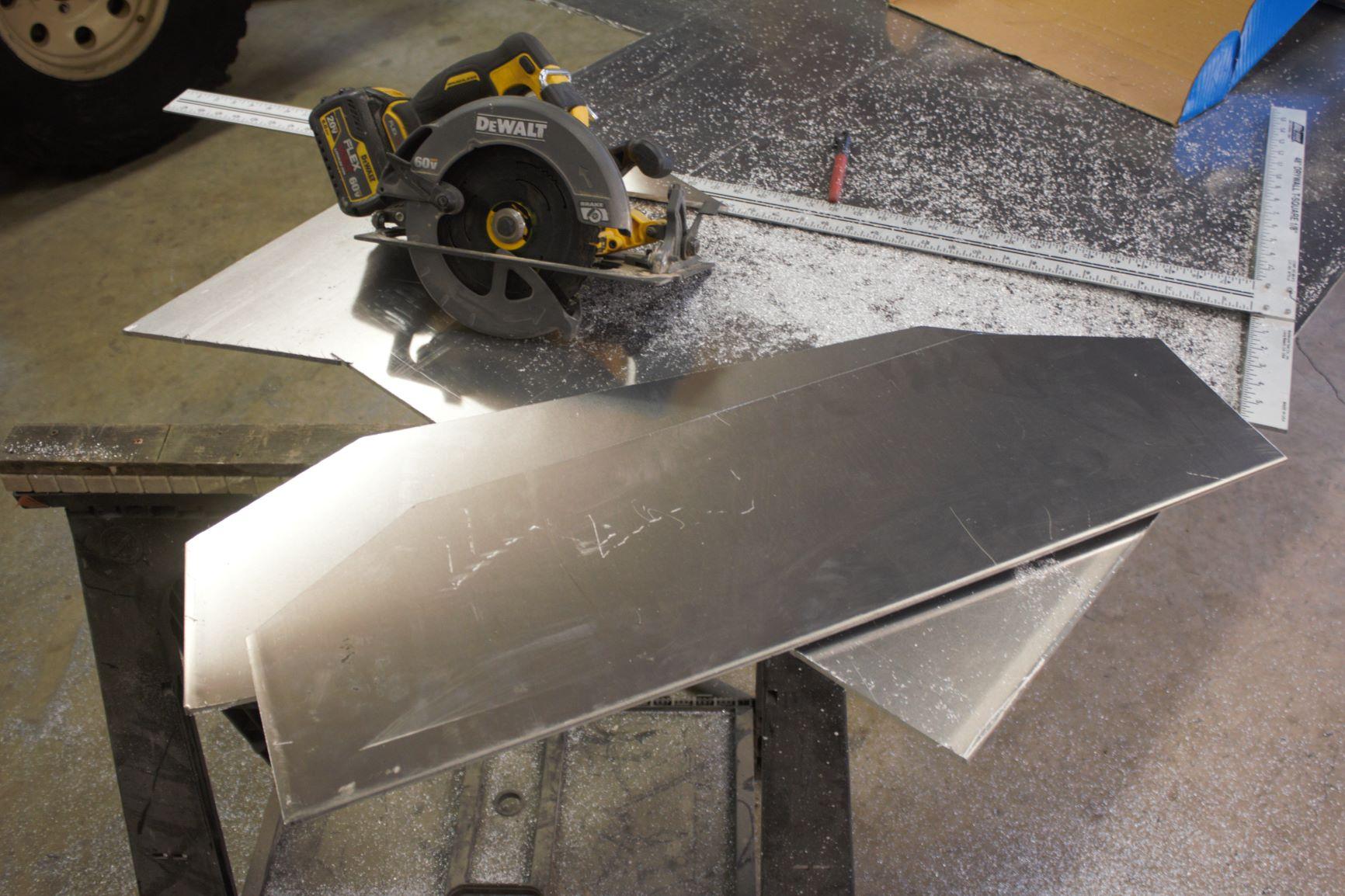

IMG_7275.jpgthis is the fastest way to cut straight lines in aluminum. its only scary if you're scared.

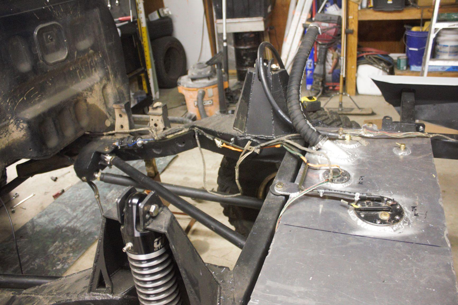

IMG_7281.jpgbent a couple, cut a couple. I'm going to use the factory toyota pickup/return top and the factory fuel level sender. got a 15"x3" holley hydramat for a fuel pickup in there, hope they work like they are advertised. seems pretty straightforward
IMG_7284.jpg welding alum with a mig machine is really dumb feeling
IMG_7285.jpgbut it sticks it together

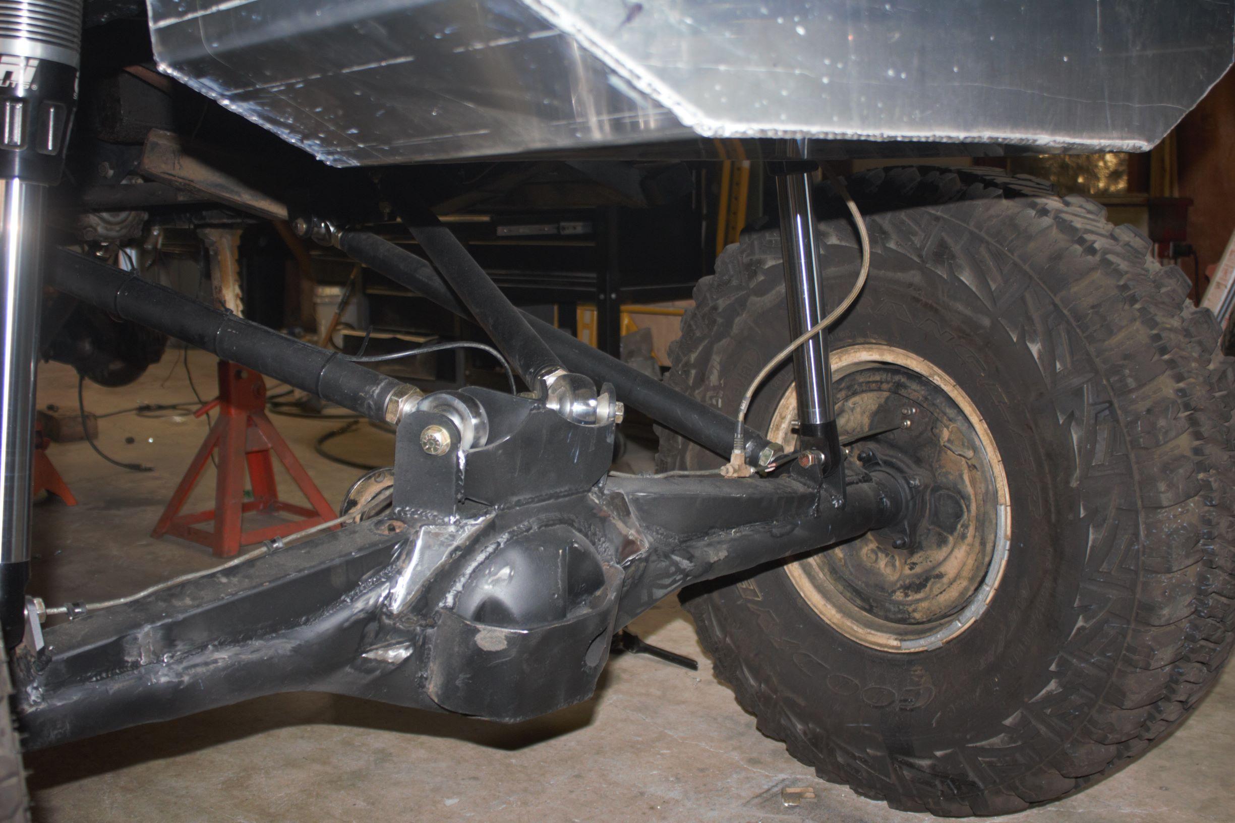

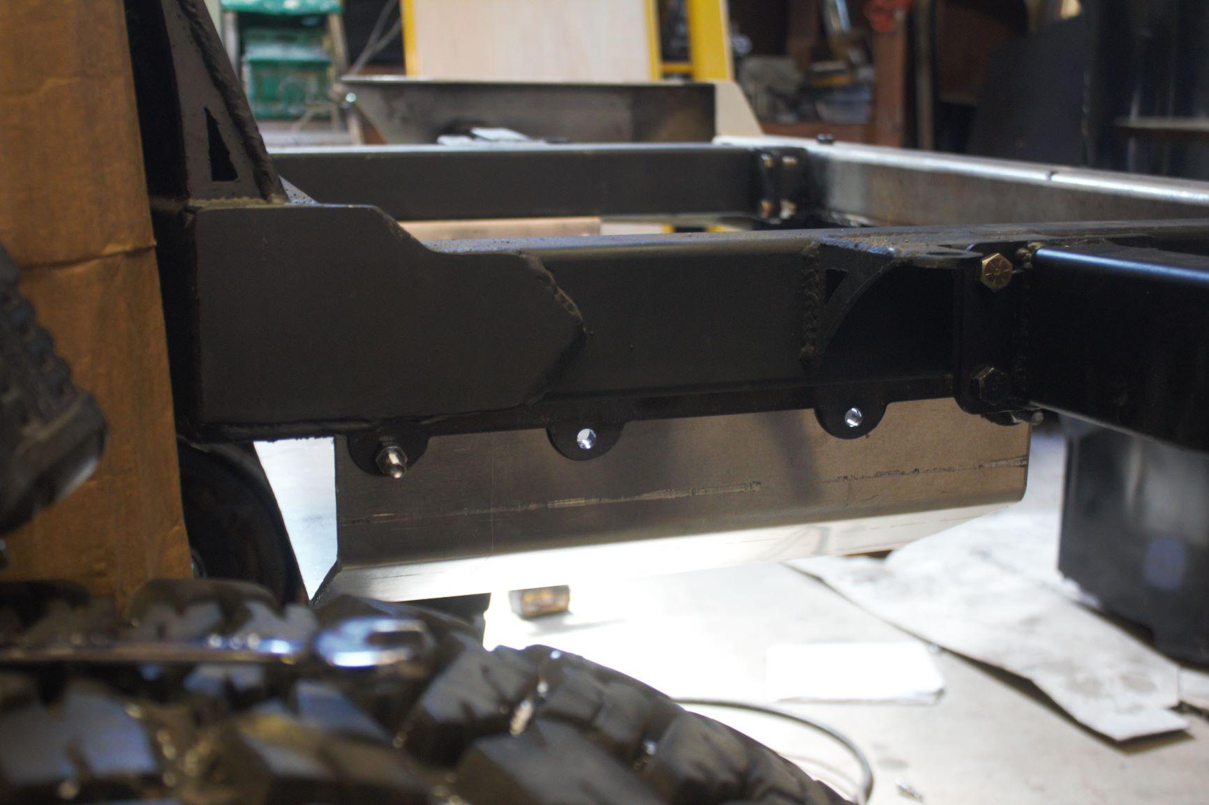

IMG_7294.jpg used the rest of the aluminum to make a skidder for the aluminum fuel tank.. hope 1/2" of alum is enough to keep the rocks out

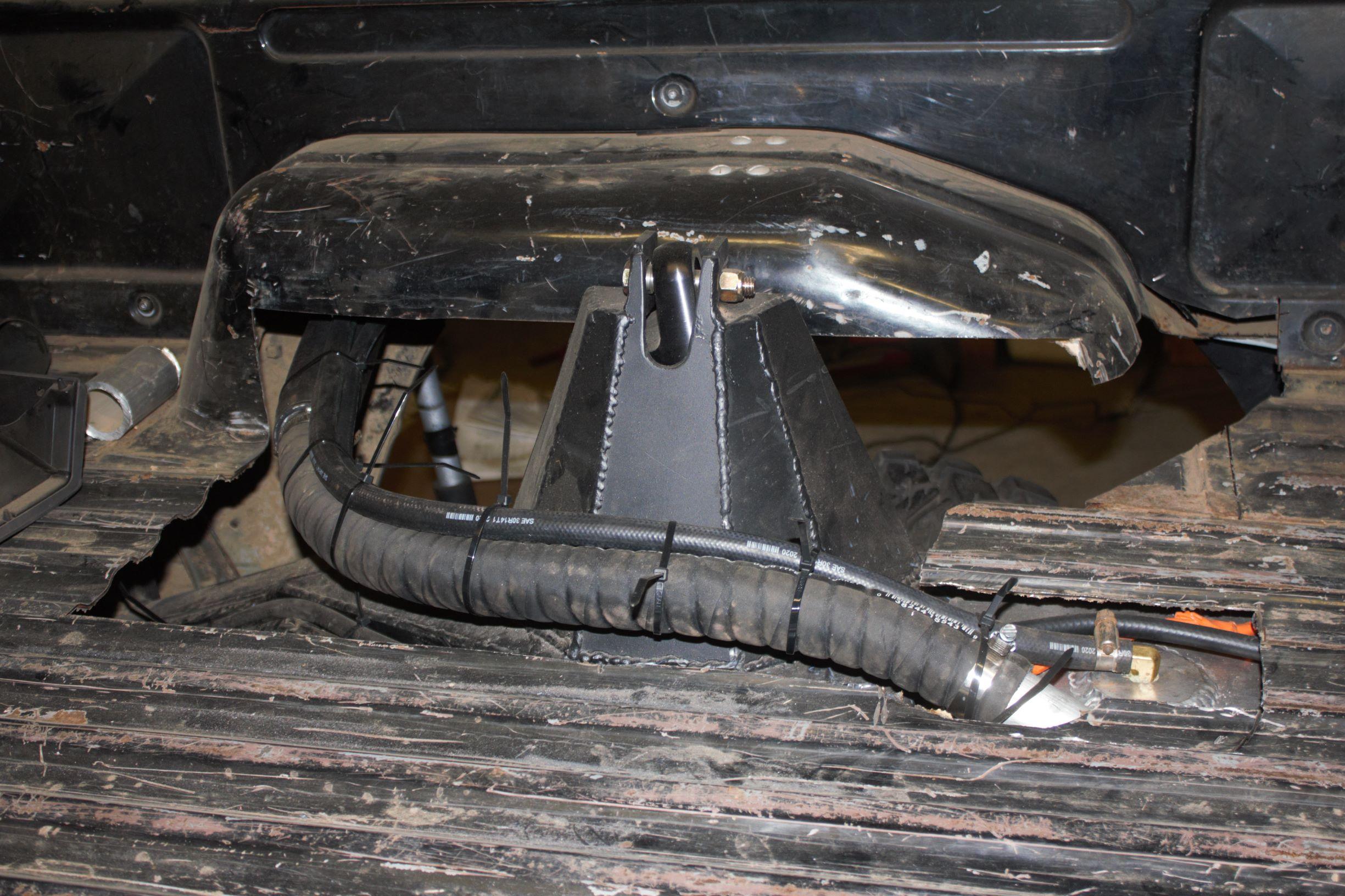

IMG_7302.jpgtest fit the thing after a watertest, no leaks, yet, fit seems good-ish. turns out there is a lot of crap on a fuel tank. filler neck, inlet, outlet, rollover vent, filler vent and gauge
at least the tank isnt draggin weeds two feet below the frame anymore

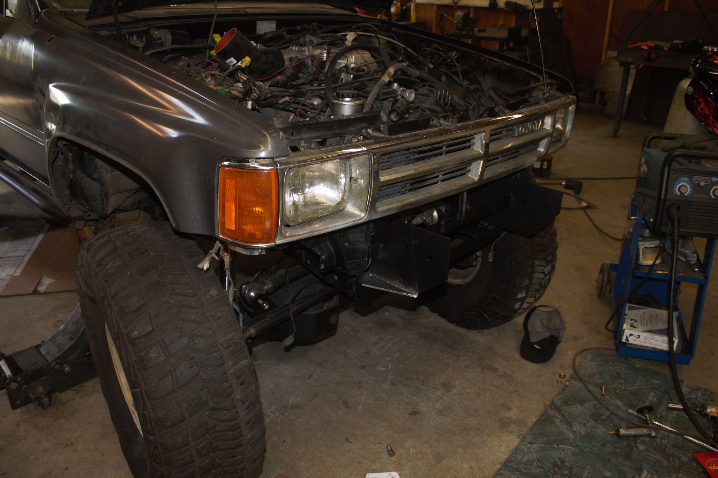

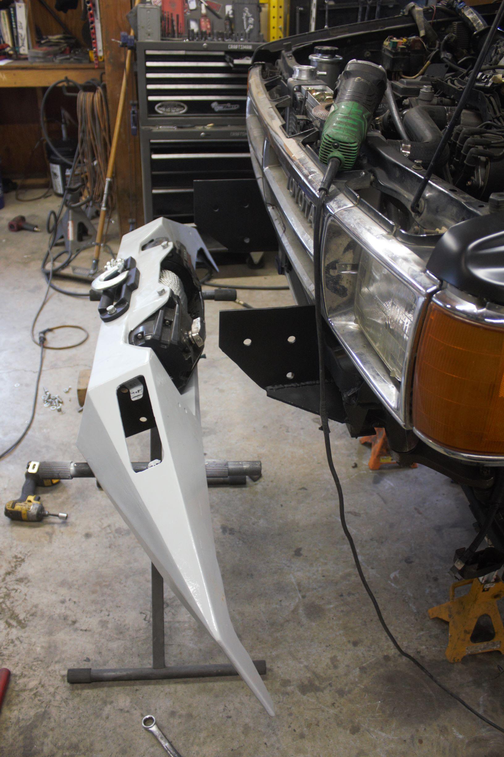

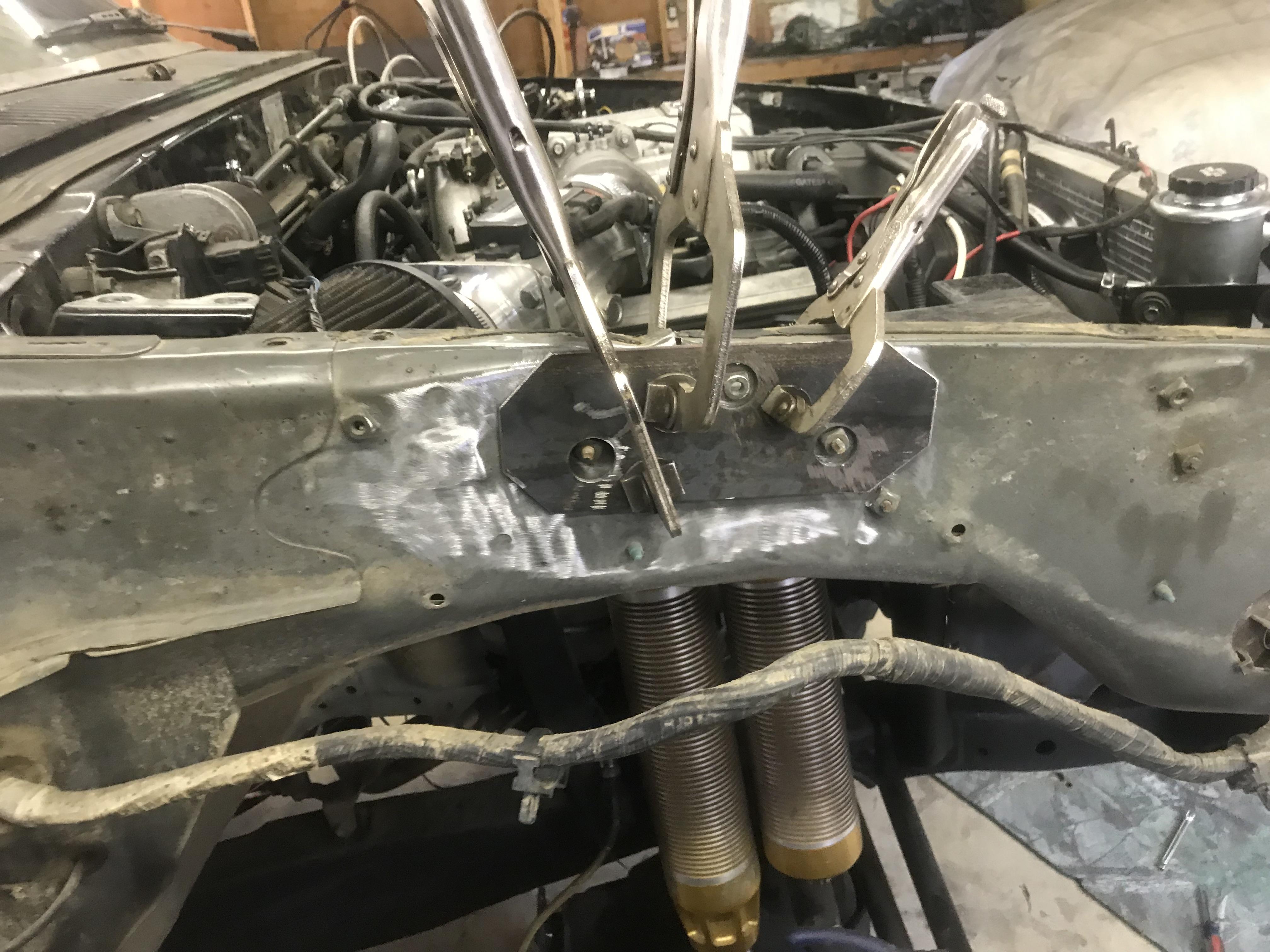

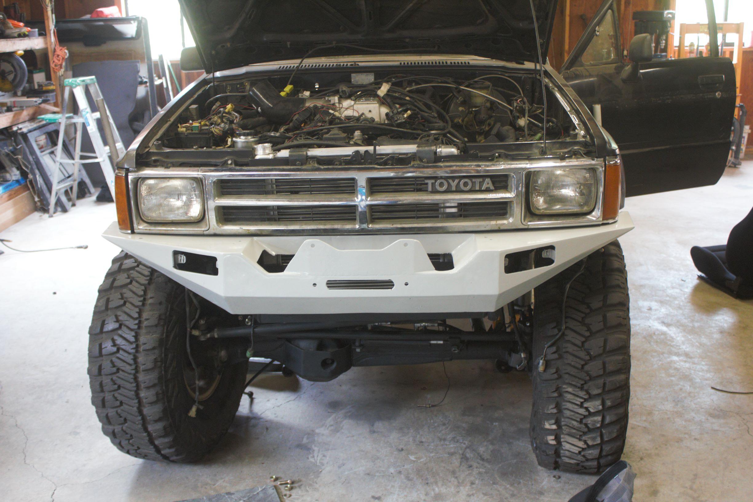

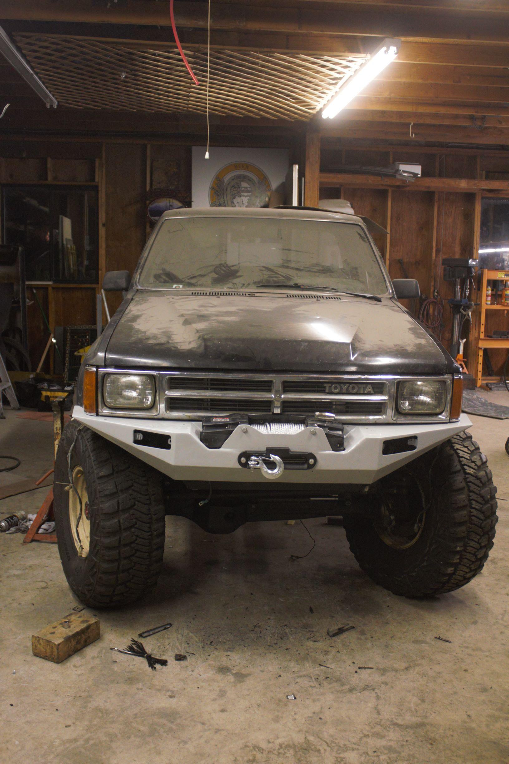

IMG_7312.jpg got new bumper mounts made, had to thread the needle on both sides of the radiator to get them suckers to fit

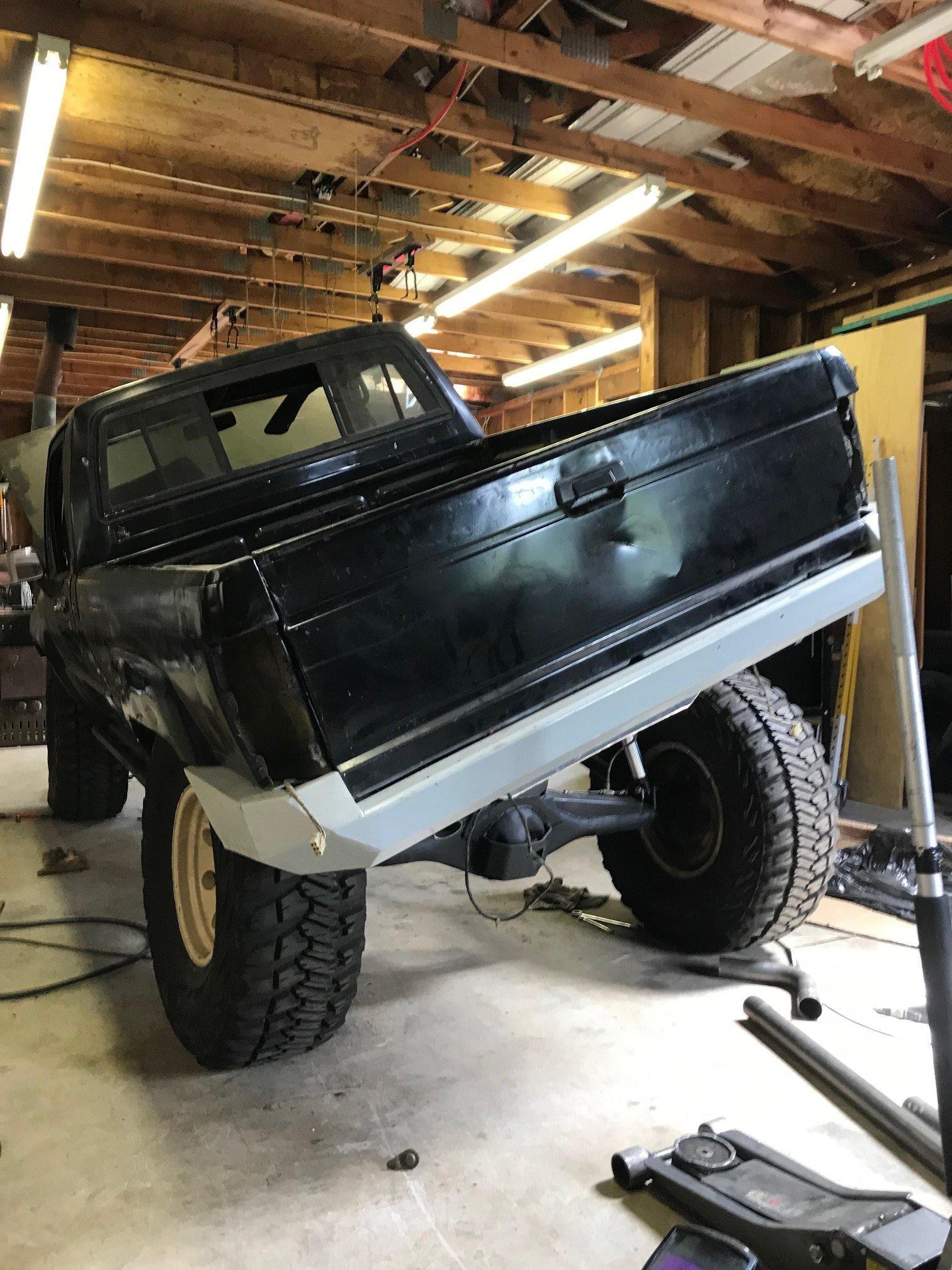

IMG_7319.jpg test fit #1
IMG_7322.jpggot brake lines plumbed, safety third when fitting the braided line in the back on the ol hi-lift

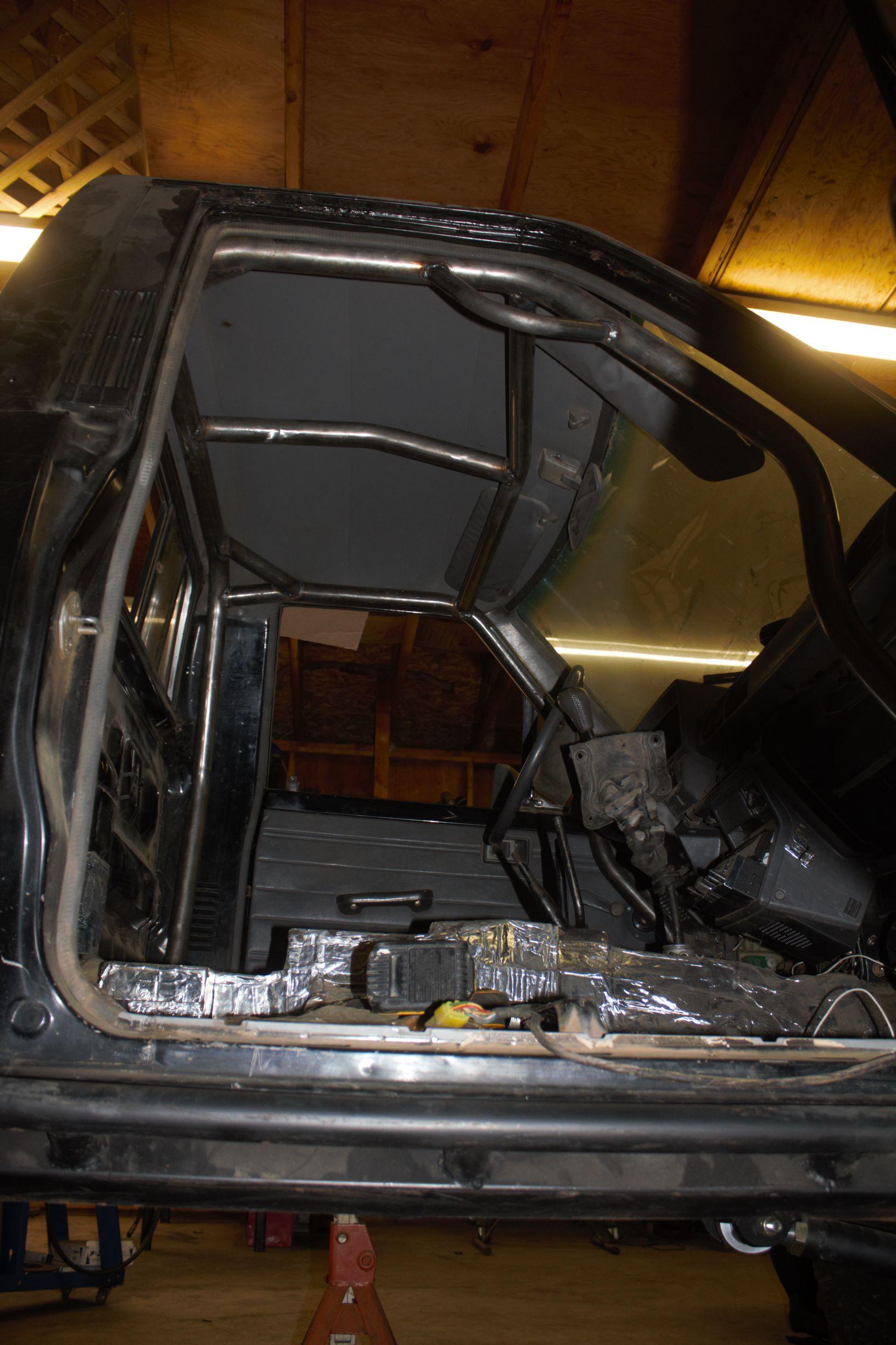

IMG_7328.jpg got my 4xinnovations cage all welded in, had bend a couple new pieces so it would fit super snug, I dont want to bang into that thing anymore than I have to

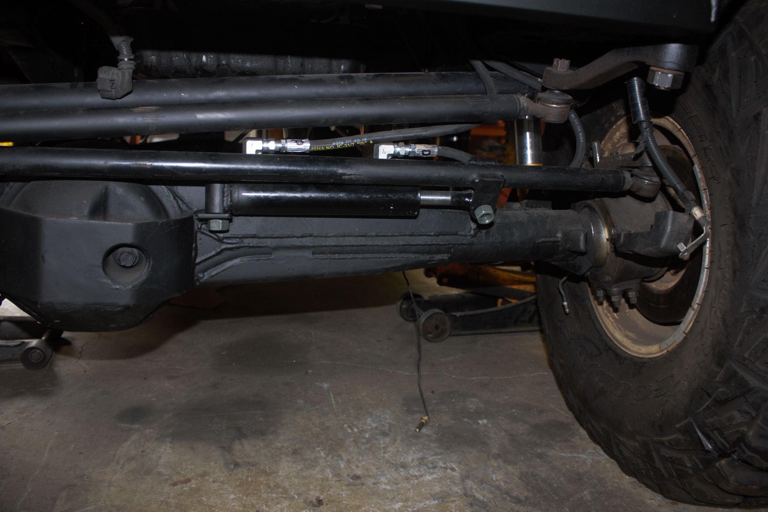

IMG_7338.jpg also made a little bash guard for the hydro assist ram

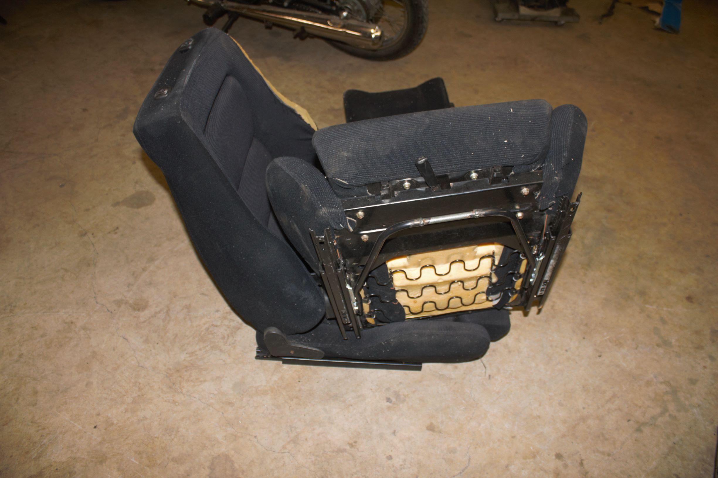

IMG_7332.jpg butchered some seatrails, need to get these things mounted in the truck tomorrow

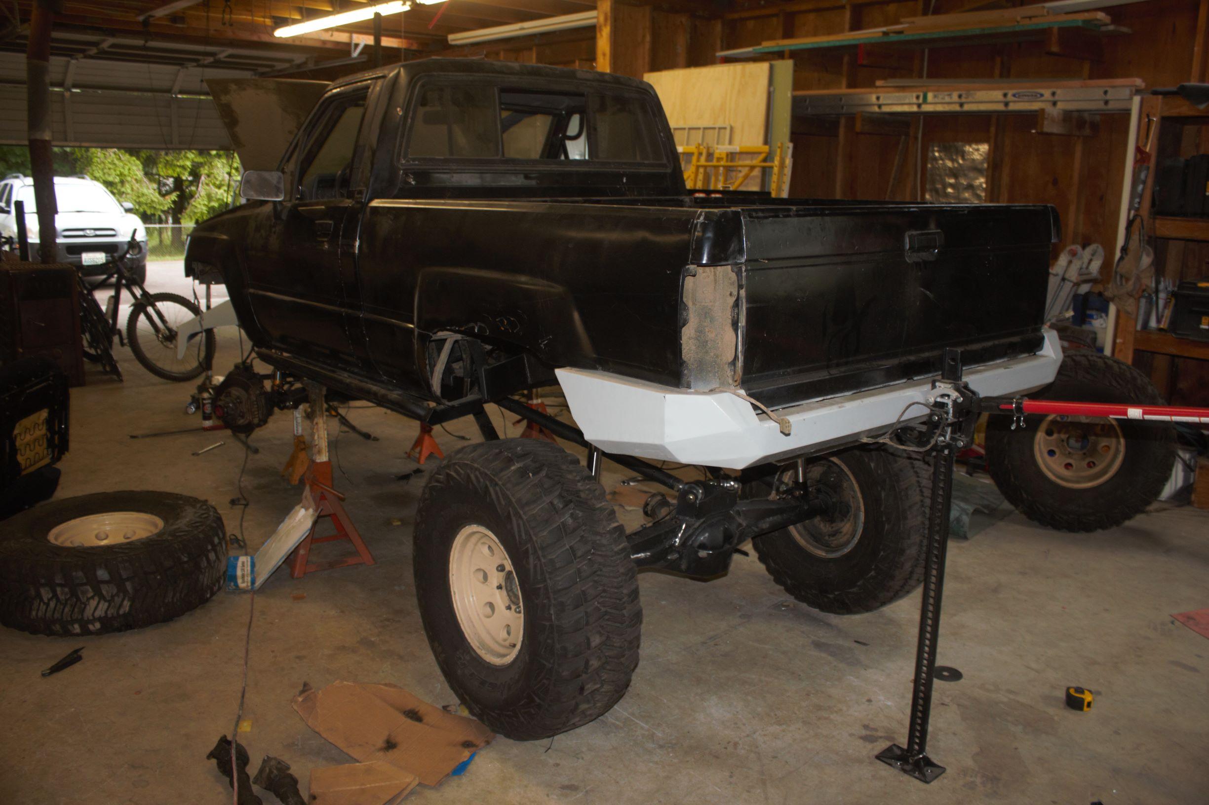

IMG_7333.jpg and the last big job besides wiring the thing up is to close these holes in the bed up. I'm really not looking forward to this job. Sheetmetal, welding, and I.. aren't friends. Starting to see the light at the end of the tunnel at least. Cant wait for some catastrophe to happen so l can burn the thing down.

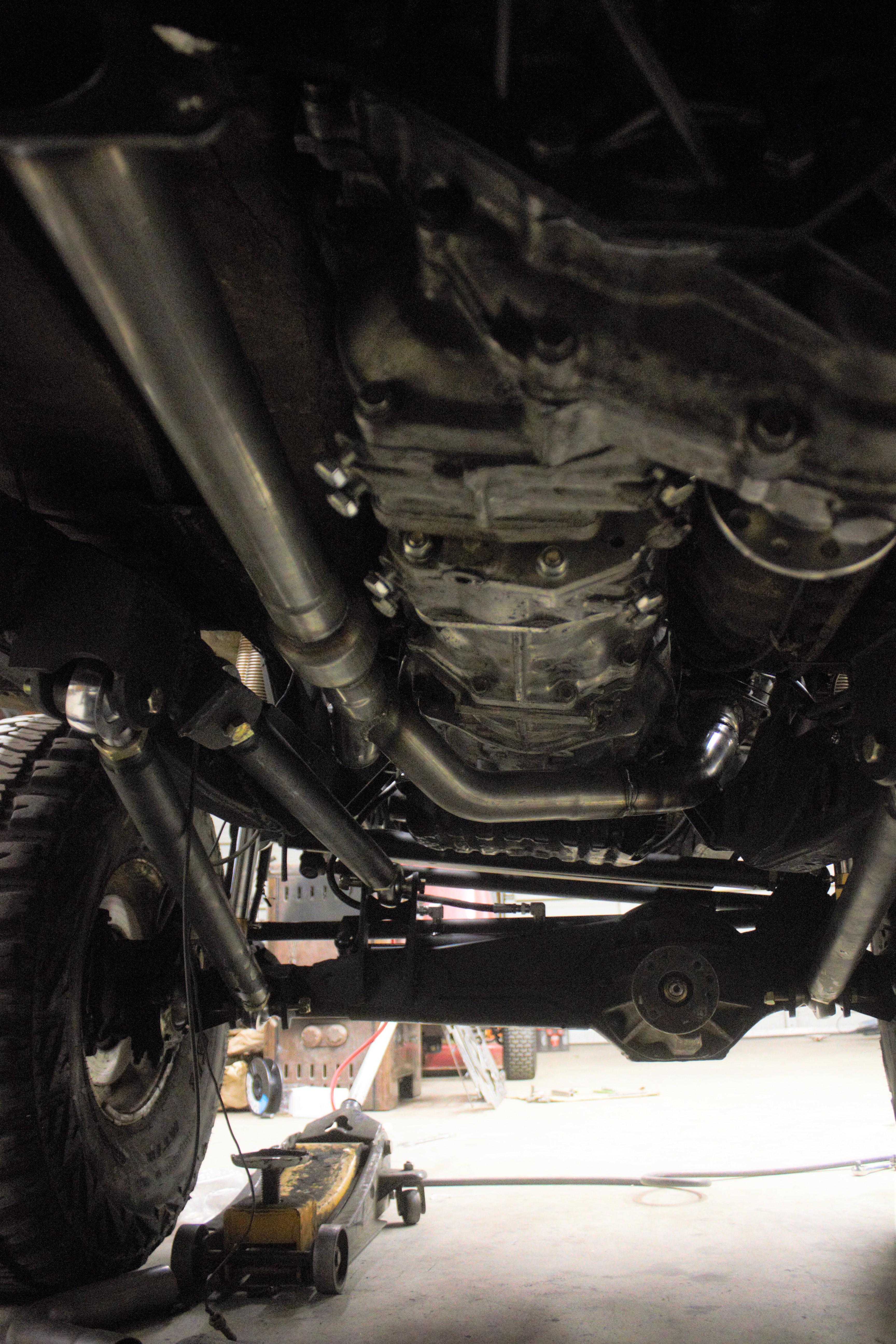

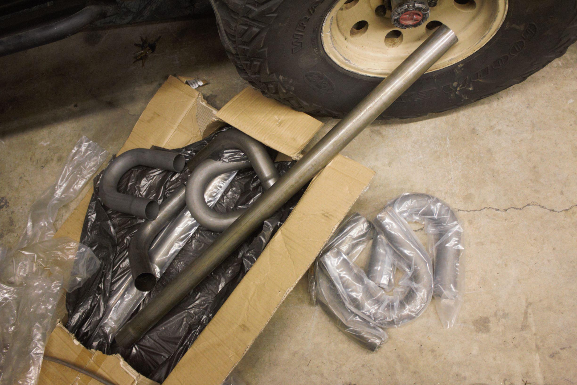

IMG_7339.jpg got a box-o-exhaust bits for 119$ from ebay 2.25" stuff...mandrel bent mild steel or so they say

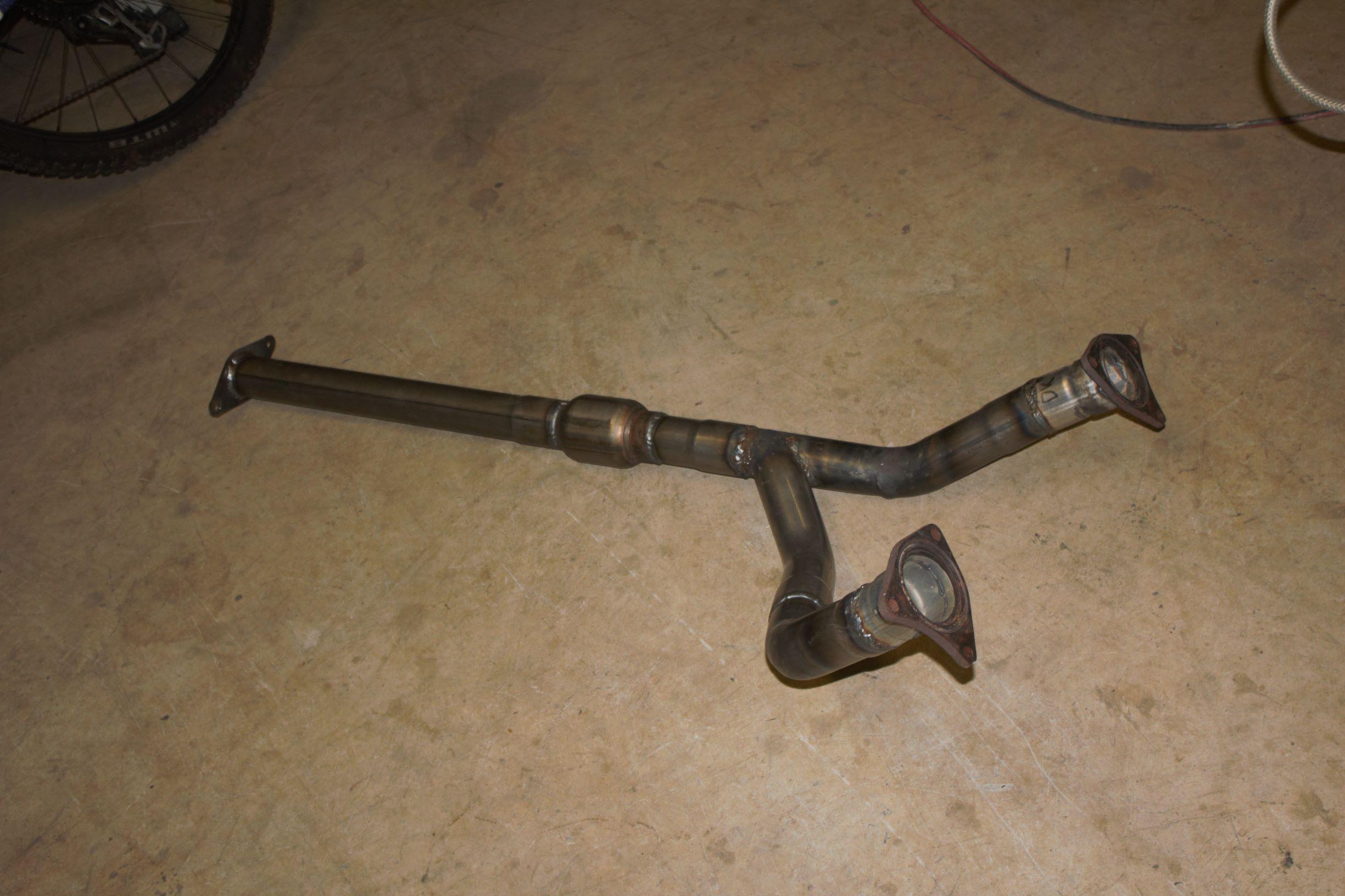

IMG_7340.jpg pulled some junkyard flanges for the manifold side, burned a couple out for the downstream end, ordered a 14$ "muffler" thats just a little tiny resonator, and made me a sad little crooked excuse for a Y-pipe
IMG_7343.jpg but it fits, its out of the way, and the price was right, and it was only a little bit painful to do

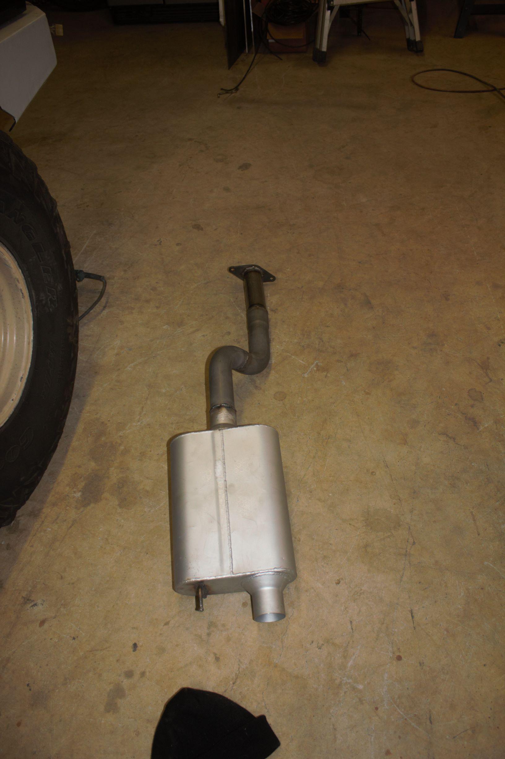

IMG_7347.jpg also got a super cheap crap thrush 2.25 muffler that probably sounds like diarrhea, but thats what you do when you run out of money
got the lowrider function engaged on the rear to buttfab exhaust. wishing it sat that low at rideheight

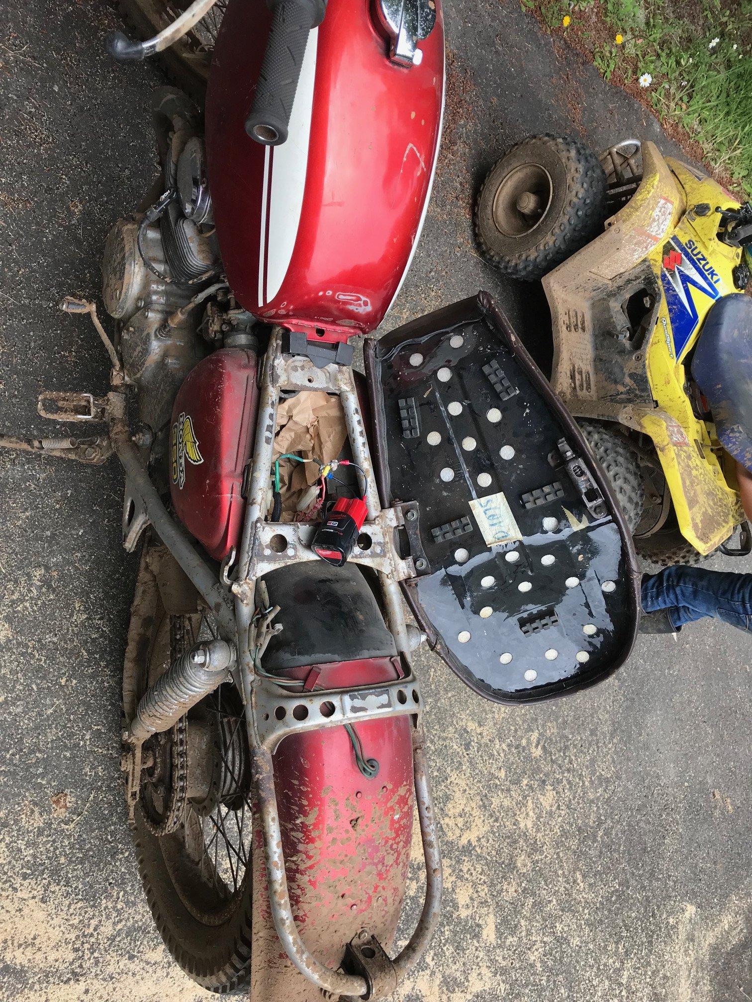

IMG_2448.jpg IMG_2449.jpg (check out the SWEET 12v last-minute battery hackjob on the classic Honda.)

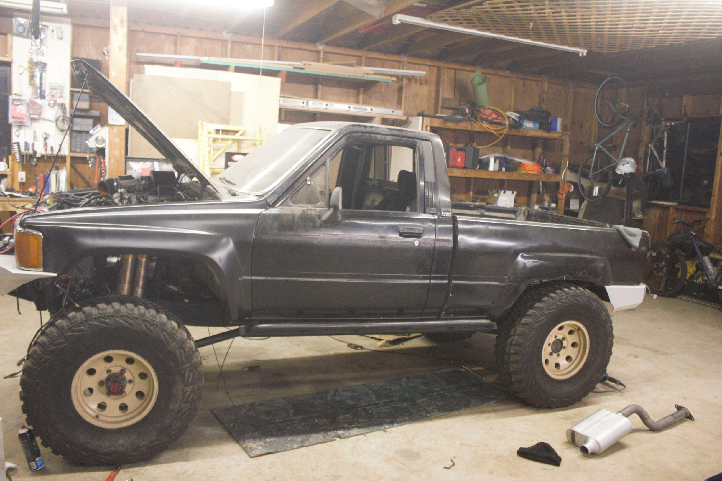

whats she looks like when im checking clearance at the steering and exhaust. Kinda funny looking.
I am happy that I dont have to trim the sides of the bed at all to make the tire stuff. I was worried about that.

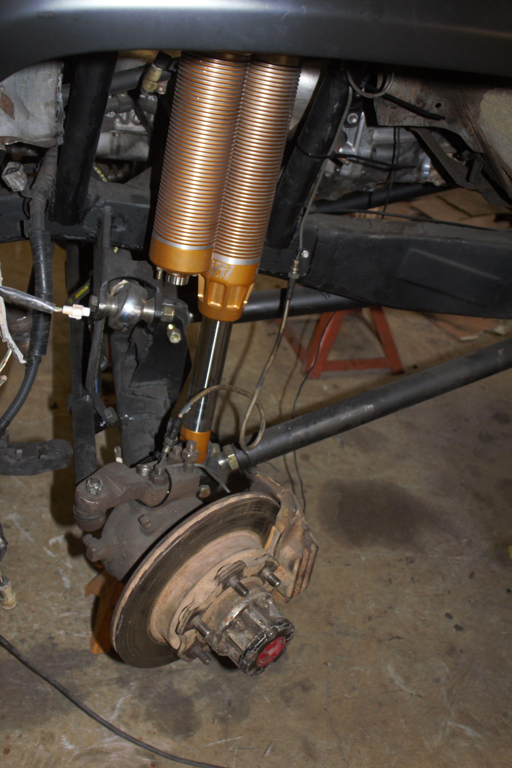

I went coilovers, air bumps and sway bars and setup and packaging has been a pain. Still not done. Only reason I backed Out on struts is because I do a lot of overlanding and I was worried about blowing a strut seal on a trip. Not sure if it was a valid concern tho.

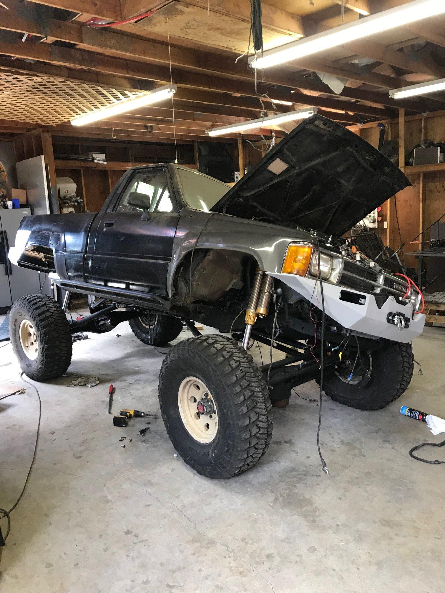

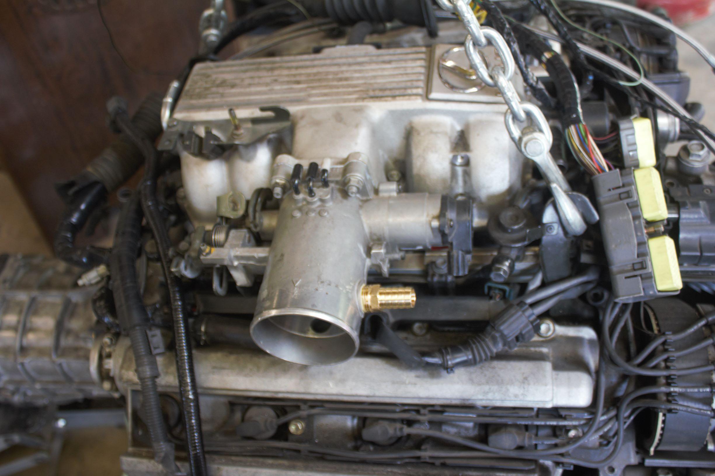

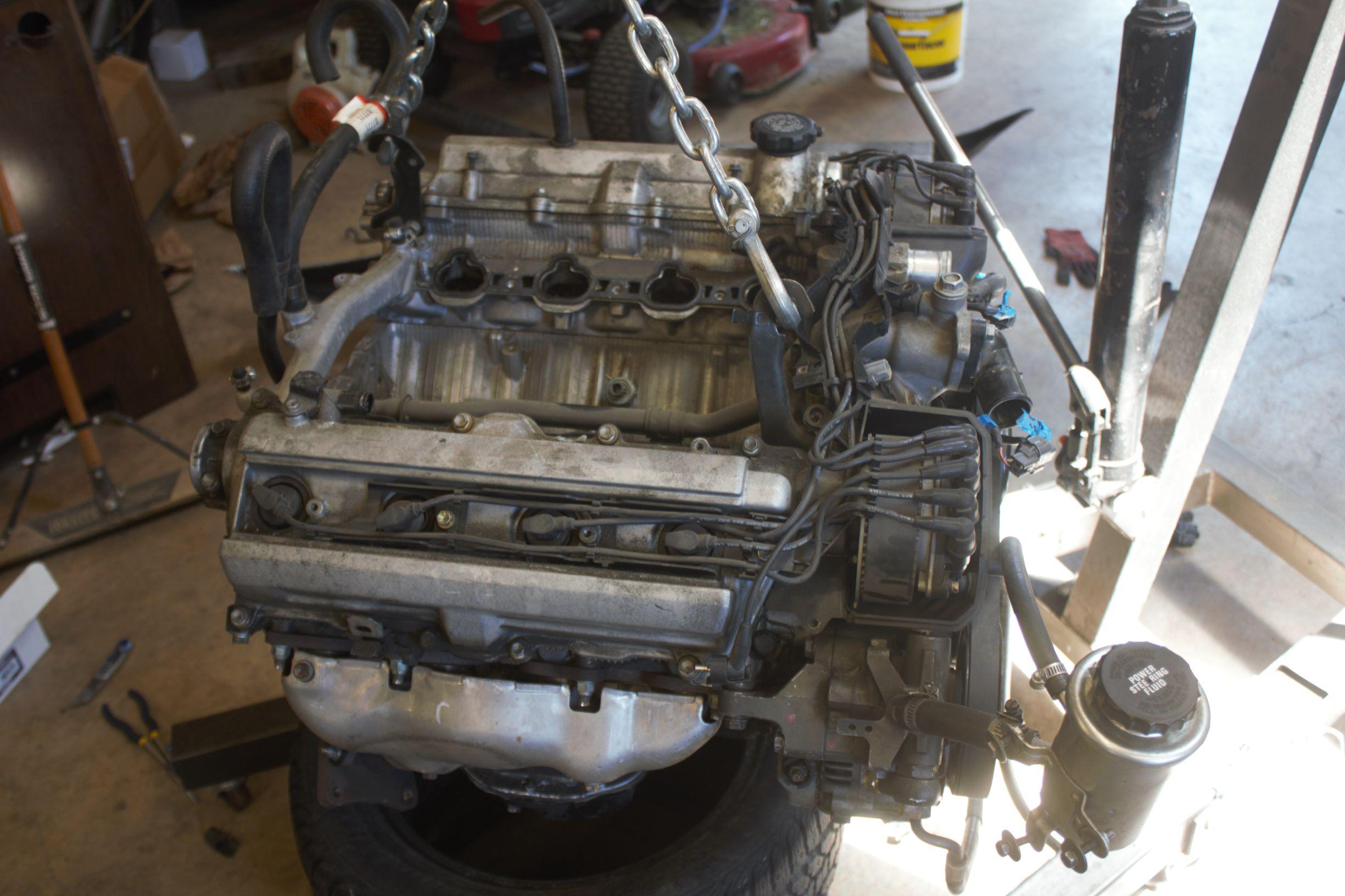

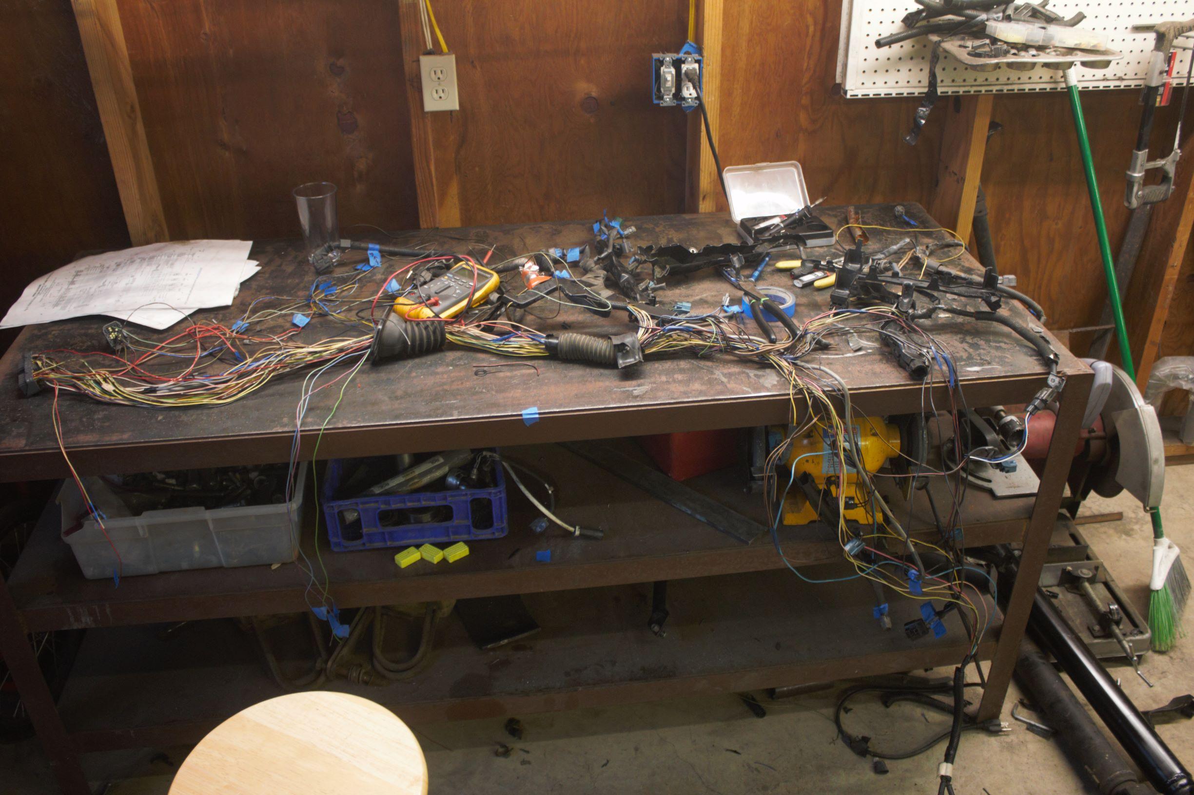

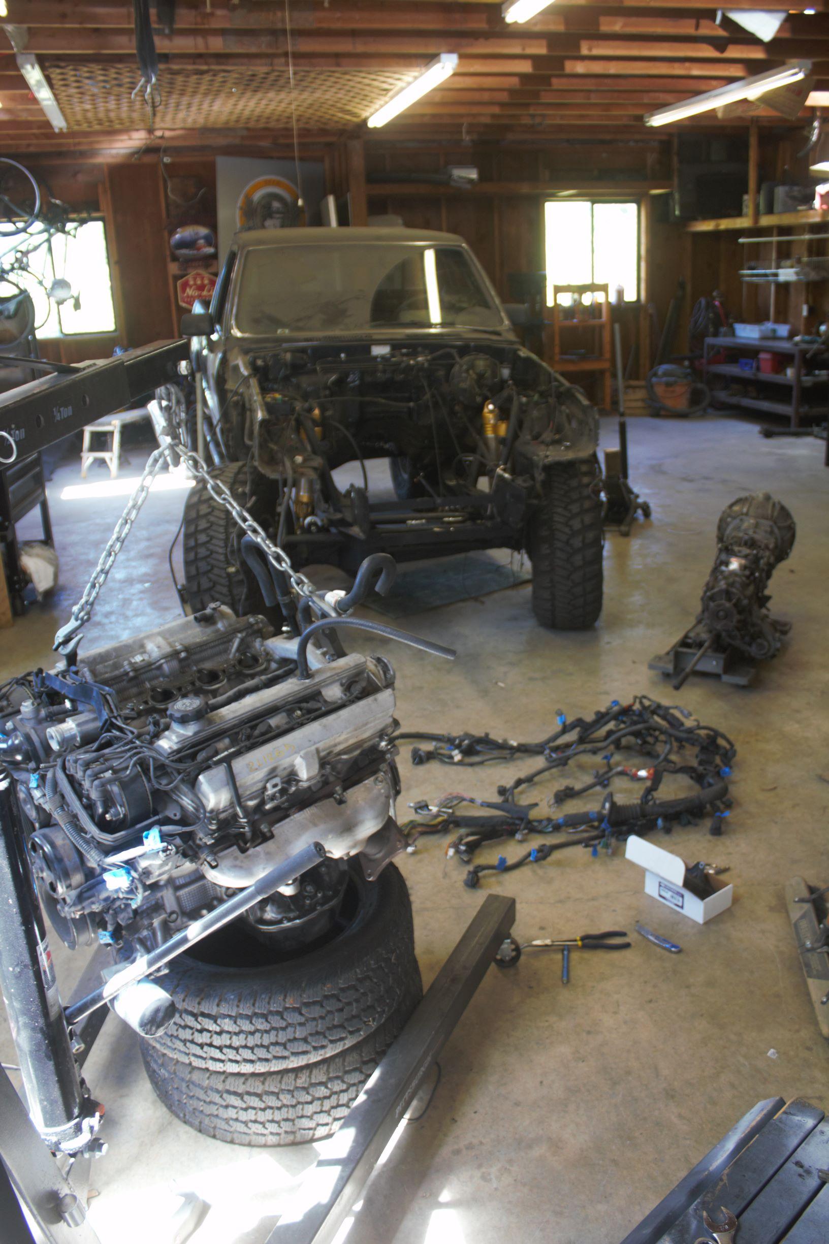

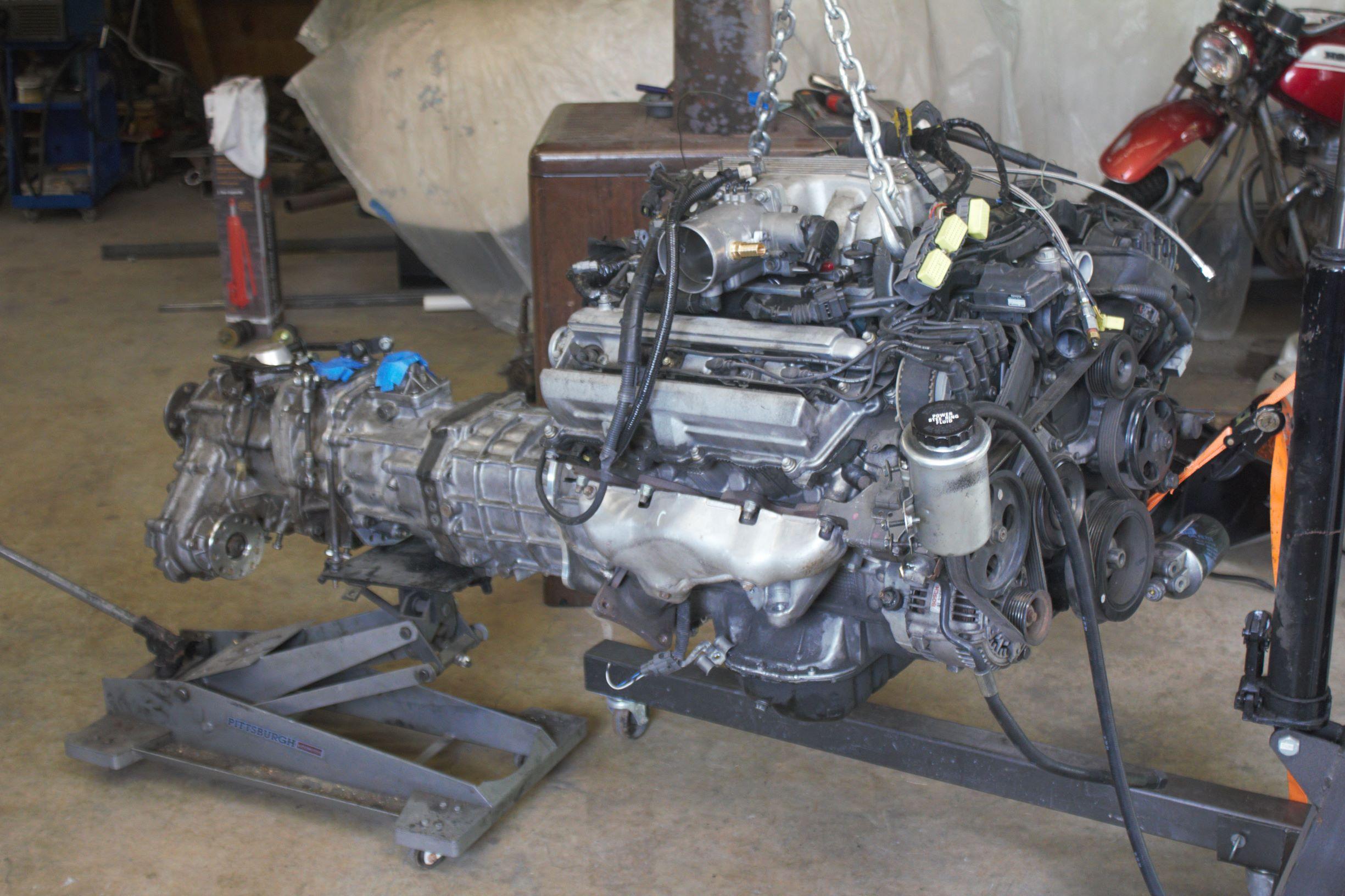

Because the motor and trans is out to replace the clutch lines, and July 4 wheeling is off, I guess I can do the wiring the "right" way. I'll thank myself later for de-pinning and removing all of the unnecessary wires from the loom. It necessitated removing the intake manifold to get to the knock sensors and the starter section of the wiring harness.
IMG_7357.jpg In case you're thinking of doing a 1UZ swap, and dont know anything about them; the starter is UNDERNEATH the intake manifold. Since its out, and since its a rebuilt NAPA starter from who knows when, Im putting a Denso starter in there. I really didnt want to spend the money for this....but I can see me losing my sh*t on the trail if my starter were to go out.

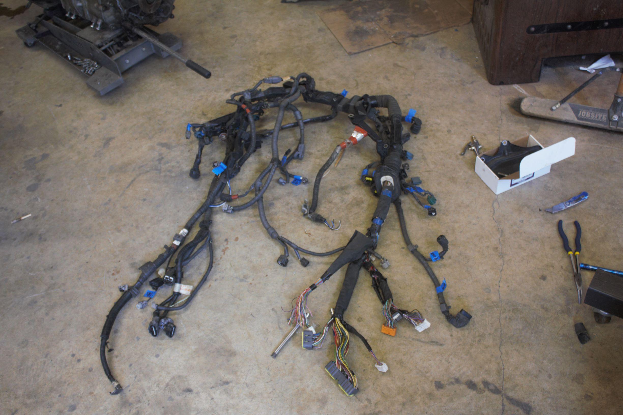

IMG_7356.jpghere is the harness freshly pulled. I tagged the sensors I will need and can gut the rest.
IMG_7360.jpg Crappy picture of mostly gutted harness.

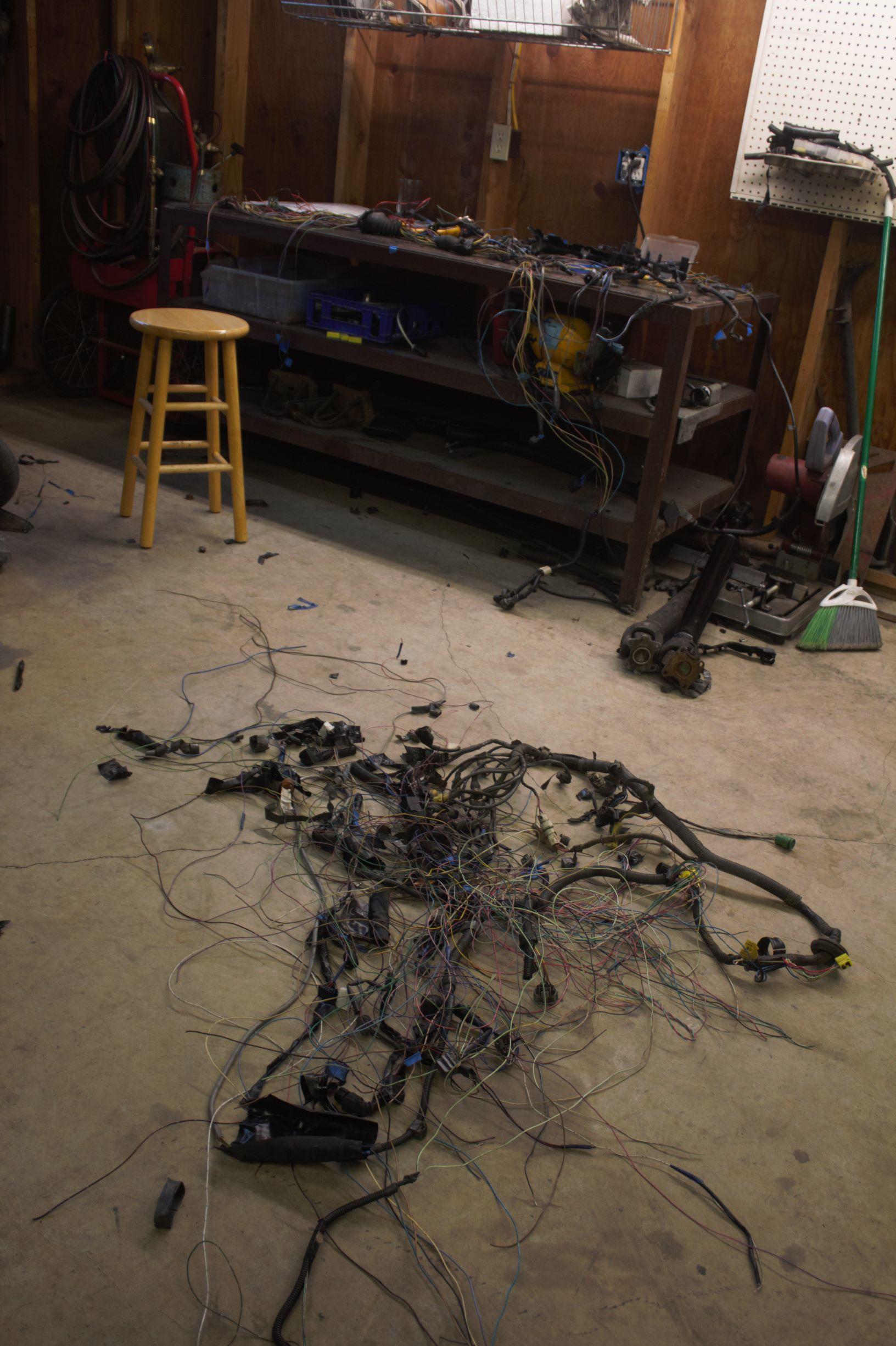

IMG_7361.jpgPile of wires that were removed. Mostly TRAC ECU, auto trans crap, the extra tps, etc...

got the wiring harness all trimmed up, soldered, heat shrunk and taped up where it belongs. used the body plugs off of the 22ret harness and ran all the necessities through those. Ended up using the COR as the fuel pump relay, just jumped the 22re AFM wires so the relay gets power whenever the key is on. Not ideal, but it runs the fuel pump.

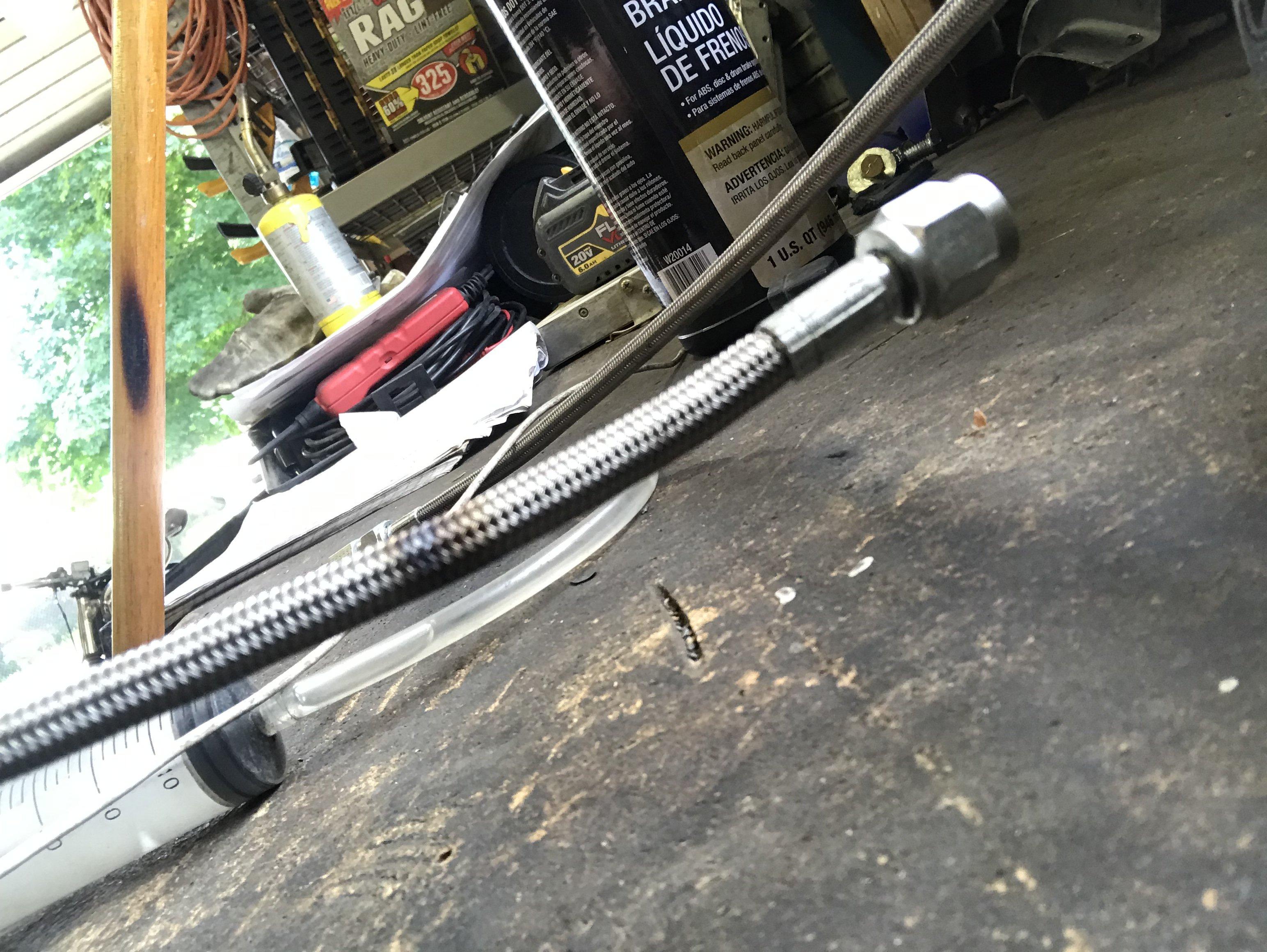

The rubber hydraulic hoses for the clutch, it turns out, are a NO-GO. There is too much volume and/or they flex too much under pressure.. only after i drilled the bellhousing holes out bigger to accommodate the bigger lines, i found this out. So I went to Industrial Hydraulics and had them make me a new braided line. I electrical taped the crap out of them so they wont arc in the same spot. Then welded the holes shut, and redrilled them smaller, again.
also removed the 2nd TPS from the throttle body, along with the cruise control motor. replaced the TPS with a brass barb fitting to run the IACV. Looks cleaner now.

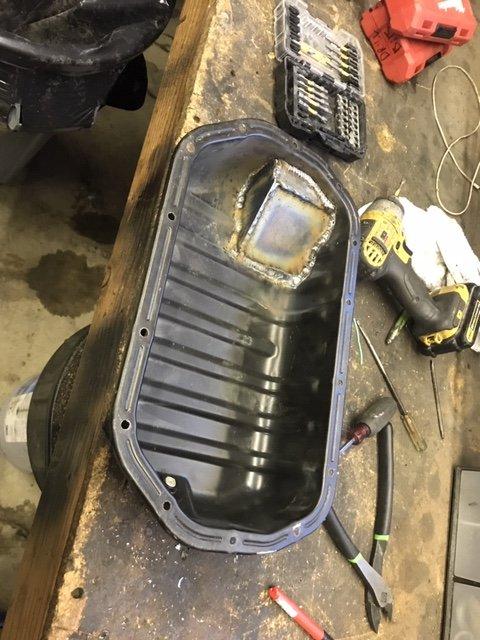

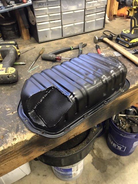

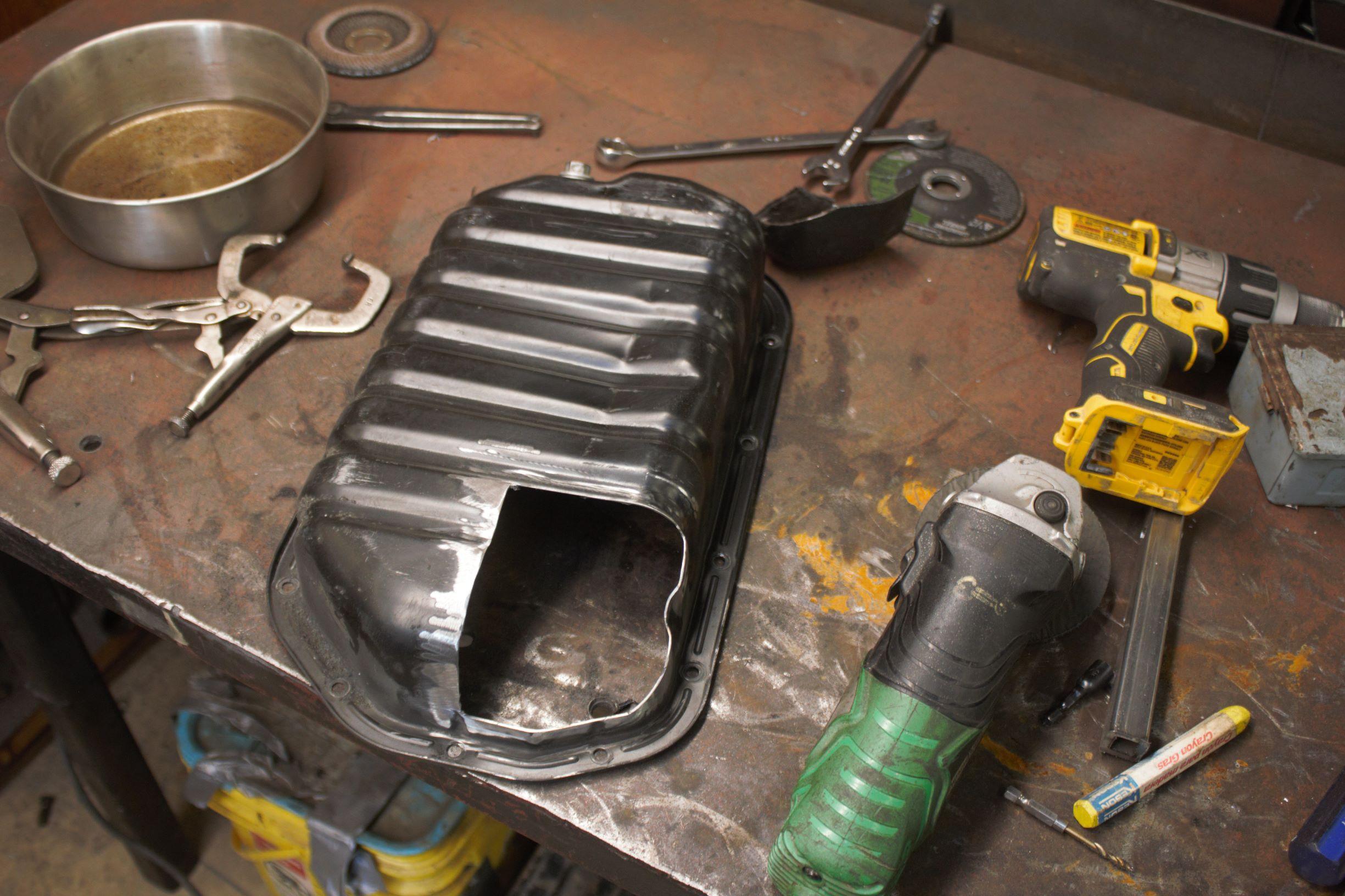

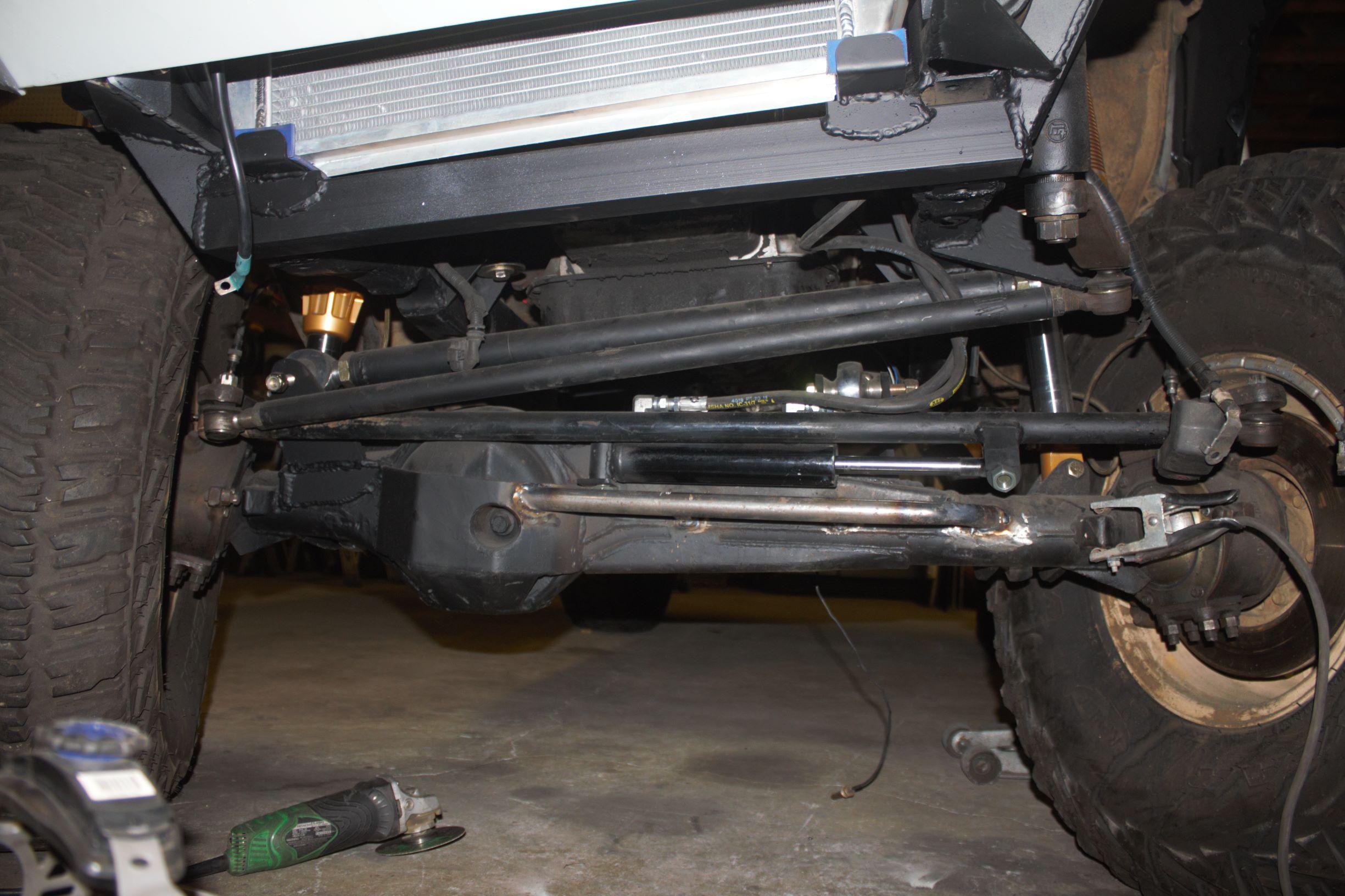

aaand, hopefully this will be the last stupid problem for a while. I had to move my axle back about an inch because apparently I dont know how to use a tape measure. My steering box is too close, and the pitman arm hits the tie rod. But, now my upper link mount hits the oil pan at full bump. Hence:
Pulled the pan today, the pickup is in the center, so there is plenty of room to clearance it for the link mount. Please be the last hiccup. I want to hear this thing run. I'll update once it gets a runnin'.

so obviously i got the pan patched back up and in.

now to just put it all back together, wire the winch in, shorten a driveline, make seat brackets, and then go jump it.
got her mostly back together now, its drivable, but needs shock tuning real badly. I just pieced together a dual fill kit off of amazon that should be here on Monday.
its making a clicking sound in reverse, sounds like crap. I think it might be the reverse idler rubbing up against whatever gear its next to. Ideas anyone?
the thing has so much power compared to the 22re-t! Feels like its going to do a cartwheel when I hammer down on pavement in 2nd gear. (but its largely because the shocks are WAYYY too soft currently...)
here's putting around the yard with my boy on the first go round, nothing special
