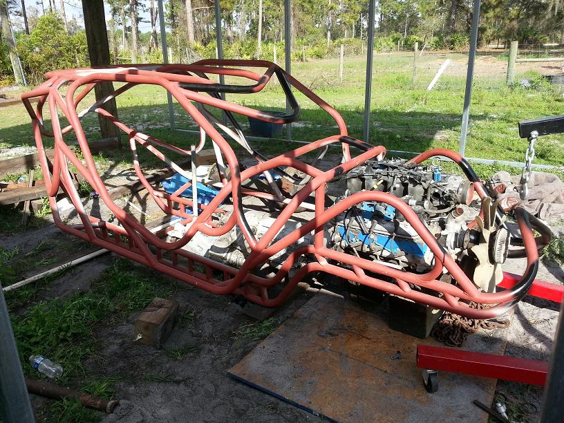

I want to keep it as low as possible. The axle has already been narrowed, I got It for pretty cheap because it has no axle shafts and I was going to go with Ouversons. I plan on using a standard rear axle for now and In the future upgrade to rear steer. Here is a picure of my buggy.
As high as your frame rails are you should be able to keep your rig pretty low. overson short shafts are a little cheaper than long ones. Find some one that can do a two piece driveshaft and run a tie rod ad a good 10 in single ended ram and you'll be ok. I've had every kind of ram only front and have bent, broke, busted. And split all of them. I'm running a psc nw and even pulled the bolt holes out of the brackets. My rigs heave Andrade on steering parts . By the way, you got a great looking start, buggy looks really good.
if you are going to run std rear, you will need to run the rear hubs in and the front hubs out. That will put the front 3" wider then the rear. Otherwise you can shorten the stock rear, go rear steer, or run a std front.
