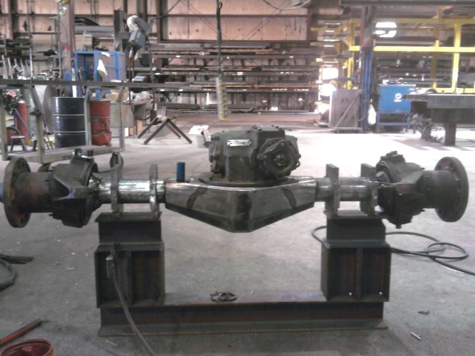

True enough there are other drawbacks than just the weight factor, We were willing to build around them for the sake of strenght. the axle pictured below (including pinion brake and tierod with STOCK shafts) is 69# heavier than a Chevy take-out steer Dana 60. The hubs have not been lightened at all yet. That would be good for approx. 8# a piece.
All in All, I'll take the drawbacks and hopefully RIDE ALL WEEKEND and not be BROKEN.... I think it actually boils down to what you want to run, although the TOP DOG at the end of the day ( fastest man ) will likely be running a Hybrid axle... I'm ok with that :dblthumb:
What size tubing did you use on this?
the tubes are 4in 3/8 wall. the top platte, center, and bottom part of the houseing are also 3/8. the upper part is1/4.
