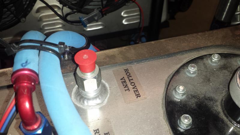

What are you guys doing plumbing wise for the roll over valves?

Loop in the vent line then run down below the tank like in this picture. I assume it already has a check valve on the vent?
They are inline so they slide in the 3/8 hose and I clamp them. If I remember correctly, they have different versions for -6 through -10. I have hose loops and those on anything carrying fluid. If it were me I'd order one to make sure you'll like it, before you order an entire cars worth.
Mike I have that same cell I think. I looped and ran a long discharge line for added length.
That is also the vent if I recall, so I put a small crankcase type filter on the end of the loop line.
I'll take a pic tonight.
I had forgotten I have used that type of cell before in a jeep and thats exactly how I did that one except this time I too will add a small filter at the end. :awesomework:
