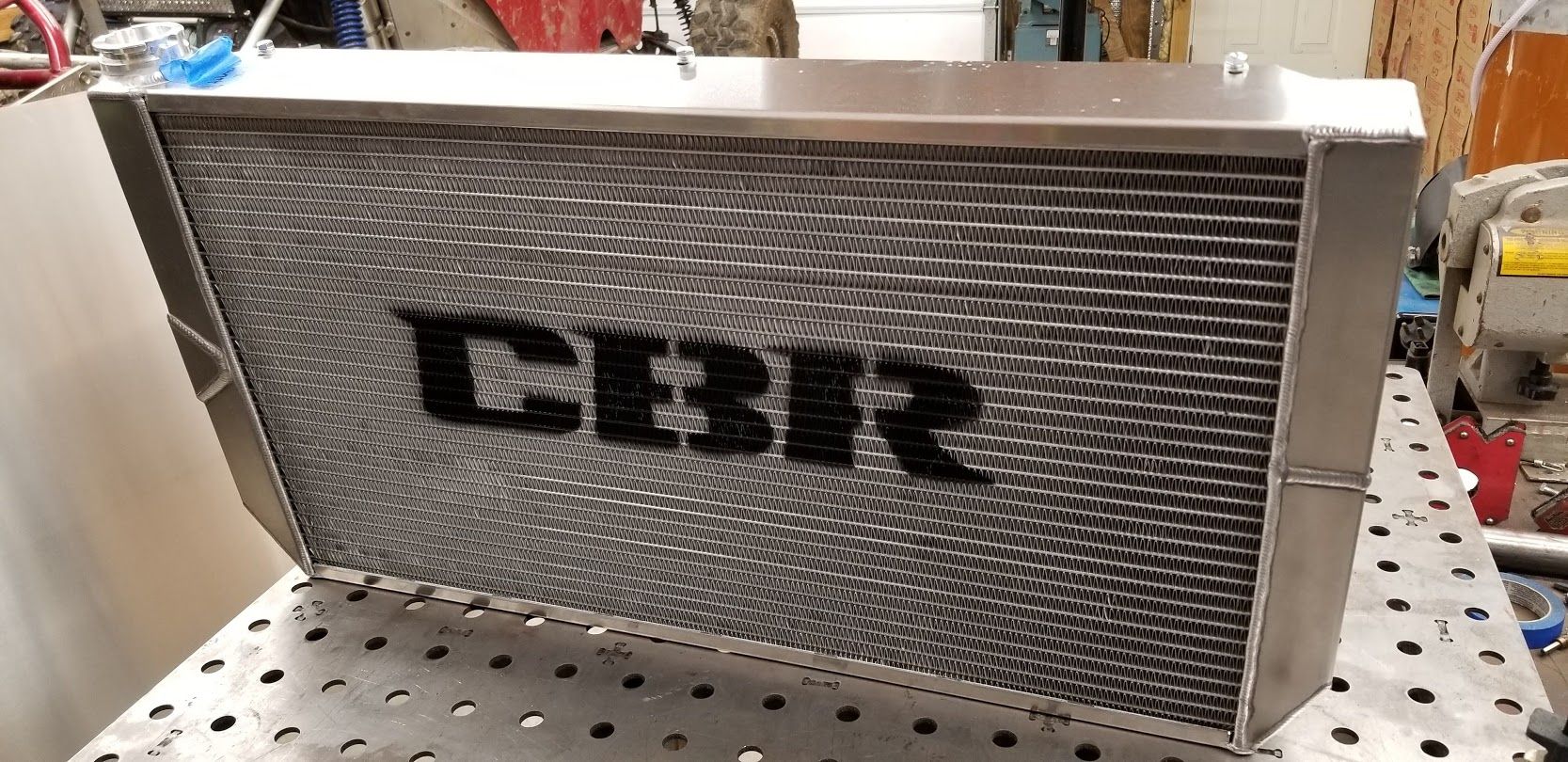

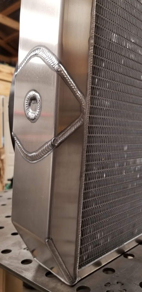

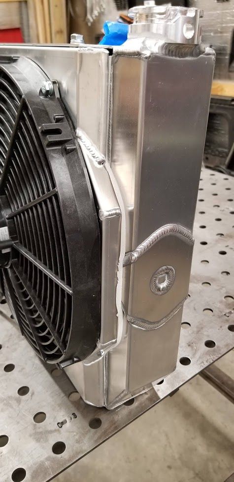

Boom. Custom build from CBR. This thing is a work of art and puts a Griffin to shame frankly. Only cost me $250 over the Griffin and that was with the AN fittings and custom tweaks I made. I was probably on the phone with CBR 4 times or so, there were very responsive and their answer to everything I asked for was "no problem." This is now the second custom piece I've ordered from them, first was a new massive fluid cooler. Both times they've knocked it out of the park on product and service. My temp gauges are going to be purely for looks from now on :****:

What size ?
Price is really not that bad for what it is.
Did you add the PWR core option ?
Waffle said:
I'm pretty sure that all CBR stuff uses pwr cores with the R fin. The R fins leading edge is hemmed for strength and the only option I know of is 14 fpi vs 18 fpi, 2 rows of 1" vs various widths of extruded tube. Great looking rad btw! 31x16 with 14" fans?
Just for reference..... I recently got a quote from Ron Davis for a 26x19 stock car rad for $310. Not bad considering its the base rad for the shrouded offroad version, 18 fpi and has a 22" wide core for more cooling surface area vs some other brands. They also quoted me $135 for a custom blank shroud to fit a Volvo fan. Looks like a Northern Hurricane blank fan shroud #Z40022 will fit as well.
Yep, it is their CBR1002 (https://www.cbr-performance.com/off-road/). 31x16 with 14" fans, 3440 CFM.
