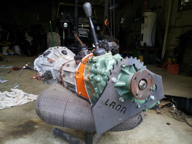

Just like the title says ditching the 1.6 8v for a 16v 2.4 2rz out of a 2wd tacoma mated to a w59 4wd tacoma trans and a af1a geardrive case with 4.7to1s pics to follow
BNBOFFROAD said:Yea the reason im doing the 2rz vs the 3rz is it's more rev happy and I might put a supercharger on it
midnight_f150 said:
I thought they was close to the same just that the 3rz was bigger.
al1tonyota said:Are you going to just hook the rear end to the tcase? Lol Jk it is a lot longer setup! I had a similar setup but a 3rz I can't see a 2rz having more power but makes sense about less moving parts!
