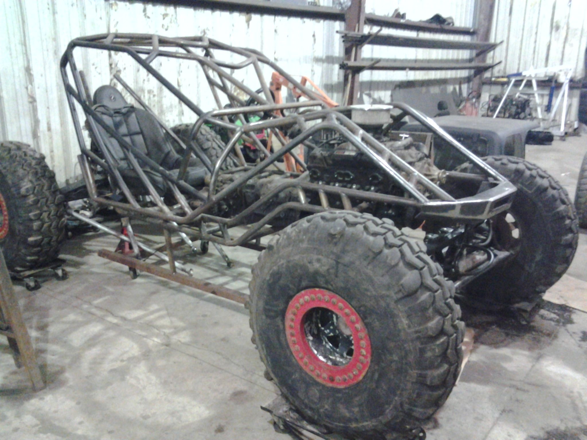

got the rear coilovers mounted, shock brackets tacked up in case we have to move them.
well we are going to move on to the front end and start the 3 link setup, dont think we can 4 link the front.
here is the back about finished, just have to tune the coilovers in the rear, do the brakes.

Hey jamie i'm in the process of turning my sami from a radious arm set-up into a true three link front and stretching it out. Also changing from coil springs to coilovers and i was just wondering what rate springs you are running and what length springs. I'm going to be running 14" coilovers
thanks jd we trying, come on up anytime.
the rear coilovers now are 100 lb on bottoms and 150 lbs up top, but i think
the 150s are going to change to lighter maybe 120 is what i am thinking
we are going to get the weight of the rig sprung and un sprung and weigh
each corner to see what we need. these are 14" coilovers in the rear and the front.

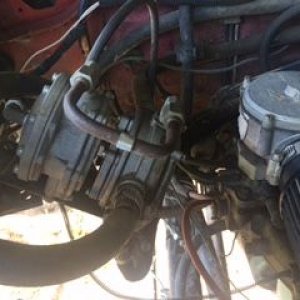

fire x mount, high lift mount and battery box and propane mixer mounted.

see about getting that done. i have not run a regulator on its side but i have seen alot of pictures were guys do turn them like that
i may call kerry at gotpropane and ask him about it. i think it will be ok.

Did you get a chance to run this rig yet. I'm still curious how the propane setup on the firewall worked out. Started my ftoy project,and thinking of doing the same setup
been down in my back so I havnt worked on it much at all, according to smurfy90 he says he has ran his
on its side with no problems. I have seen several mounted like this.
