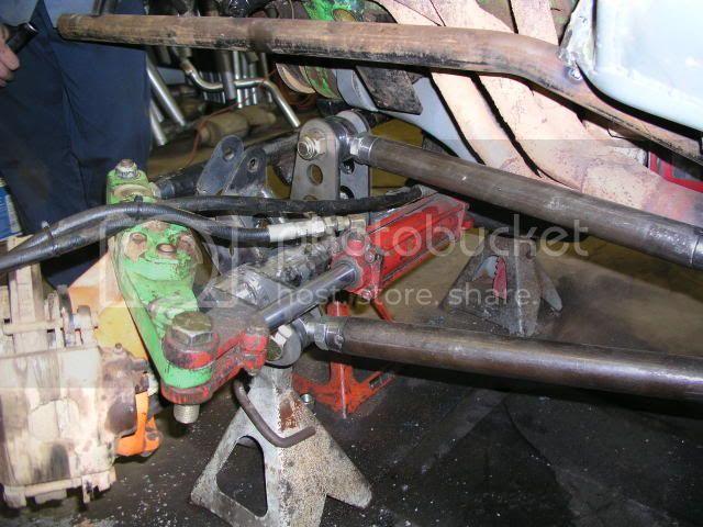

okay everyone has there setup so here is mine... i run a SE ram, cheap bailey ram, but i run it behind the axle, onto a double ended BTF high steer arm... the clevis style ends actually goes around the arm so it keeps for tight packaging... yes matt o. those are more 1" bolts... please contain your exitement... :D

I really like the idea of putting it behind the axle. I have been thinking about that alot with a SE Ram.The BTF arm is perfect for that.

I am a fan of the SE ram for packaging. I like that it is up and out of the way or behind the axle.
