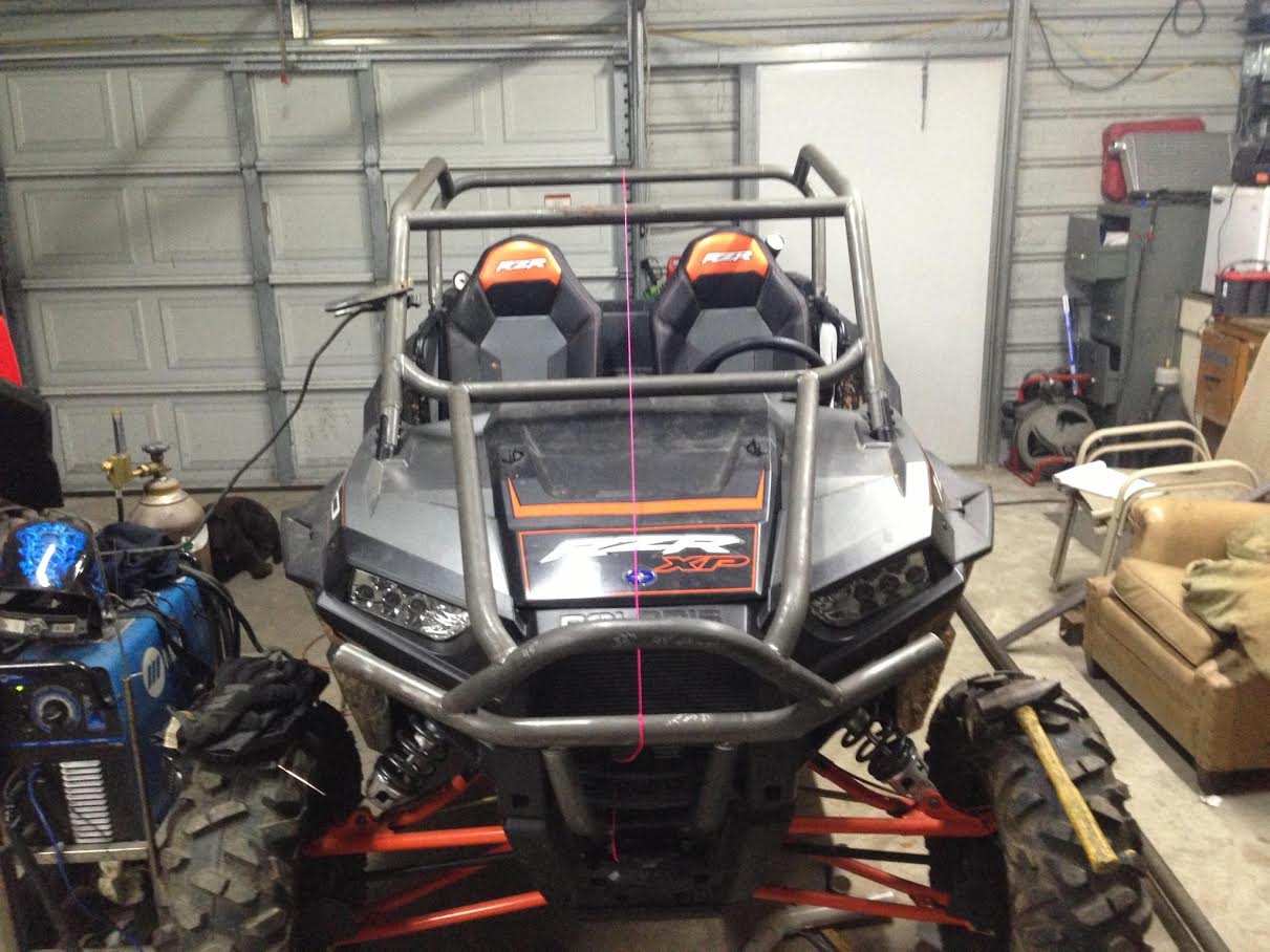

Skinny Pedal Fab new XP1000 design. Bumpers will mount up in factory accessories points. more pics to follow.

Do you guys ride rocks? have you looked at the front differential attachment bolts and their vulnerability? I put a bumper plate on there without a bumper built yet the day I got mine, if you smoke a rock that tin can of a frame won't keep that bolt from being pushed over/broken out etc. Pretty open. Only reason I ask it it makes a nice place to put a front bumper lower attachment point and protect a diff.
This is not one of our normal cage's. these are for a local dealer who has to be able to sell them bolt on to factory bumper spot ready. But with them tied into windshield bars they are pretty strong.
Right. I was saying a plate that bolts on the bottom around the diff, breaks up and hits the 2 holes on the front vertical flat area, and is braced to the frame, L&R holes up front or otherwise is bolt on. If it has to use the L&R fasteners in the stock holes, I see what you're doing.
