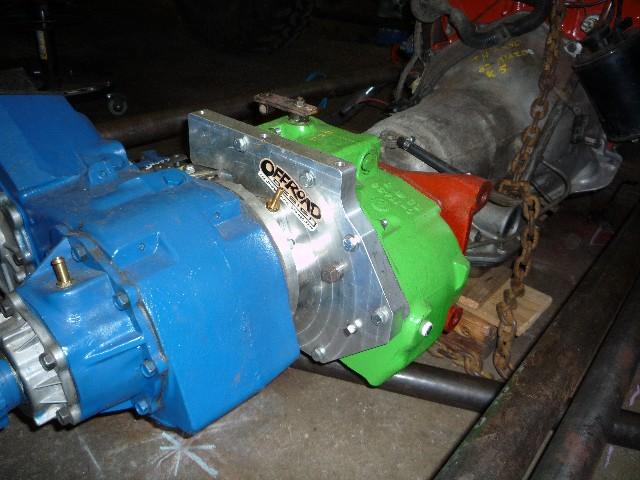

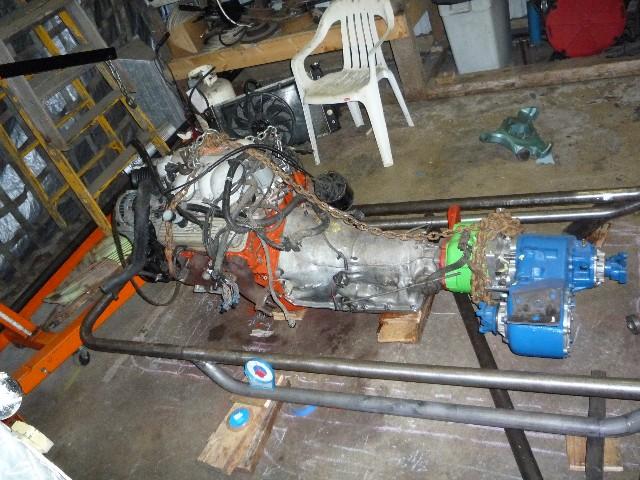

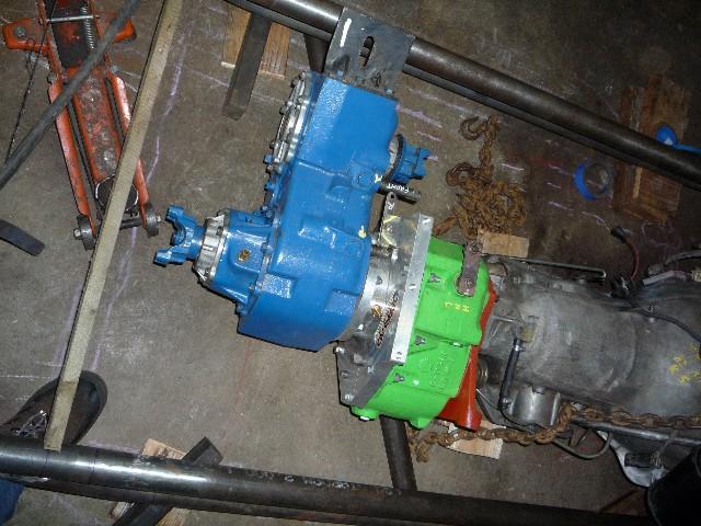

ok been a while and i have a plan pretty much formed up and part implemented.
going the 4.3 connected to a TH350 to a 203 to a 205 to a dodge sixty in front and ford sixty out back.
35 spline alloy somethings for axels.
ARB front Detroit rear
Links and coilovers
4 seats
couple of picts to show the drive train assembly.

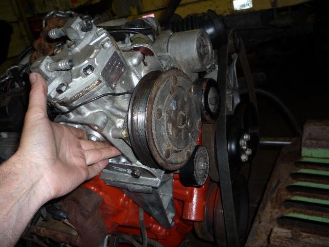

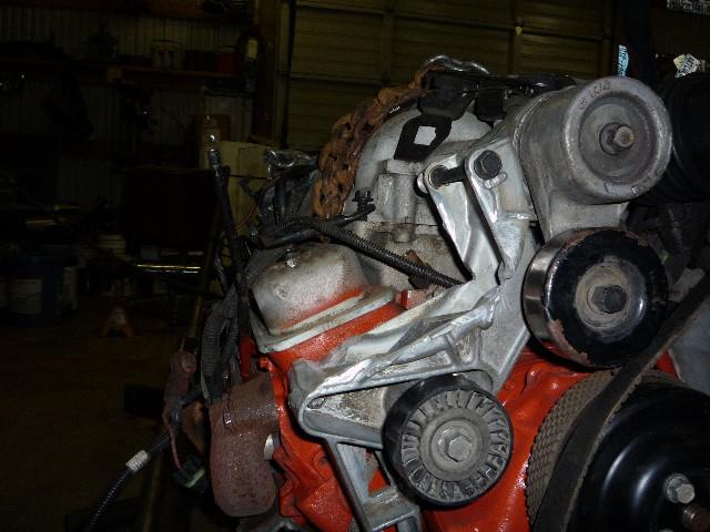

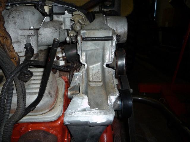

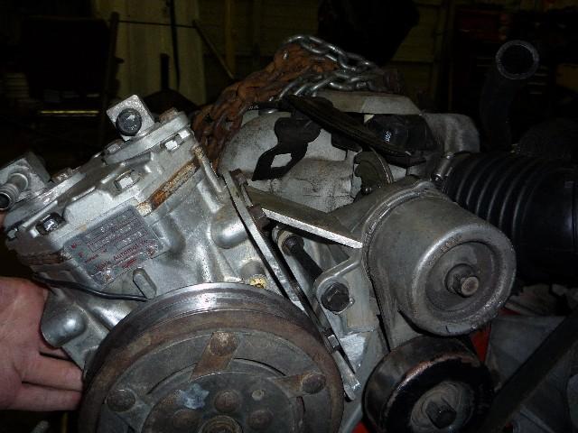

decided i wanted to mount my york in the factory location so i can use the factory belt:D

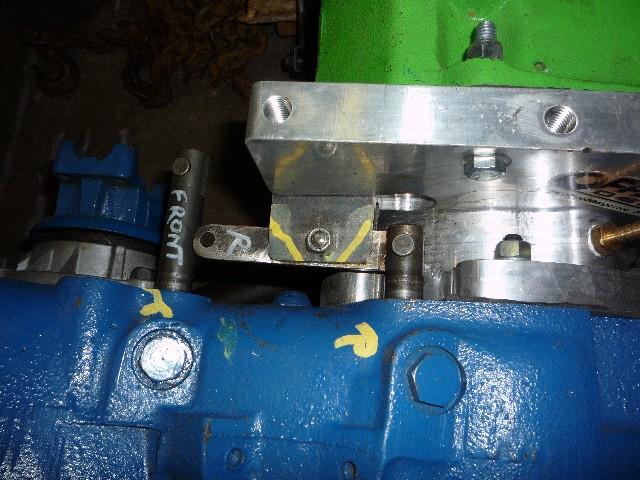

the doubler
clocked flat and made to hang from the mount.
taurus two speed was sitting on top of the engine when i opened the hood at pull a part:redneck:
