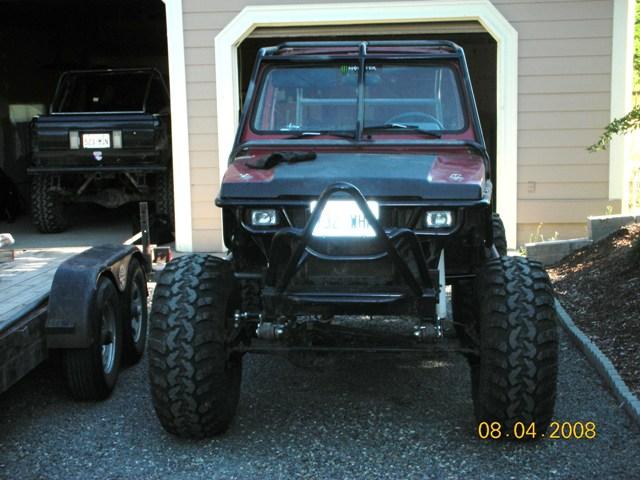

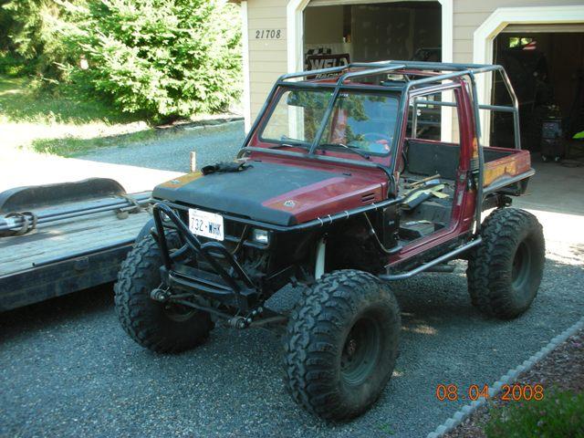

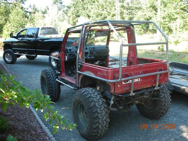

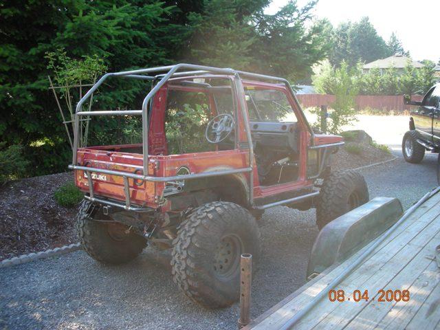

some pictures from liberty and naches

cage looks good. what are some of the shortcuts your having to fix??
There were just several little things that needed attention due to already braking/having issues or were going to be a issue in the near future. biggest being the front frame/bumper. That badlands bumper is for the 84-85 truck so someone halfass cut up the winch plate to make it fit around the 90 body(which was taking away most of the bumpers support), then i didnt like the weld quality holding the bumper to frame. Frame was cracked and so were some of the welds there. Front hanger was cracking off frame also, so put on a marlin hanger. Then things like frt shock hoops, gearbox mount, ect.

Ya the guy that bought it was jerry, a good buddy of mine. I was trying to talk him into a cage after he bought it, but he never made the move. After the roll over i got a call seeing when i had a opening for another cage biuld. Besides doing the cage and fixing some of the previous fab work, im putting on some hydro assist and a winch. It should be a pretty stout rig when it leaves my shop.
any pics of the runner finished
Runner is on hold right now, havent worked on it since the pics. Now im doing a full cage on a sami. Waiting on a Jerry (owner of 4runner) to buy a windshield up bring it up to my shop. I need to get the windshield put in it before I can finilize the front of the cage. Hopefully will have it this week and so will be working on it this weekend.
Sounds like I should have a windshield tomorrow, so hopefully will get it wraped up this weekend. Sami cage is pretty much finished though. Just gotta add a few little things, and biult the seat brackets for the new seats.
