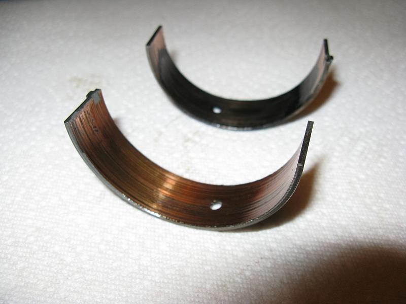

In reference to a connecting rod bearing it means the bearing is worn to the point where the bearing comes loose and spins inside the rod journal. Usually one half of the bearing will spin and overlap the other half....The crankshaft journal is toast at this point and must be machined at the very least. You aren't fixing it with the crankshaft still in the vehicle......It can also mean a bearing race is spun inside a pressed fit orifice. Usually "spun bearing" is about the rod bearing though..
How dumbed-down do you want? :D
The bearing has two halves, that fit into the connecting rod and the cap that bolts onto the end of the rod. If the bearing "spins", something isn't working right.
Quick GIS - you can see the two halves of the bearing and they're not in the correct orientation.
It depends on what bearing.
With either a main or rod you need to get the crank turned.
If its a main most of the time the block is damaged and needs replaced. If its a rod then you will want the rod re sized.
