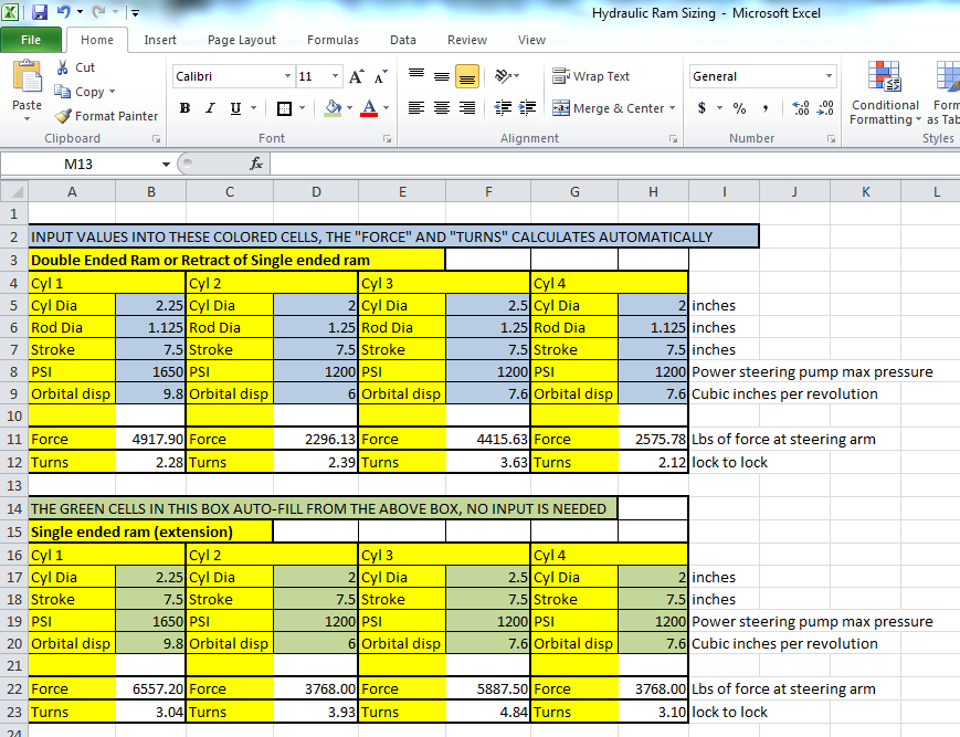

what size ram do you have?
email me and i'll send you a copy of my full hydro steering comparison spreadsheet.
